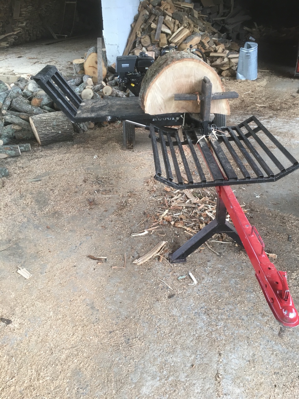

My advice is to ditch the vertical/horizontal and go with a horizontal only with a 4 way in the end of the beam. My days of sitting on a round to split wood and having to throw every piece out on the way are over. And unless you want a splitter that’s on par with a splitting maul go with a 5” bore cylinder or bump the pressure WAY up. A 3.5 cylinder at 2500 psi is practically useless for splitting wood. IMG_3949.JPG
