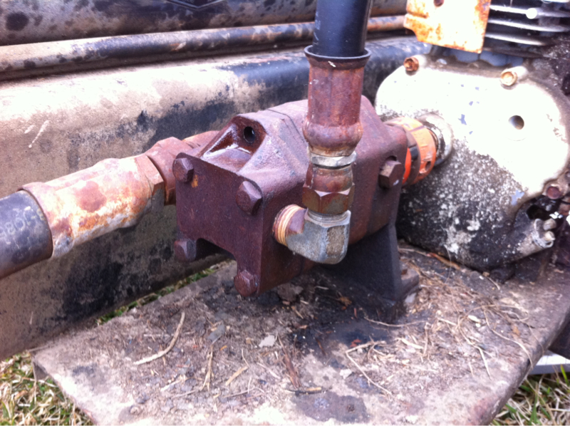

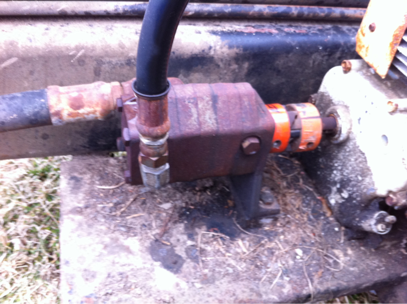

Just bought a splitter and I am curious if anyone can identify anything about the pump. I have not noticed a name or numbers on it yet. Looks to have a 4" bore cylinder and a 5hp Briggs

Looks like mine. I do not know were it came from . I used to buy stuff from Quality farm and fleet when they were around. Two stage pump been on the splitter since building it 10 -15 years ago. If it stops I will buy from surplus center.

I believe it's in excess of twenty years old so may be same as yours

Made by Delta Power Co. in Rockford, IL
There might be some numbers stamped in the end of the casting or on the front flange. Being that old it is a 50/50 chance.

Found a 011 2725 on the rear of it.

Think it is a MTE two stage 11gpm
You are correct MTE made the pump but Delta Power is the sister company that distributes them. MTE could be selling these to OEM's and some catalog houses.
