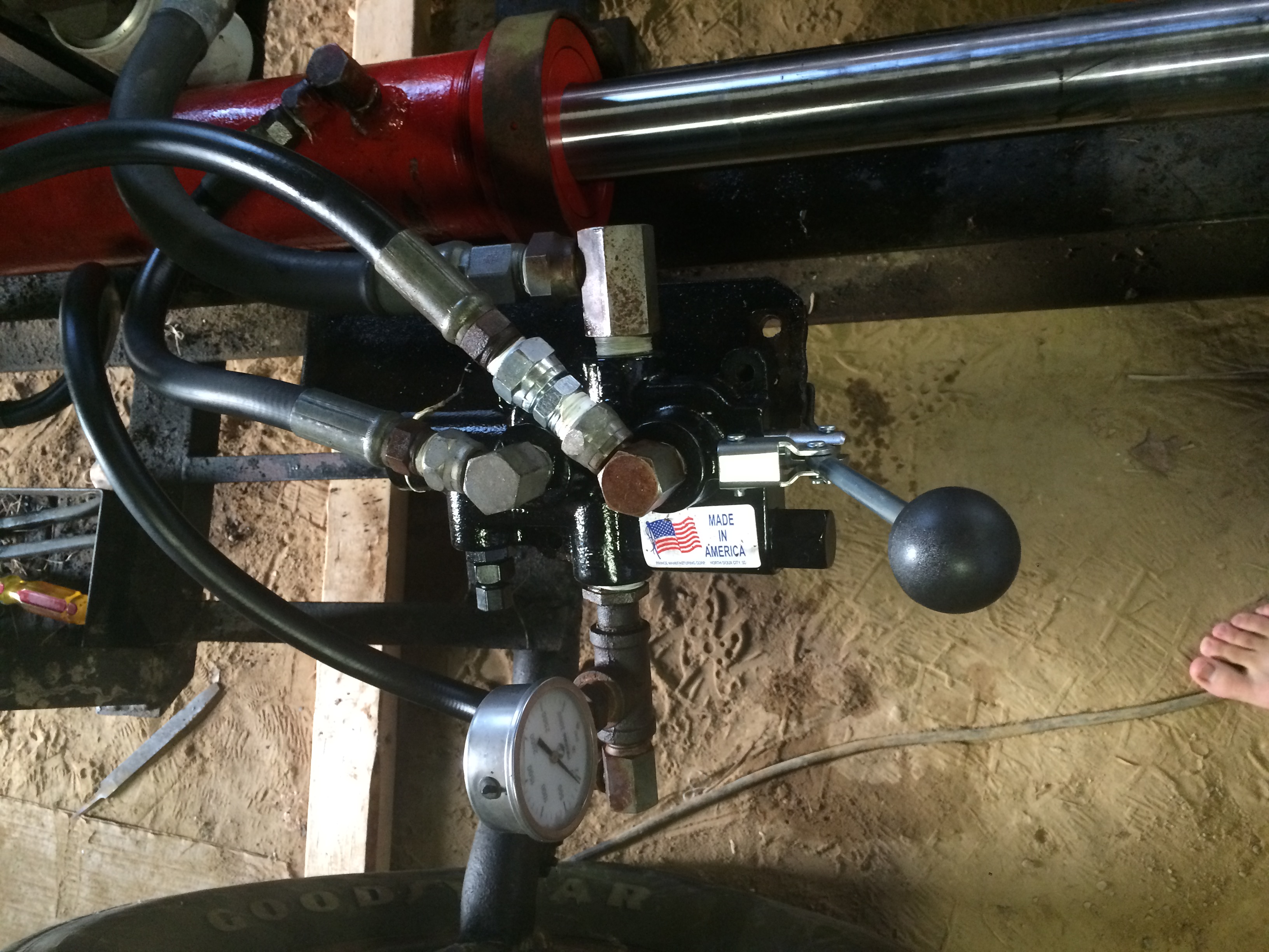

Id either take hoses off as dave mentions and put into a clean bucket and see if you get flow.
Or I'd take the valve off completely and air test it. Put shop air in the inlet. IT should blow out the outlet. Then move the lever and see if you get air out the work ports.
Valves have some small passages and tight tolerances. IT appears you used tape on all of your fittings, which is frowned upon when working on hydraulics. And no offense, but it looks like it was applied rather sloppy. IF one must use tape on hydraulics, its always cautioned to NOT tape the first two threads. While I cant see that, based to everything else I see, and some fittings with tape wrapped backwards, the presence of black pipe fittings, etc....it seems hydraulics isnt your area of expertise.
Again, no offense meant. Glad you are here seeking help and we are glad to help you get this straightened out and have a SAFE working splitter.
As of now, I'd suggest:
1. Go to a hydraulic shop and get steel fittings to replace all the black pipe fittings you have in the high pressure side.
2. Get some paste or sealant other than tape. I like loctite 545
3. Now preform the tests above on the valve. Either with a clean bucket or do an air test on that valve.
4. Report back here with the results of test 3

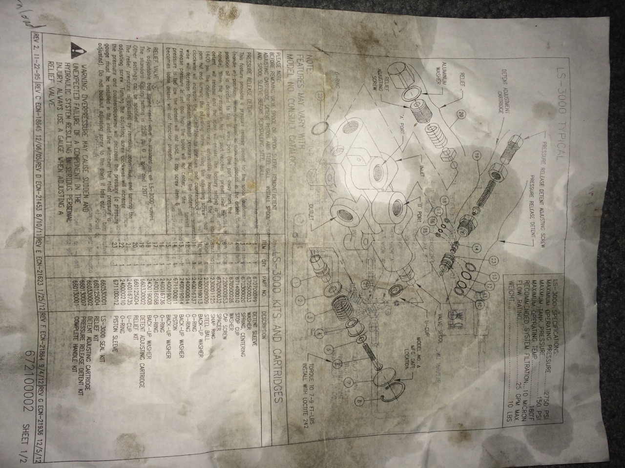

The plumbing circuit, as you have stated, is simple with no power beyond or other features which can lead to problems so although the problem is frustrating, the cause will turn out to be something simple. your photos show that you followed the schematic provided by prince. You have a mix of new and old parts now and the old parts can affect the new ones with crud.

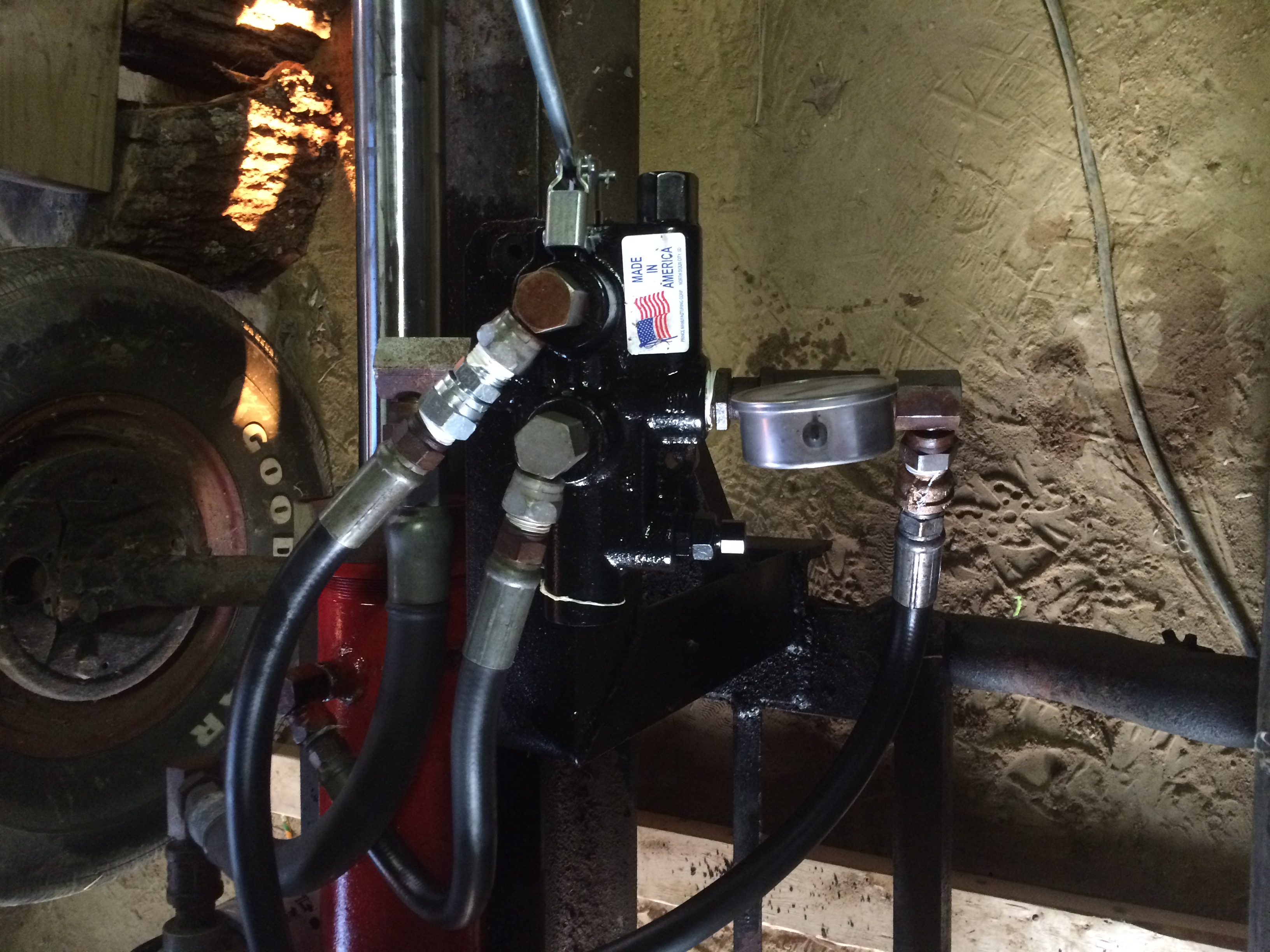

Gauge side is inlet from pump
Opposite to gauge side is the return flow back to filter then back to tank
Two Hoses on top in line with handle run to cylinder
I think everything matches the drawing
I notice an extra fitting between the elbow at the front of the valve and the hose, could it be a restricted orifice fitting, if so it would cause pressure to spike.
Also noticed Teflon tape on the female swivel fittings these fittings have a tapered seat and no sealant is to be used on the threads.
/ Log splitter Problem
#32
Bingo we have a winner.
I purchased a swivel fitting at tractor supply
1/2 npt male to 1/2 npt female
Nothing on fitting packaging says it is an orifice fitting but there is only 1/8 hole
I assumed it wasn't just made wrong but maybe it was packaged wrong
The way I first noticed was the oil in bucket looked likenchocklate milk as the high pressure spray caused foaming
The other port did not generate this color
A big thank you to that contributed to this 4 page thread
