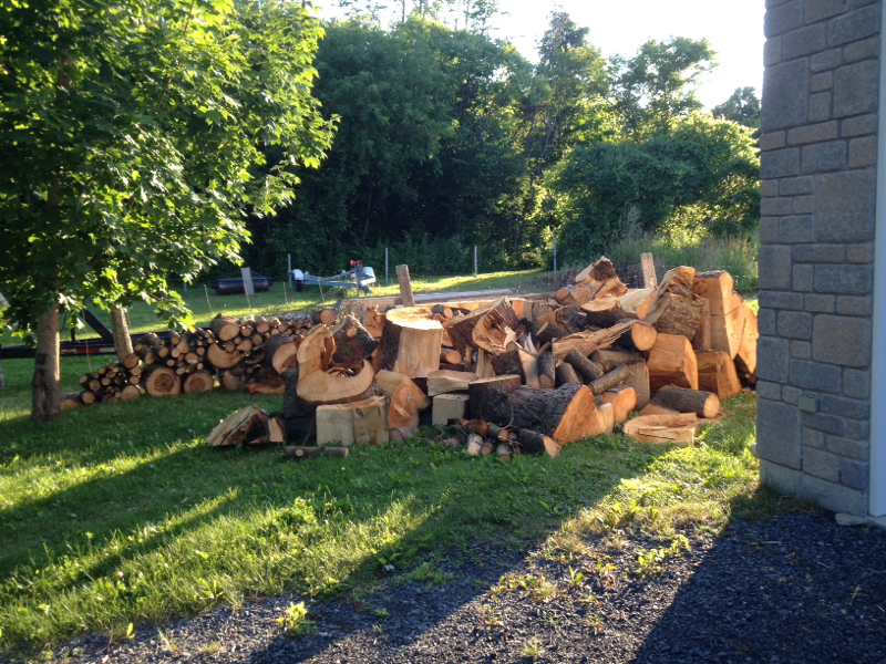

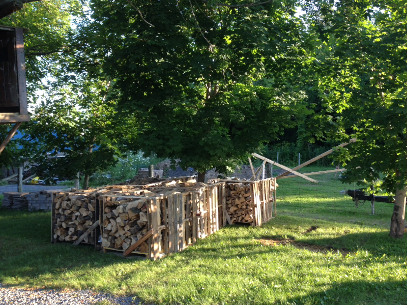

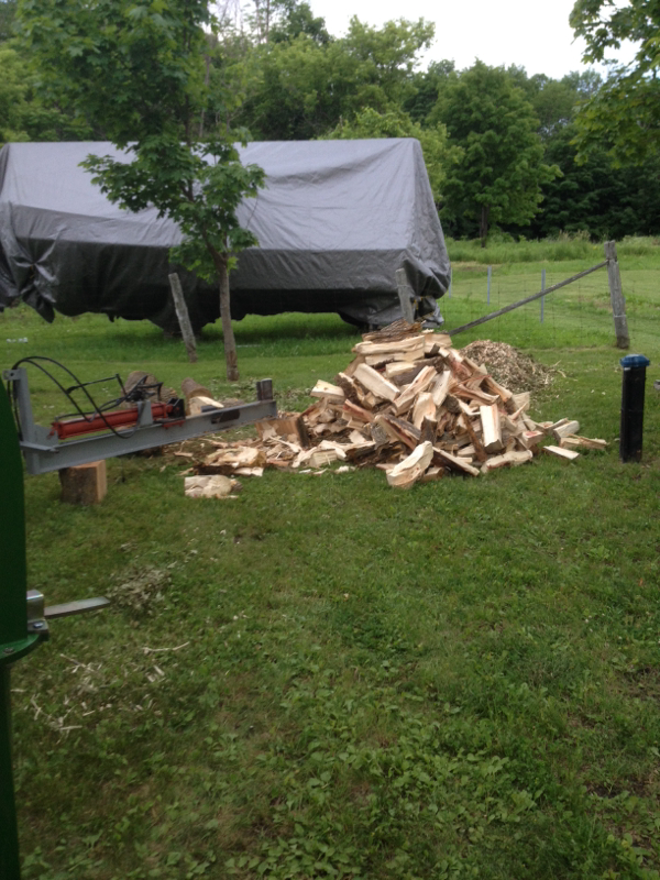

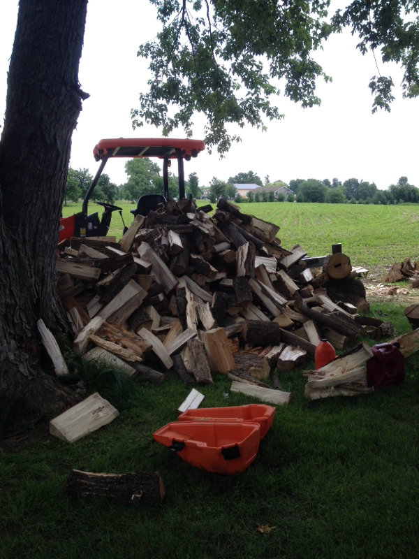

I got a bush hog splitter not fast but will split almost anything on my L45 Kubota also I never put it on my 3 point hitch I just sit it on 2 big blocks of wood back the tractor up to it and plug in my 2 lines and when I'm done I just unplug and do what ever I need to do I just like the ideal of only having one motor and not an other engine and using a big heavy duty hydro pump that's on the tractor
I dump all my wood in one location split it then disconnect my hoses and stack my wood on racks that I can move 1 face cord at a time with my forks
Dump it in a pile
Split it
Stack and place where you want it

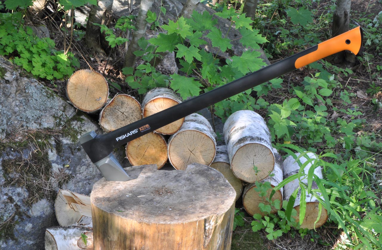

I did 11 federal cord last year with this. Not certain of it's ton rating :D
