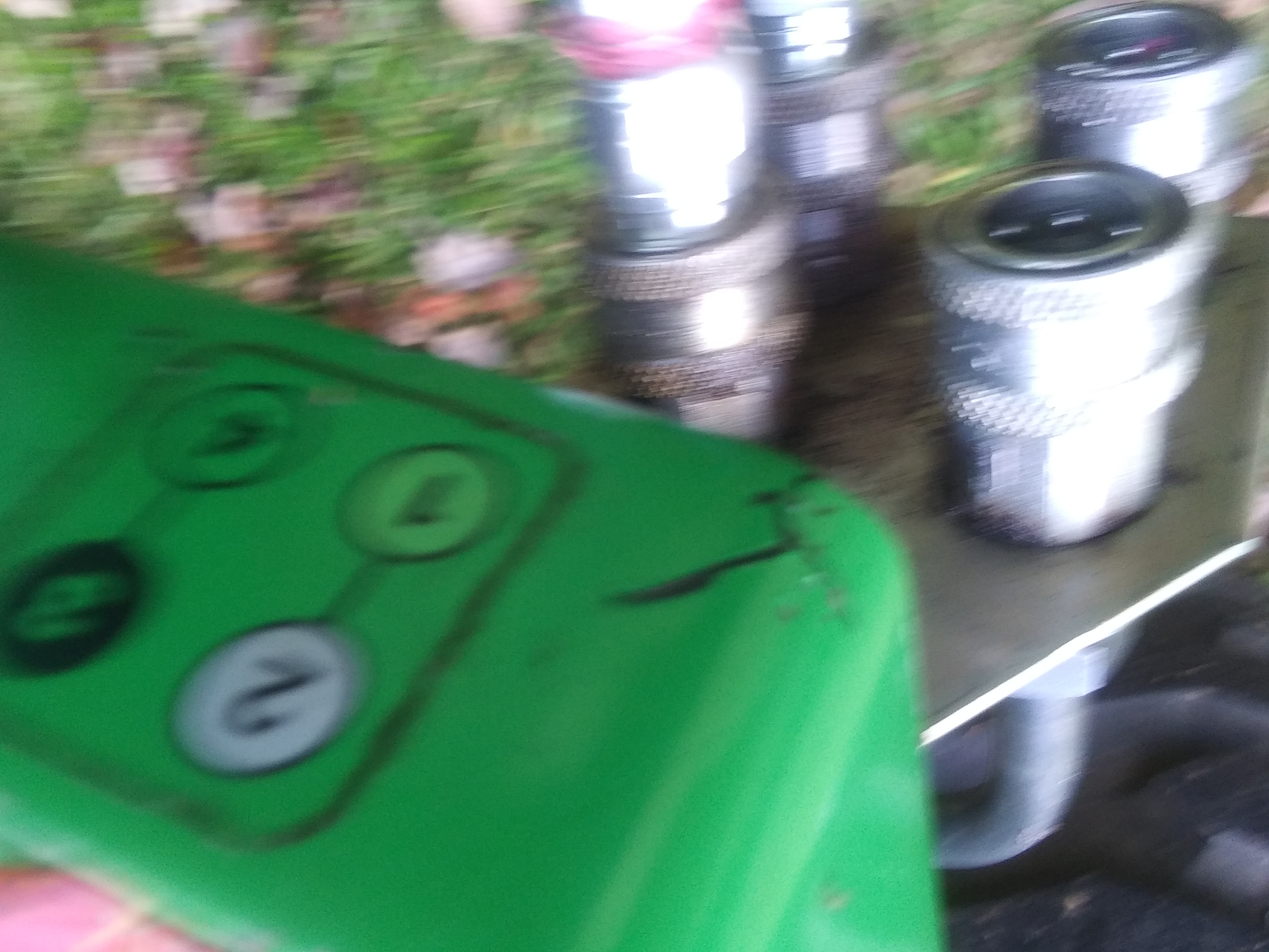

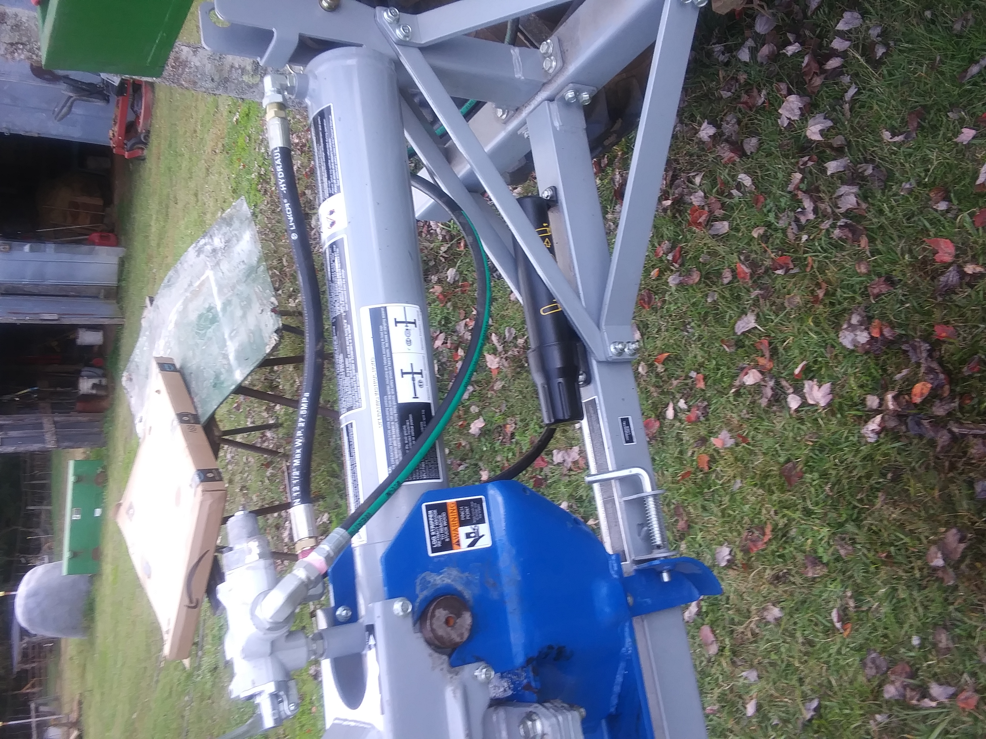

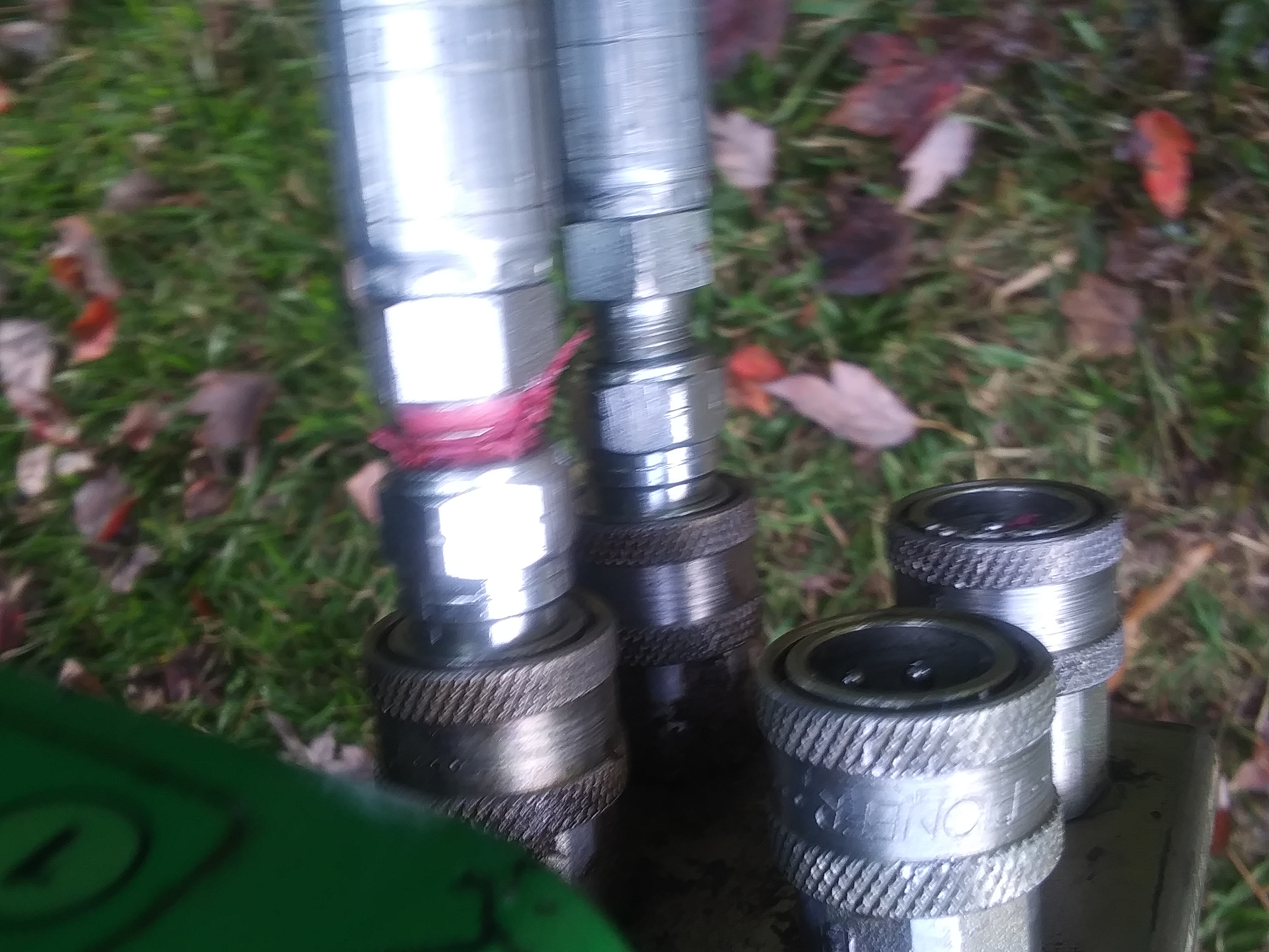

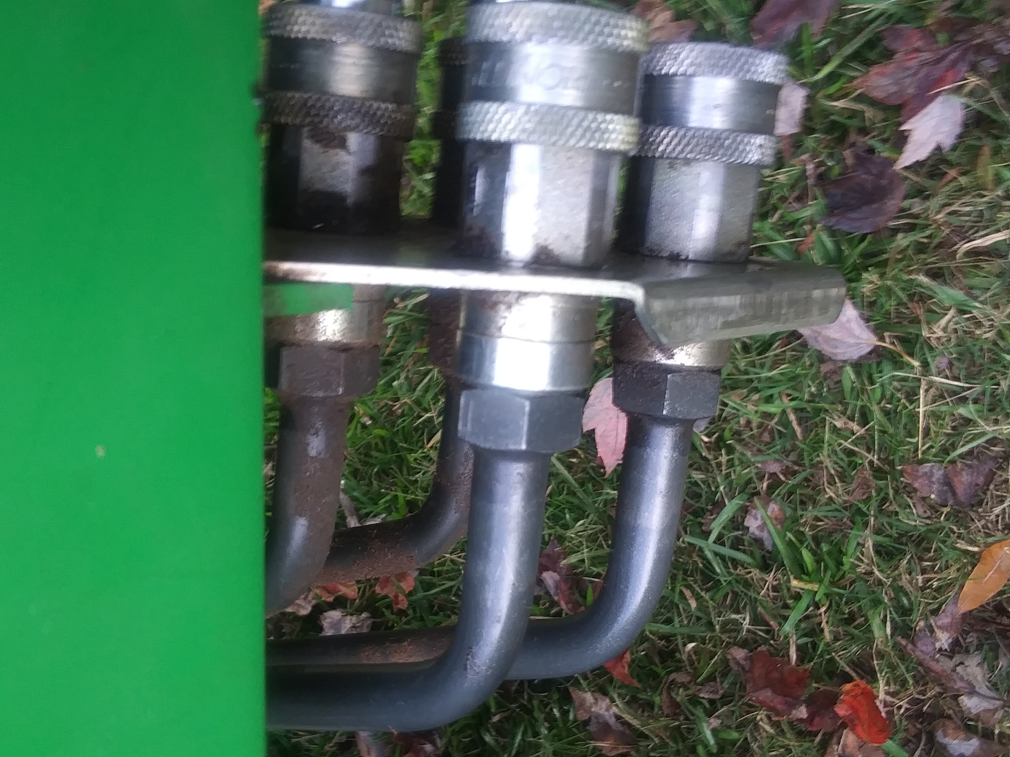

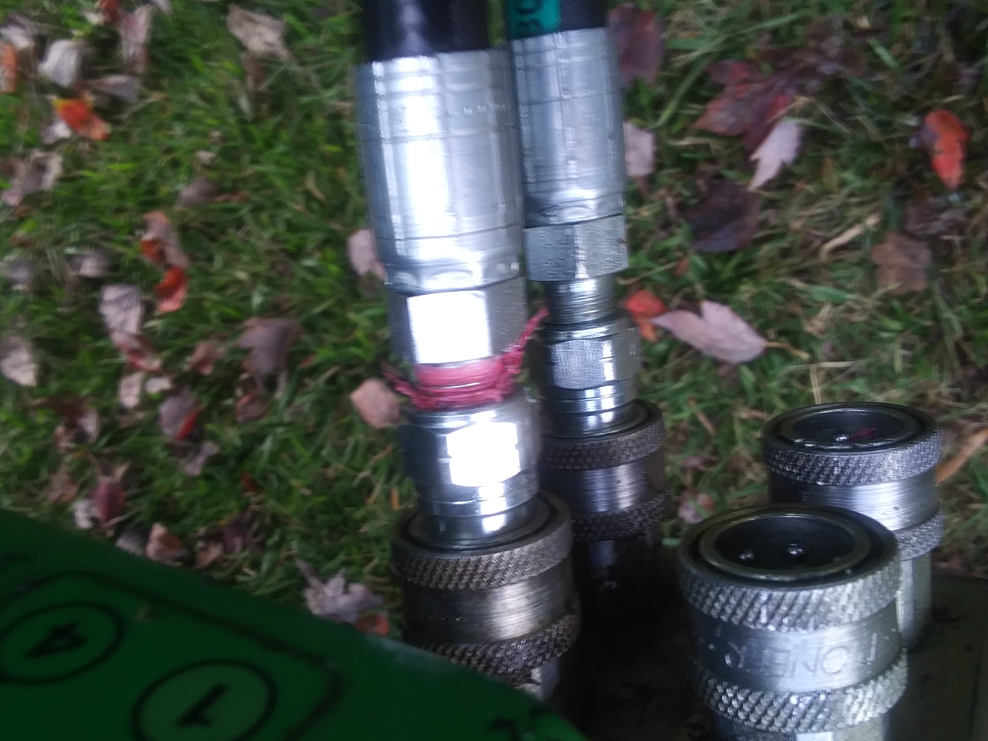

How about a picture of how you have it hooked up?

These are the pictures 20201022_141805.jpg20201022_141809.jpg20201022_141923.jpg20201022_141936.jpg20201022_141951.jpg20201022_141956.jpg20201022_142013.jpg
   / LOG SPLITTER FOR MY JOHN DEERE 790 #10
I don't think a loader valve is setup for unimpeded continuous flow like you need with a splitter. At least not in a consistent reliable way. Someone else may be more familiar with the hydraulic circuit on the 790 but I think you need to tap into the circuit downstream of the loader valve. The splitter needs positive pressure inflow and unimpeded outflow back to the reservoir.
