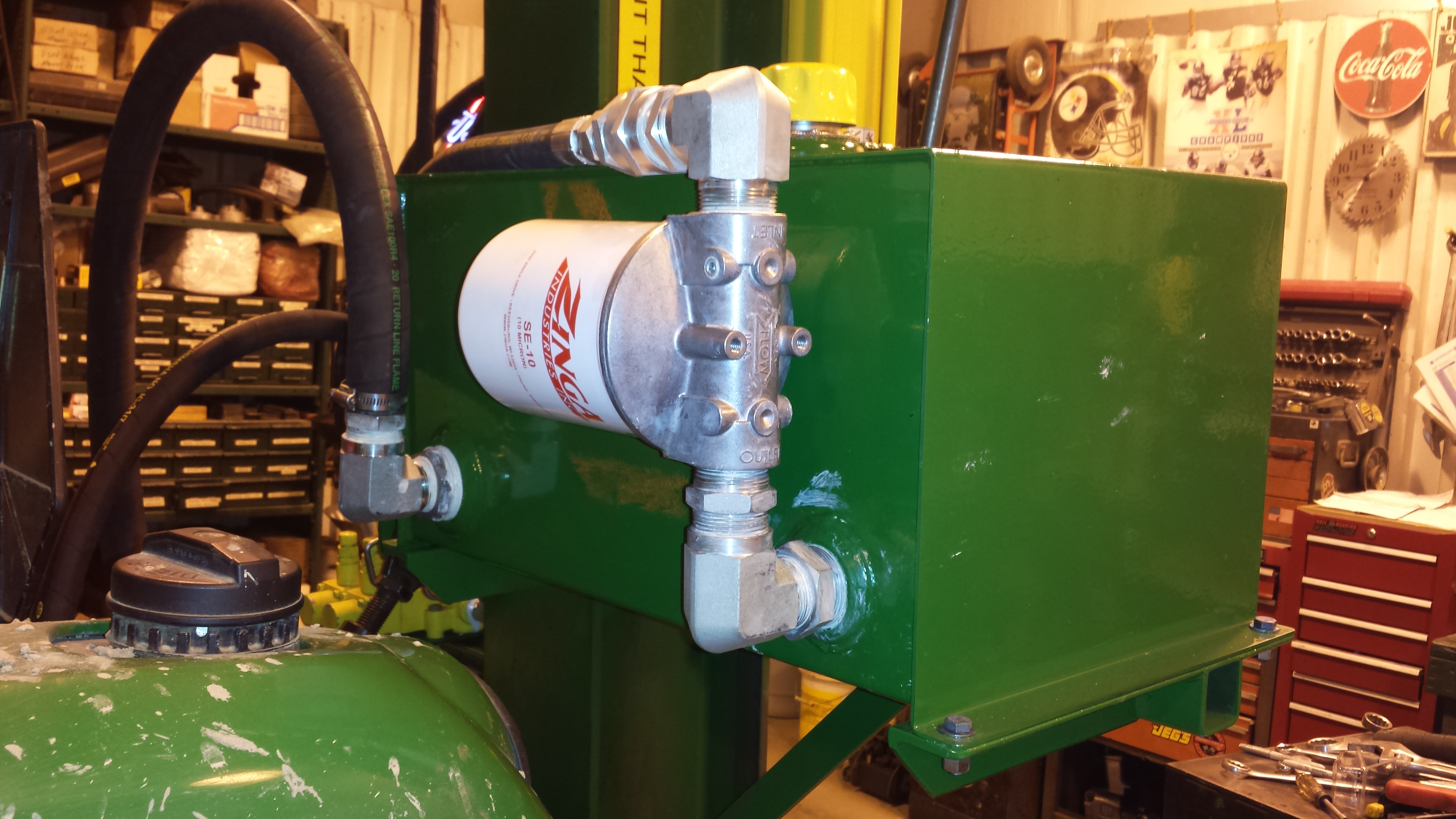

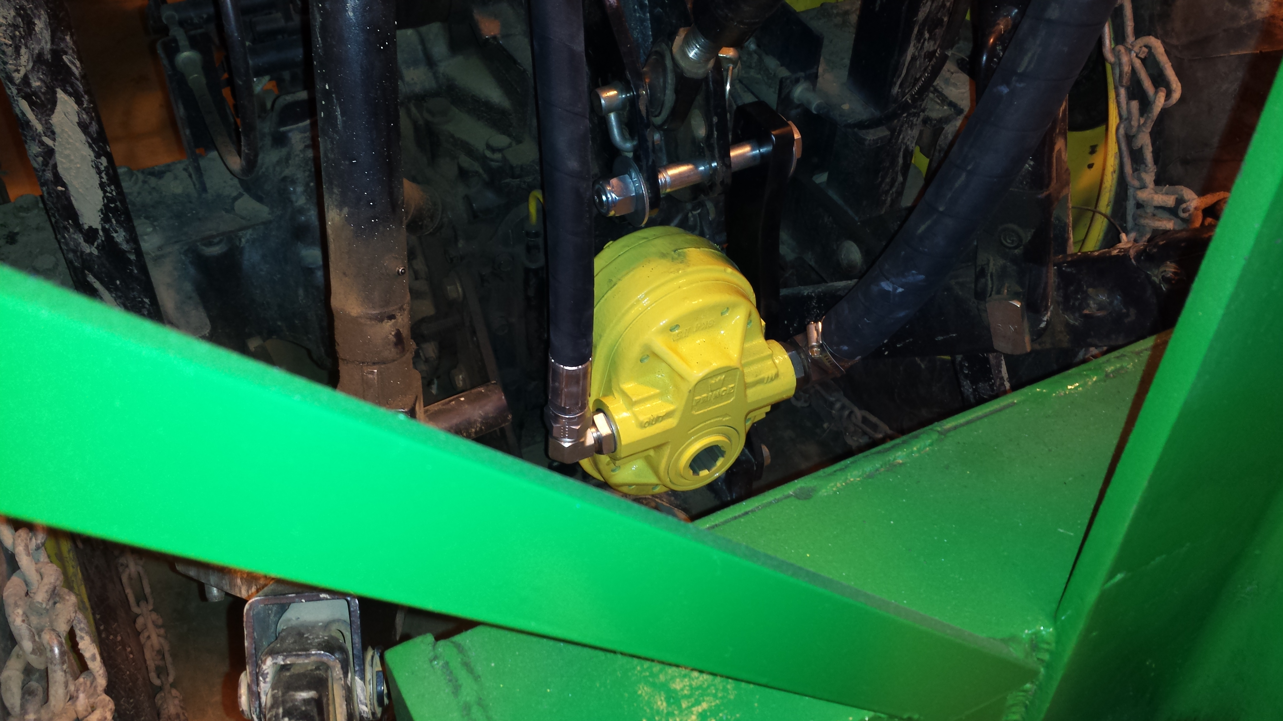

My suggestion is to only add a hydraulic tank, not install the motor but instead install a PTO pump. I converted my splitter to PTO pump a couple of years ago after my tractor hydraulic pump started to leak internally. Needed to install a new pump. I also changed out the 4" cylinder to a 5 " cylinder. I purchased the Prince 21 GPM PTO pump and a 15/17 gal hydraulic tank. I run the tractor at 1800 RPM, PTO at approx 390 RPM and GPM at approx 15. The 24 " stroke with the 5" cylinder cylinder gives about a 10 sec cycle time. Note the pump is a single stage gear pump so there is no ram speed loss per se. I have run the splitter in some 80 deg f weather, 3/4 hours and the highest oil temp was approx 105/110 deg f. HP for 15 GPM at 2250 psi = 19.6 HP. My auto cycle valve is factory set a 2000 PSI therefore I only need calculated 17.5 HP. Mounting the pumps reaction arm needs to be simple. Mine connects to the lower top link hole 3 pt. I needed to fabricate a right angle fitting for the suction side of the pump. Other than that it was and easy conversion. Without the pump and new cylinder cost I probably had roughly $900 in the conversion. Some pics. Later. 20151124_202852.jpg20151124_202951.jpg20151124_202904.jpg20150924_145442.jpg

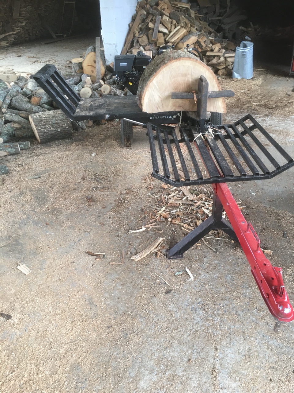

My unit is very similar to yours but it was built by a small commercial fabricator. My wedge is direct mount, no swivel joint,?
You have two spool valves? I have one, only hydraulic function is extend/retract ram.
My prince pto pump is smaller than the 21 gpm. I should research the model # but likey 11 gpm, reservoir is about 10 gal cap.
Never had overheating issue but I just built a hyd pto power unit capable of 31 gpm and that unit has a cooler w/ 12V fan. 51 gal reservoir.
A two speed pump would be nice, 5 inch cylinder retraction is kinda slow, but I am NOT a commercial producer so time not a big issue.
I prefer my vertical stroke, no interest in picking up large sections to set on a horizontal unit. Mine in 20 years old, works as well as the day it was purchased. Mounts right on 3 point and top link, Never hesitates, even splitting knots.
I have a non-contact tachometer but never checked pump rotation. Never needed the full gpm capacity, engine rpm at 1200- maybe 1500 tops. 540 rpm occurs at 2465.
Major difference between mine and yours is paint scheme, that would clash w/ ford blue.
EDIT:
It is ok to differ w/ opinion below. No one member's perspective carries any more weight than another. I prefer my approach and he appreciates his. Some like orange, others like green.
When the dust settles, the earth is still turning on its' axis, the sun still rises in the morning. All is good.
