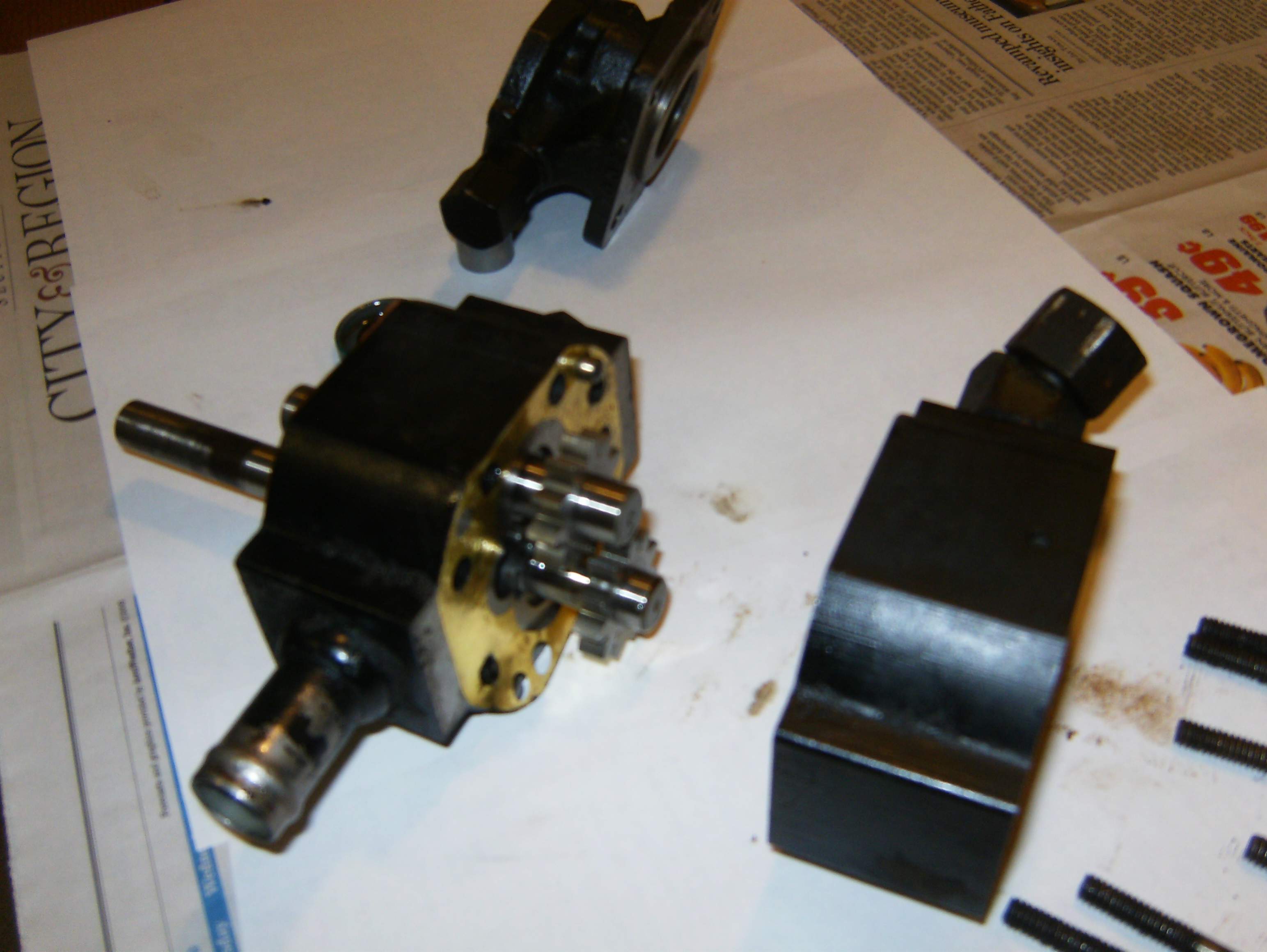

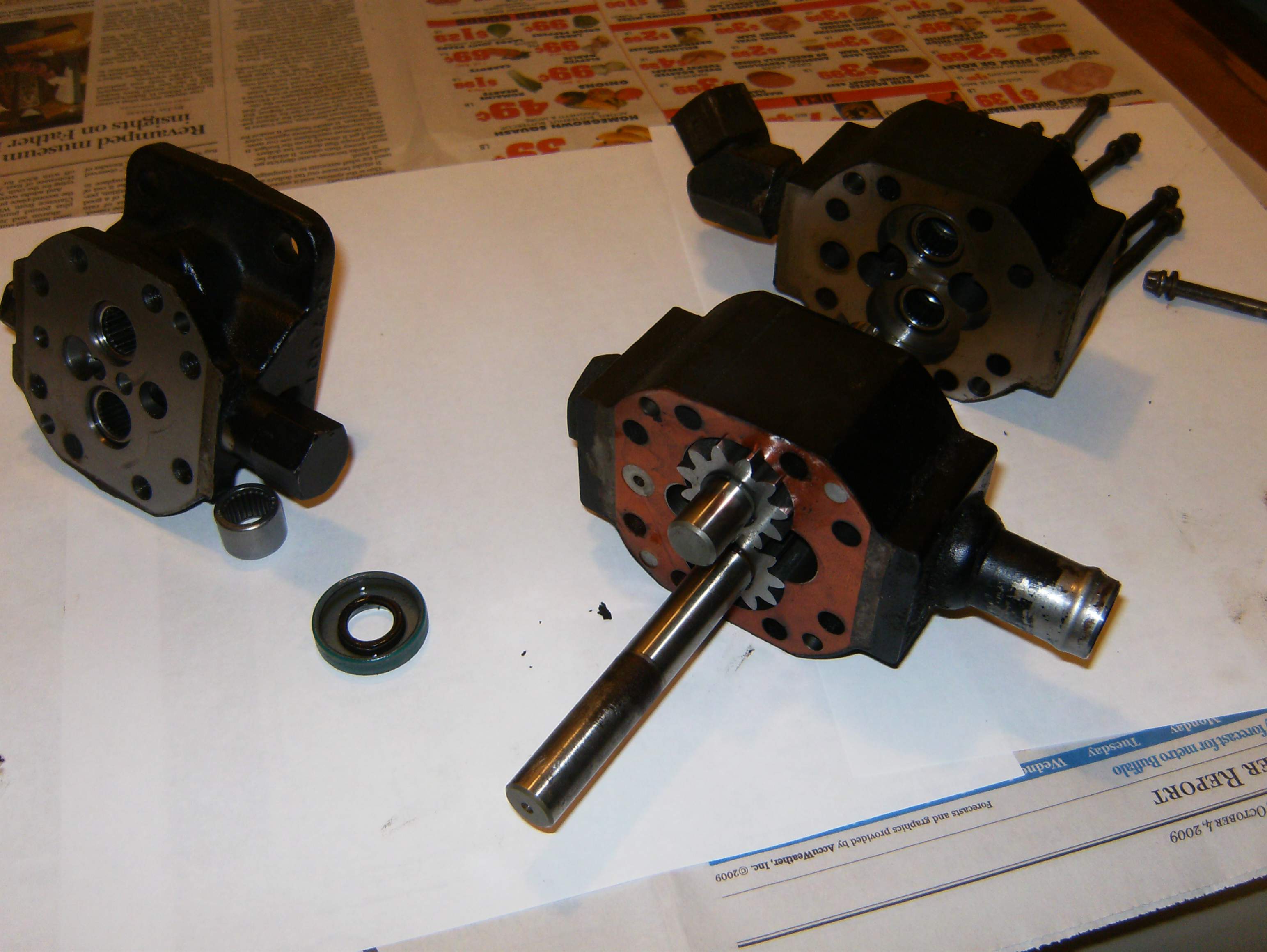

Brief update- Unit off machine. Definate 'slight' play at shaft end bearing/seal. Certainly the culprit! Oh great! Torx-headed bolts! Eight of them on the far end! A seven mm six-point just barely fits, but I know I'd round them off. Now just where do I go to get a Torx socket, that I'll probably never use again......:mad: ~Scotty
/ Log Splitter 2-Stage Pump repair
#9
Well, opened it up! Found a ten-piece set of e-sockets for less than $20- at TSC! Not much inside to fear, no springs etc. Just gotta watch for some small o-rings, and one woodruff key. Biggest concern is the two gaskets that are in between the three sections! Man, there're the thinnest foil I've ever seen! One red, one gold. Got the seal knocked out, and pulled out the bearing using a 1/4" theaded rod with a fender washer on one side, and a washer that was just a whisper shy of the bearing OD on the other. Walked it out with a 1/4-20 nut. Installed in the reverse fashion. Got the parts, bearing, seal, and internal snap-ring from a local bearing house for ,<$10-! All back together, I'll mount it this weekend! We'll see!!!!! :D ~Scotty

What did you do about those foil gaskets? I took one apart once and could not get replacements for those gaskets . I think they are like shims and set the clearances.
#11
I'm not sure about the clearance issue you mention. They're probably some cross material between foil and mylar. All I know is they're super thin, and I took great care not to 'bugger' them up, and reused them! ~Scotty
