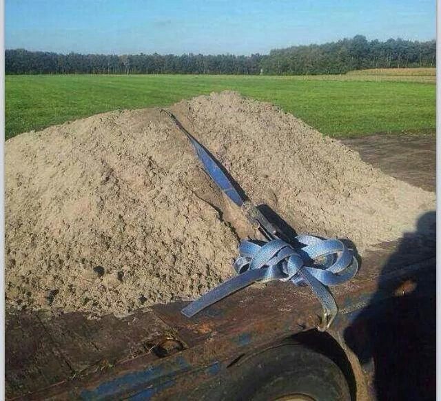

/ Log hauling with dump trailer #9
You aren't trying hard enough. Anything can be strapped in. :) <img src="http://www.tractorbynet.com/forums/files/trailers-transportation/450153-log-hauling-dump-trailer-sandstrap1-jpg"/> Bruce
But that doesn't mean the strap will actually do anything.

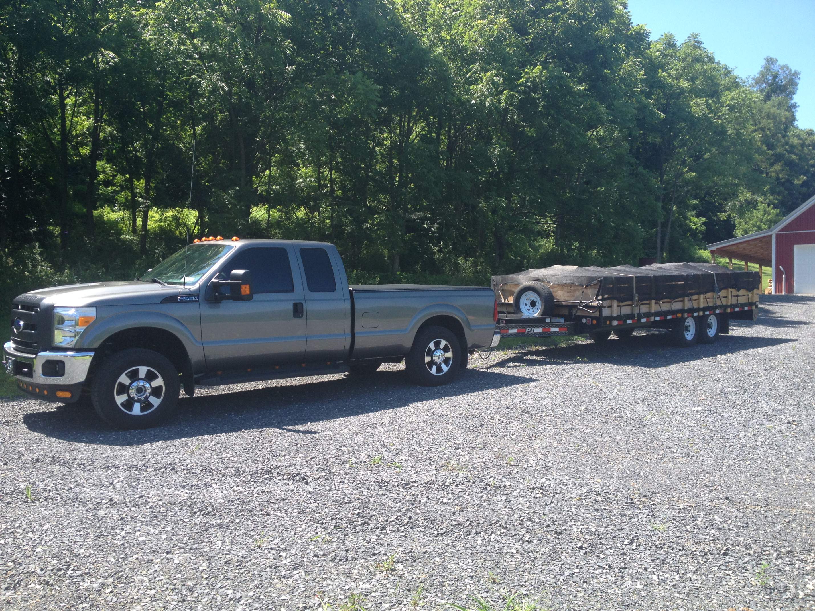

/ Log hauling with dump trailer #16
I haul plenty of logs in a dump truck. I don't strap them down. I don't load above the side boards. I have hauled logs on a gooseneck trailer, and those get chained on. I have never secured firewood either. How exactly do you go about doing that?
Here's what I do. Better than nothing I guess...
