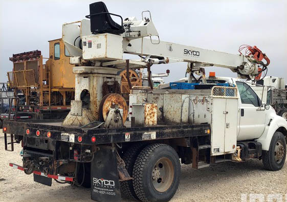

I worked for a company called Telelect* who made digger derricks, booms and over-centers for the power industry. One of the jobs my department did was install the big bearings that the whole thing rotated on which were about three feet across. These were held on by a bunch of 5/8, grade 8 bolts and the company didn't want these to come loose, so we used red loctitie on them. We torqued them down with very large torque wrenched, the largest I ever used in my life. These bearings are located just below the operators seat in this picture. *Terex today
