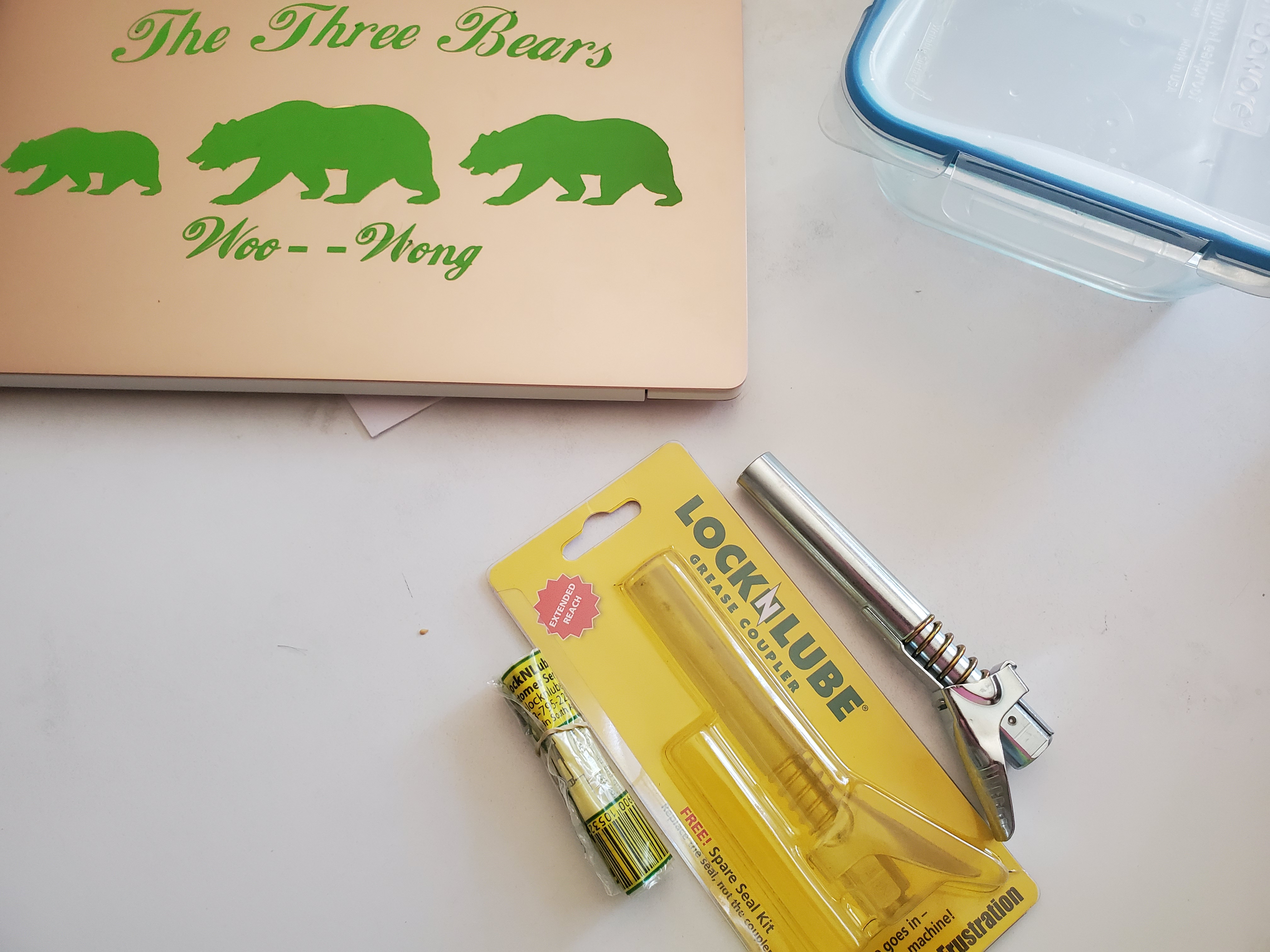

20200716_100554.jpg Woohooo my XL came in last night. Gonna try it out before I go to work today

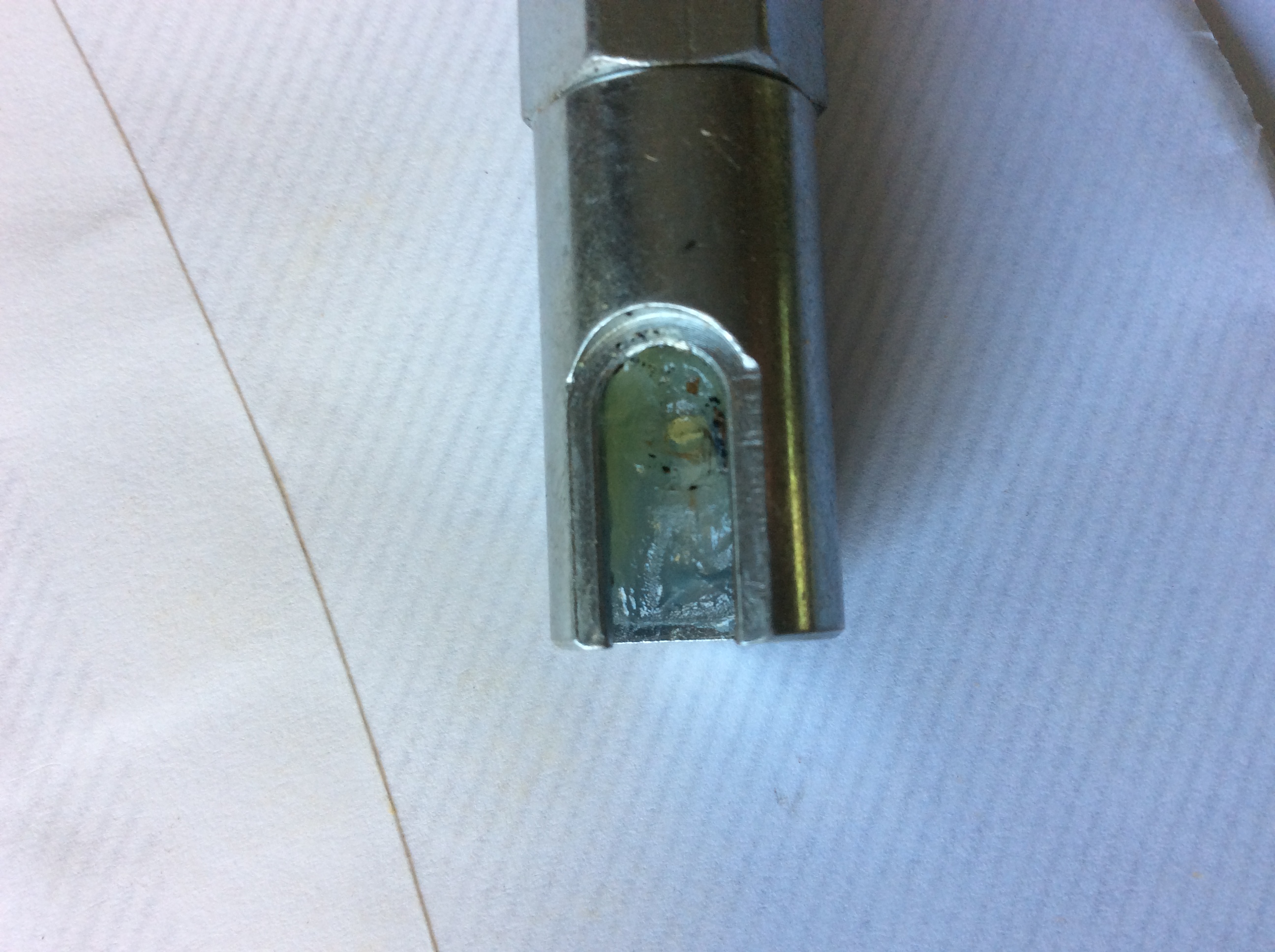

Yep, could it be grease? Maybe they tested it before shipping it.
Not wax, not grease, plastic. It holds the slide on part on the zerk and the tiny hole pumps it into the zerk past the one way ball valve.
