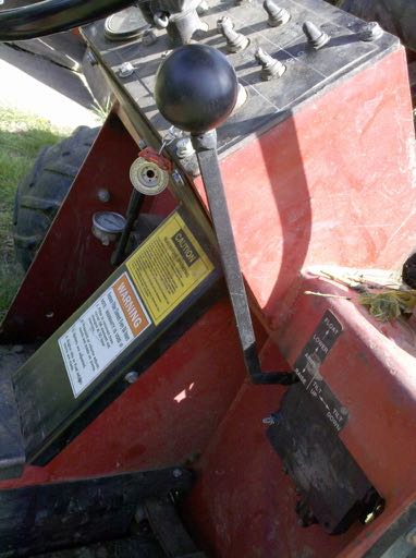

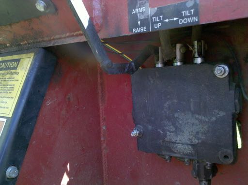

BW asked about the locking arm modification. There are some amazing machinists here and what I have to show I am not proud of but it works. I took some flat stock, cut it into a pattern, welded it together, added a bolt at the top to hold the knob and drilled a couple of holes and here is my version. This is a life saver if you have a grapple or a back hoe. Not much use for anything else I think.

That is something on my list of things to do to the 1430. Does anyone use their knee to work the little lever that Power Trac puts on that control valve? Just curious?

Just ask yourself this.... "Does it work?"
If yes, then... :laughing:
On my 425, I'd have to shorten my shin by about 8-10" to get my knee under there.
