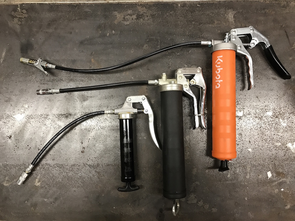

Here is my line up... only using one of them now and yes... the one with my LockNLube on board. I spent way more than I should have for this little contraption, but it makes lubing pleasurable. Yeah I need to get a life.
