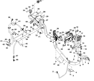

   / Location of fuse box for 5085m #2
After viewing parts catalog I think fuse box(key 28) in under cowling in front of instrument panel or under hood. Elect problem could be faulty relay. I think you need to acquire a JD 5085M tech manual.

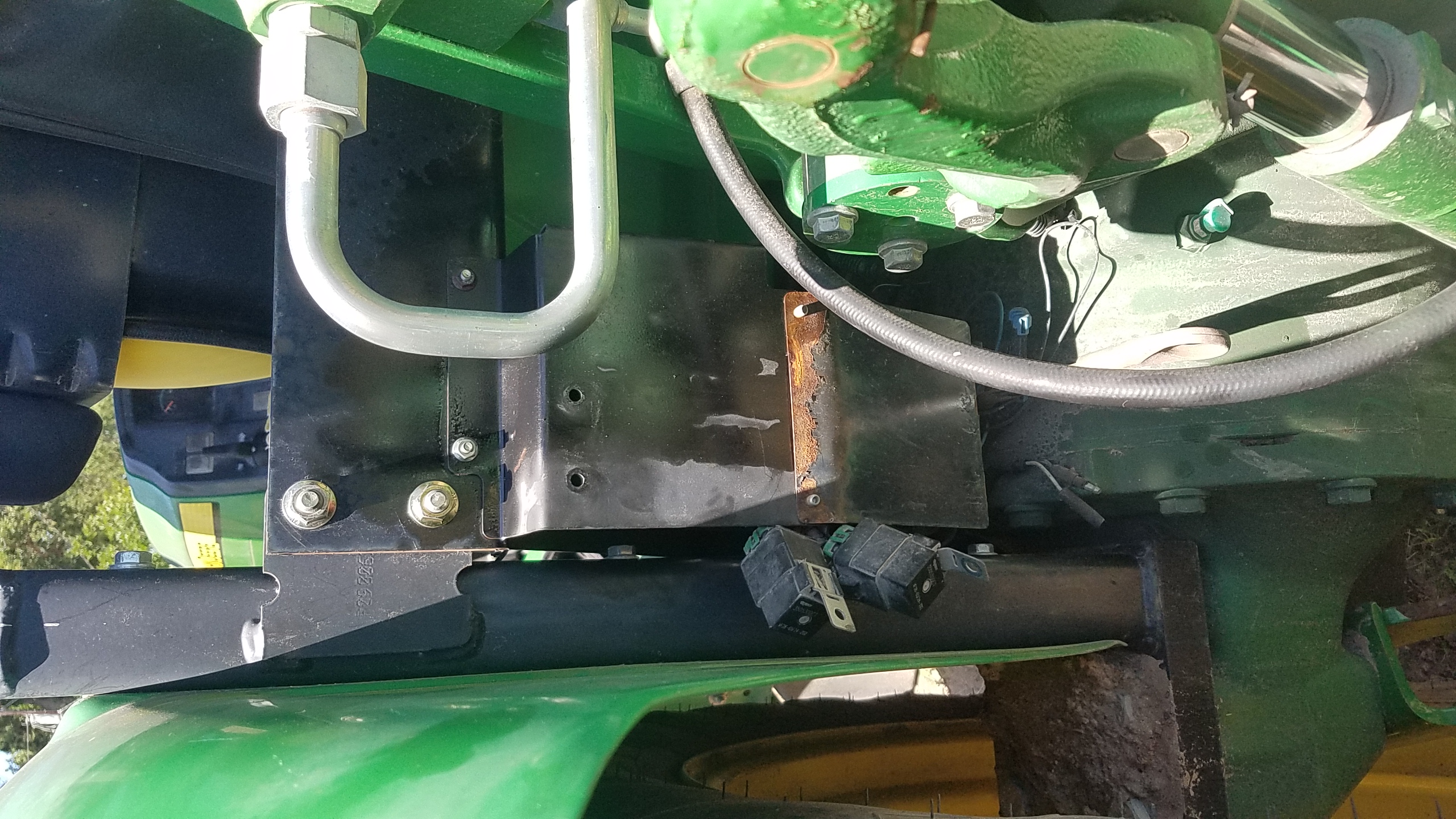

This seems to be the harness that the coils/solenoids connect to. There are 2 relays at the end. Looks like that maybe behind the seat area.
I checked the coils and they read 4.8ohms, so not the issue. I found the 2 relays in the back tapped them with a wrench and the grapple started to work.
Therefore I think I have an intermittent relay issue so think I am going to get 2 new ones
