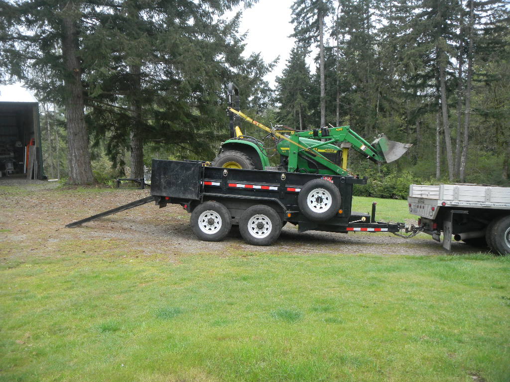

I need to build a set of ramps about 4' long by 12" wide to load my SCUT onto a trailer. I have welding and cutting equipment but very little knowledge about the size and shapes of steel I should use to accomplish this. I could build a set of ramps but I tend to over do it and I'd like to be able to load the ramps by hand after the tractor is aboard.
/ Loading Ramps #2
You could use some 3-inch x 4.1 # C-channel. That is what my ramps on my dump trailer are made out of.
