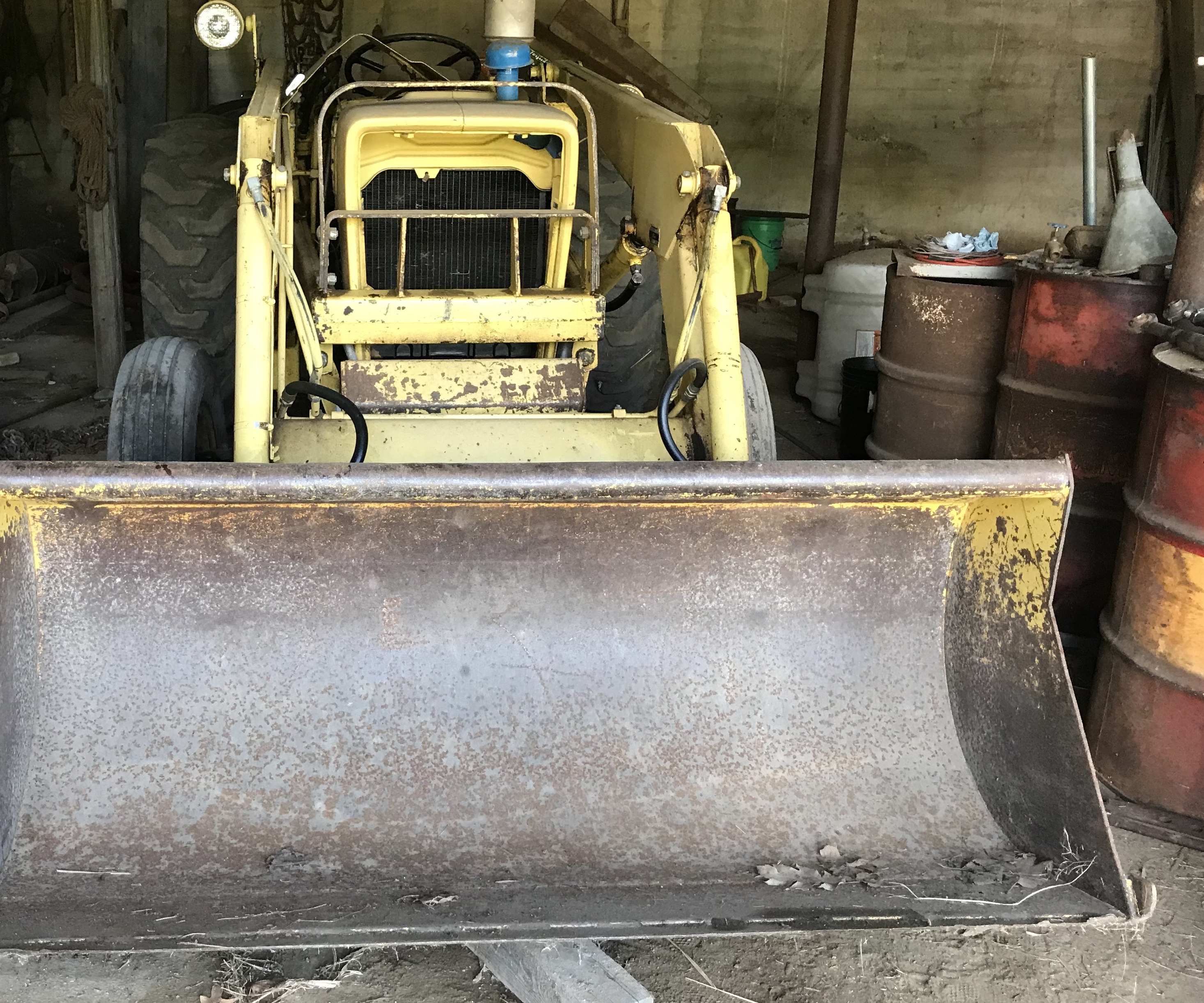

It didn’t work. First I ran a chain around the Ford loader arms and worked the control while my brother lifted with the Kubota. I never thought that little tractor would lift the front tires of the 3 ton Ford, but it did. He then hooked a corner of the ’Bota bucket under that of the Ford and raised it enough so that I was able to get a block of wood under it. We can now drag it out with a chain as somebody suggested, but I don稚 want to go that route until I’m sure that I know what I’m doing.

It didn稚 work. First I ran a chain around the Ford loader arms and worked the control while my brother lifted with the Kubota. I never thought that little tractor would lift the front tires of the 3 ton Ford, but it did. He then hooked a corner of the 達ota bucket under that of the Ford and raised it enough so that I was able to get a block of wood under it. We can now drag it out with a chain as somebody suggested, but I don遞 want to go that route until I知 sure that I know what I知 doing.
Evidently you didn't put it in float.
I have raised my loader with a jack while the control valve was in float.
It’s a 50 year old tractor and doesn’t have float. It should have released when I opened the valve though, right?
