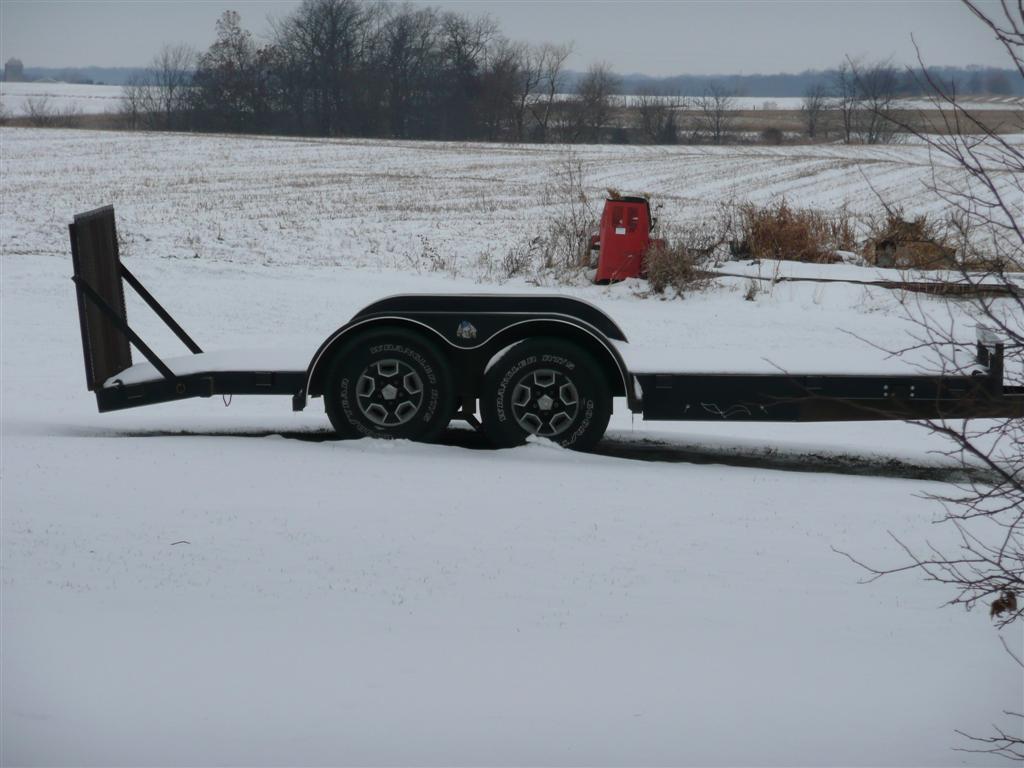

My opinion would be look for a used 7X16 car hauler or a utility trailer (rails on the side) with brakes and rated for 5200lbs or 7000lbs. For around $1000-$1800 you would have your own and could use it when ever you want. If you had a trailer to use at will you would use it more than you think. Also trailers hold there value very, very well. I have a 16' trailer and with my 2520 with loader on and my rear blade it takes the whole length of the trailer. Enclosed trailers would be nice but, you would need a justify other uses to pay for the extra costs.
Here is my 6.5X16' trailer.

I agree with Newt92, 16' is the way to go.
