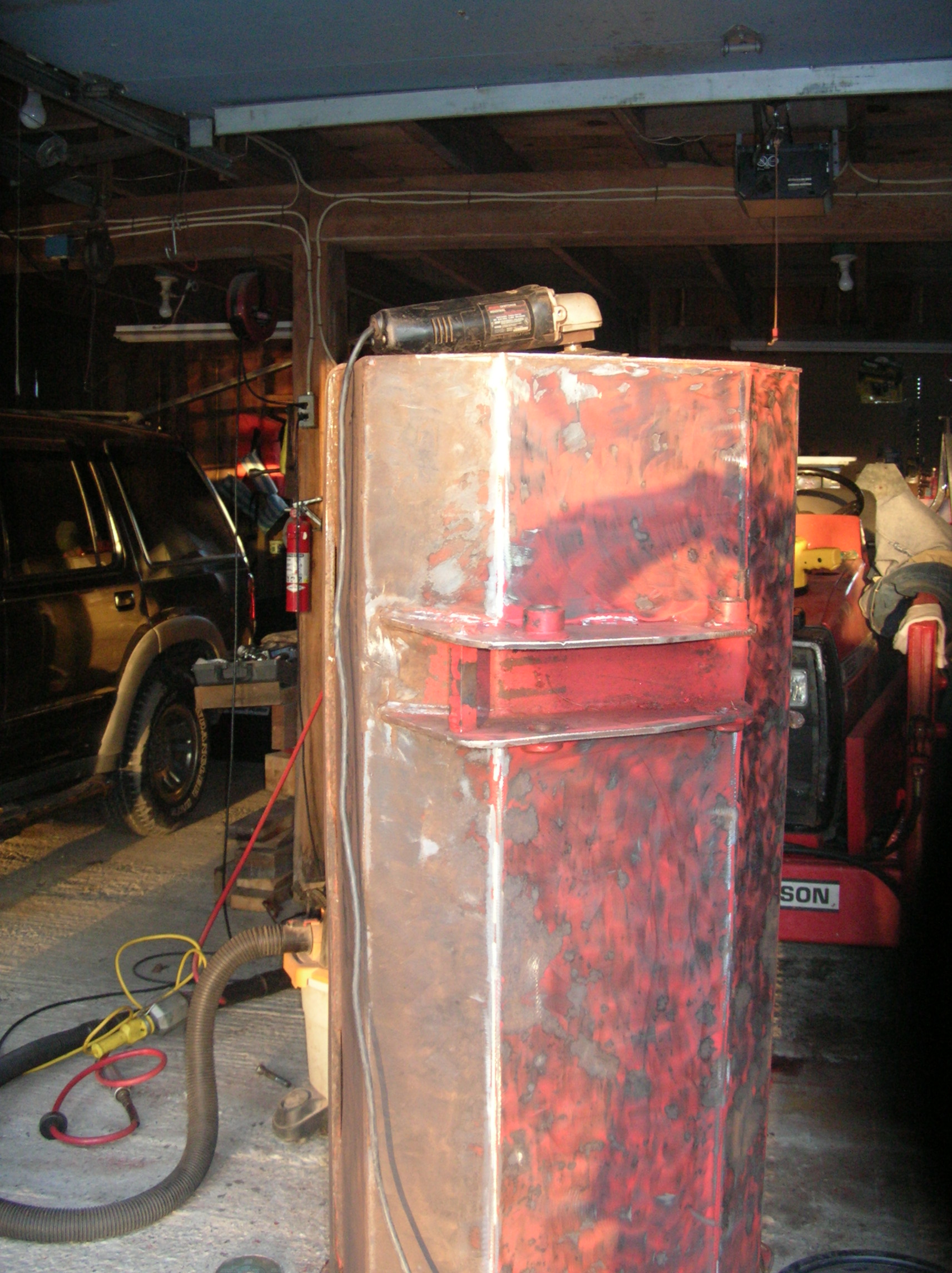

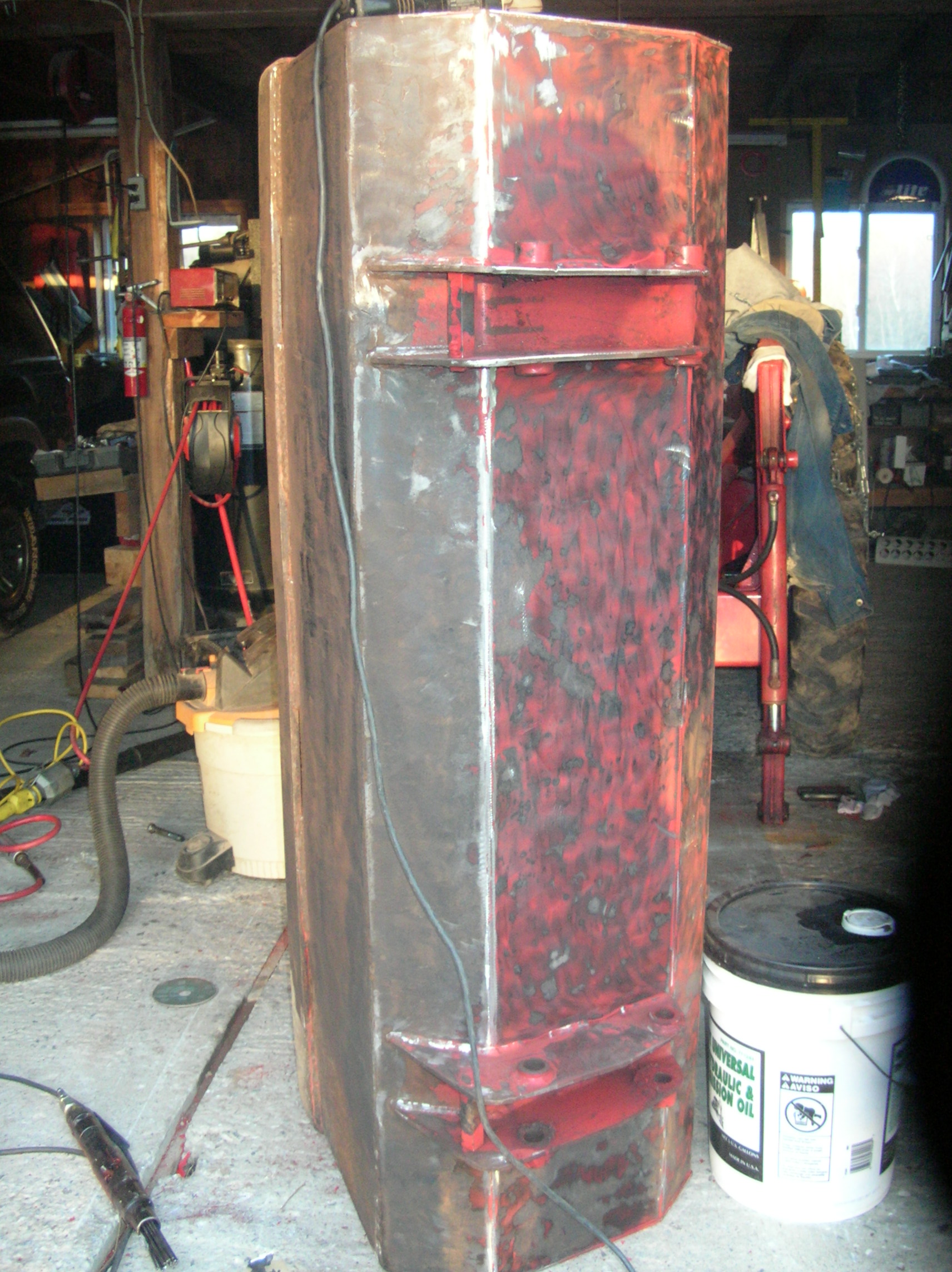

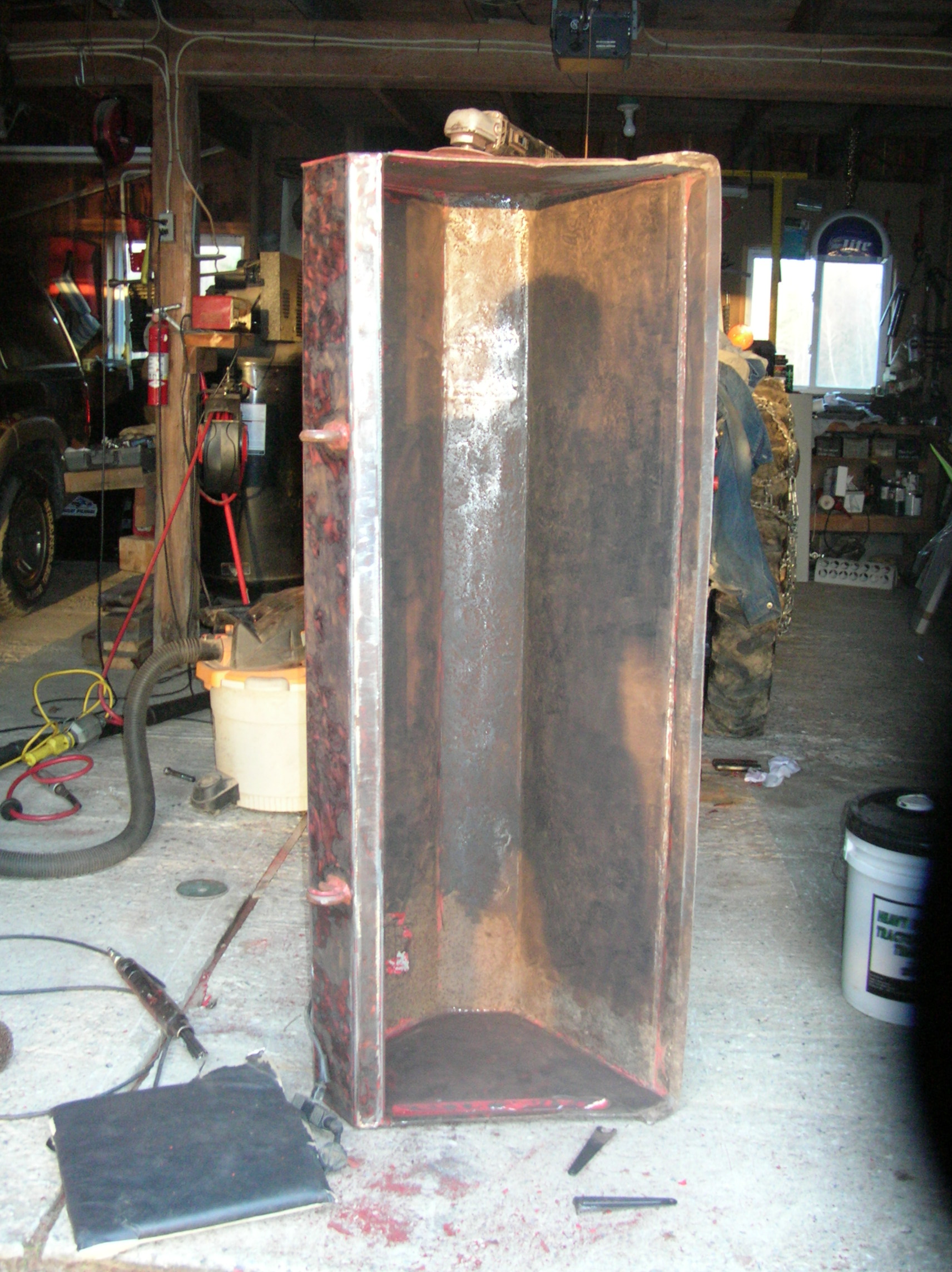

DSCN0929.JPGthanks for the links.i was just going to clean up the bucket and paint it.but i like the idea of a quick release bucket.im thinking of cutting off the bucket bracket and adding a plate to the bottom of the bracket.then adding a wider plate to the bucket. add a hook to the top of the bucket and im done. sounds easy, we'll see. i looked at a jd 460 loader and i like the quick release. i work at a place were i can buy scrap steel at .10 a pound. if i make it myself i can do it so less then $20, welding rods are not cheap.i add sum pic i hope i worked DSCN0930.JPG

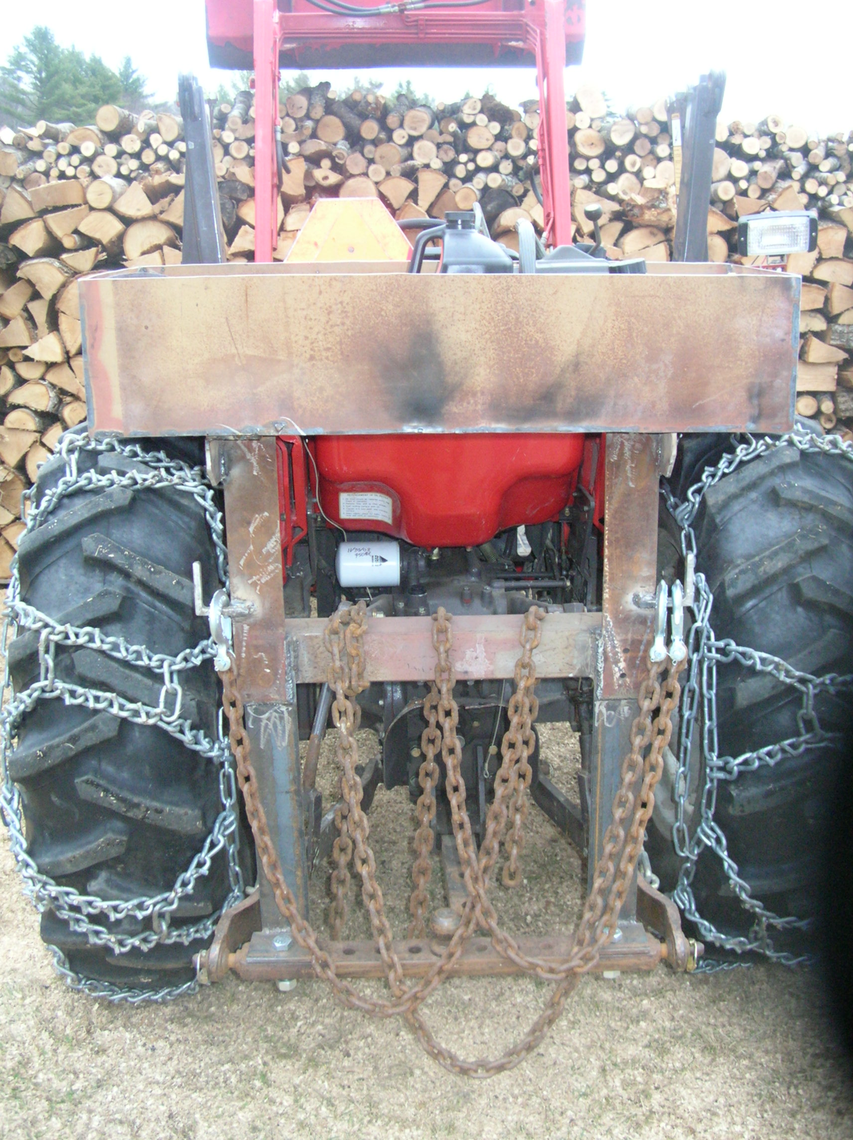

taking the bucket off was easy. i have not tried to put it back on.there was no primer on the bucket. there will be.the paint did come off hard,it was tough paint.DSCN0921.JPG i made a log hauler with chain saw box it still needs a little work

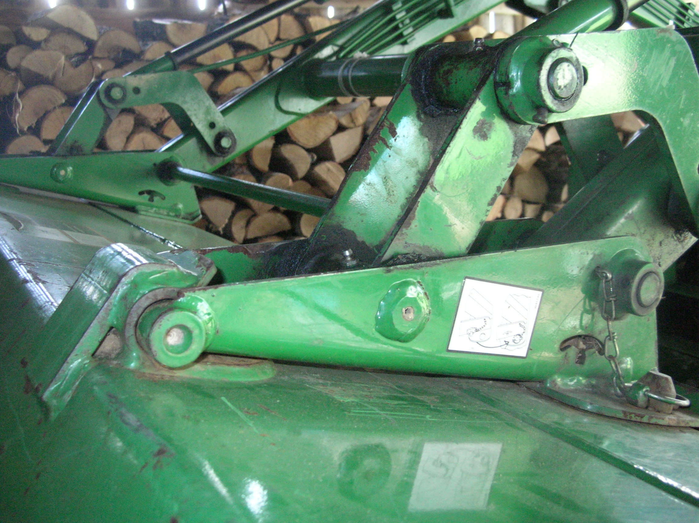

The JDQA (John Deere quick attach) you posted is a great system for smaller loaders, it comes standard on all the JD's. It is very light, and does not push the bucket out further both of which reduces the lift capacity. The parts are also easy to replicate, and not that expensive to buy from JD either.
If you search the term JDQA you will find more info on it, as well as some threads about making your own hooks and pins.
