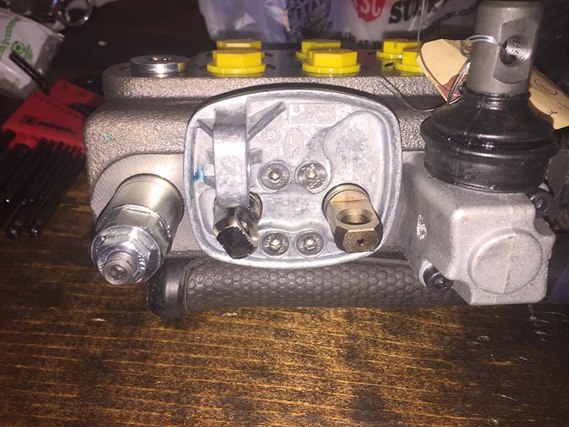

After cleaning and taking it down to the pivot block, it is obvious the orientation of the joystick can be changed. This block is for positions 1 and 4. You can see that stamped on the block.
All I need to correct this is the block for positions 2 and 3! Unfortunately, the folks I bought from is not interested in correcting this issue.
Does anyone have a good source on Walvoil parts?
I am going to email the guy I ordered from this picture and offer to purchase the correct block. I doubt it will do any good but I am going to try. :confused3:

I was able to find the Walvoil part number for the correct pivot block if anyone has one in their back pocket. :laughing:
This valve was used on several backhoes. The image below is from a LS Mtron service manual.
Part #3FUL220202 POS. 3
I will send this to the folks I ordered the valve from. Maybe then they will order it for me. :crossfingers:

The company I purchased the valve from finally understood what I was needing. They ordered the part today but did charge me $15. Sure would have been easier to get it right the first time.

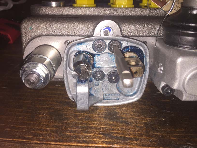

This is going to be fun! They put so much locktite on the screws that hold the pivot plate that three of the four heads stripped out. These are No. 3 Allen head screws.
Now to come up with a technique to get them out without damaging the valve. :banghead:

Two thoughts
When you suspect loctite, apply heat. The heat is necessary if the RED loctitite was used.
IRWIN tools that makes an extractor for stripped allen or Torx head screws.
Other forum members were very pleased when they tried them.
Depending upon your screw, you can use a tools which works inside the head.
Multi-Spline Screw Extractors - Screw & Bolt Extractors - Tools - IRWIN TOOLS
Or use a tool that goes over the outside.
The tools are sold in both kits and individual sizes.
Post a photo for more advice.

Thanks Dave, I found a technique that worked on one. Now if I can duplicate it 2 more times.
I am drilling the center out to make a deeper seat for this extractor. I had to grind the tip of the extractor to get a tight fit then I use the trusty old hammer and drove the extractor till it bottomed out. If it worked once surely it will work two more times? Let's hope!

Success!! Thanks to ACE hardware for having the perfect replacement Stainless Steel screw, the valve will now work in the proper direction! The new screws are a little longer that fit perfect. They bottom out at the same time they snug the plate up. No Locktite needed! :cool2:

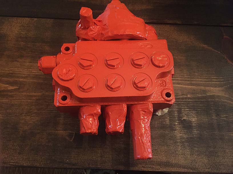

I used Kubota orange on the valve that will be mounted on my Kioti. Think I will get sued? :laughing:
