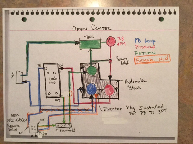

Thanks J.J., I will think on this and see if I can put together a diagram. It might help me understand all this.
   / Loader Valve plumbed with BYO, although no remotes

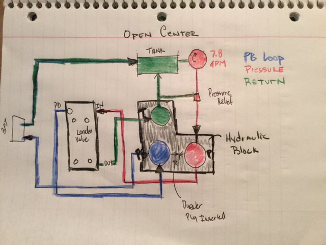

Here are two diagrams. I tried to layout the standard and new circuit. I think the standard is correct but I am not sure if the remote mod is properly diagrammed. I sure would appreciate any suggestions.
   / Loader Valve plumbed with BYO, although no remotes #7
The diagrams appear to be correct.
Have you did the mod or is this your plan?
Set your reliefs the same.
Thanks JJ, I am in the planning stages. First I wanted to understand the high level concept, then I will start planning the parts I will need o get a good idea on the cost. I need to start learning about the types of fittings Required to bring it all together. They seem quite confusing. I also plan on asking my dealer if the tractor has any rear-located tank ports. Near my 3 pt top link there seems to be a plug that could make it easy to plumb the "t" return. Thanks for the help, and if I can ask on the valve.. I am planning on a prince stack 8gpm. Standard spring to center 3 pos for top. For tilt I was thinking of the same valve but with float so I can float the tilt on my box blade or sring it to center to hold the tilt. For the last valve I was thinking of the 3 pos with detent for constant flow for a wood splitter or motor of some type. Do these choices make logical sense?

Your choice of the valve spools is good.
Make sure to get the PB adapter also.
