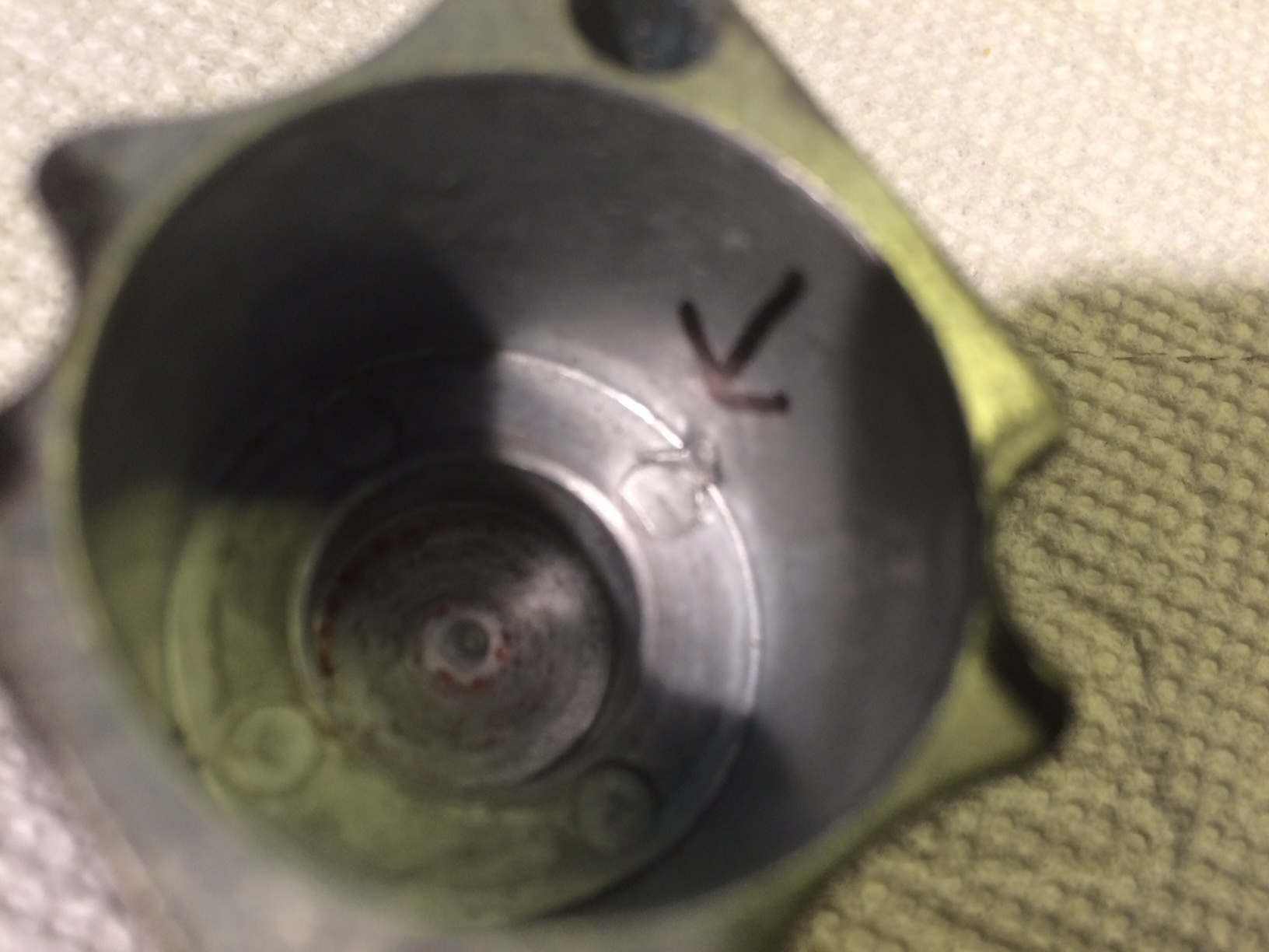

Good news! I found (per your suggestion) that loosening the end cap for the curl spool gives enough additional spool travel to nearly double the curl-in speed. Seems that one turn loose of the capscrew makes all the difference.
It has been taking about 19 seconds at low idle (1000 RPM) to curl-in but that time drops to 11 seconds at one turn loose and about 5 seconds at high idle (3000 RPM)
I now see that there is some casting flash down inside the cap. (see pic) The flash seems to be shiny indicating that the end of the spool retainer is contacting it. Will remove the flash and see if that fixes it. Otherwise can shim or remove about 1/32" to get the equivalent of half of turn on the #10-32 screws.
Will report back. Meanwhile want to thank you again for suggesting to check the end cap!!!!!

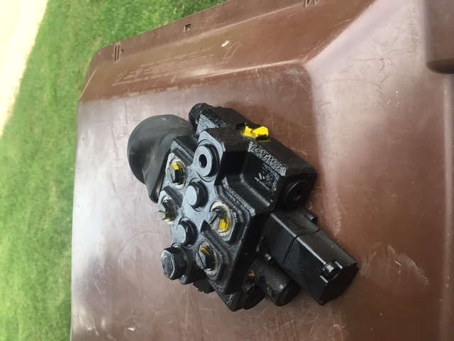

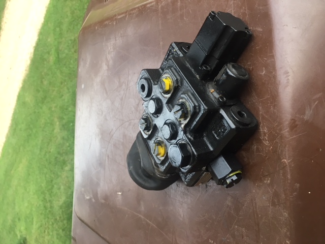

Does the Nimco happen to have P and T ports in the end rather than top or sides? That might make a good backup for mine. :)
/ Loader Valve Is Restricting Flow--Need advice #27
Npalen,
I do not believe it was a load check problem since while trying to raise or curl a load it did not drop. Lowering a load was the problem. I looked at the valve but did not remove the extra P & T plugs in the end of the to confirm they connect to the ones on top but 99% certain they do. Attached pictures is an attempt to show the end ports.

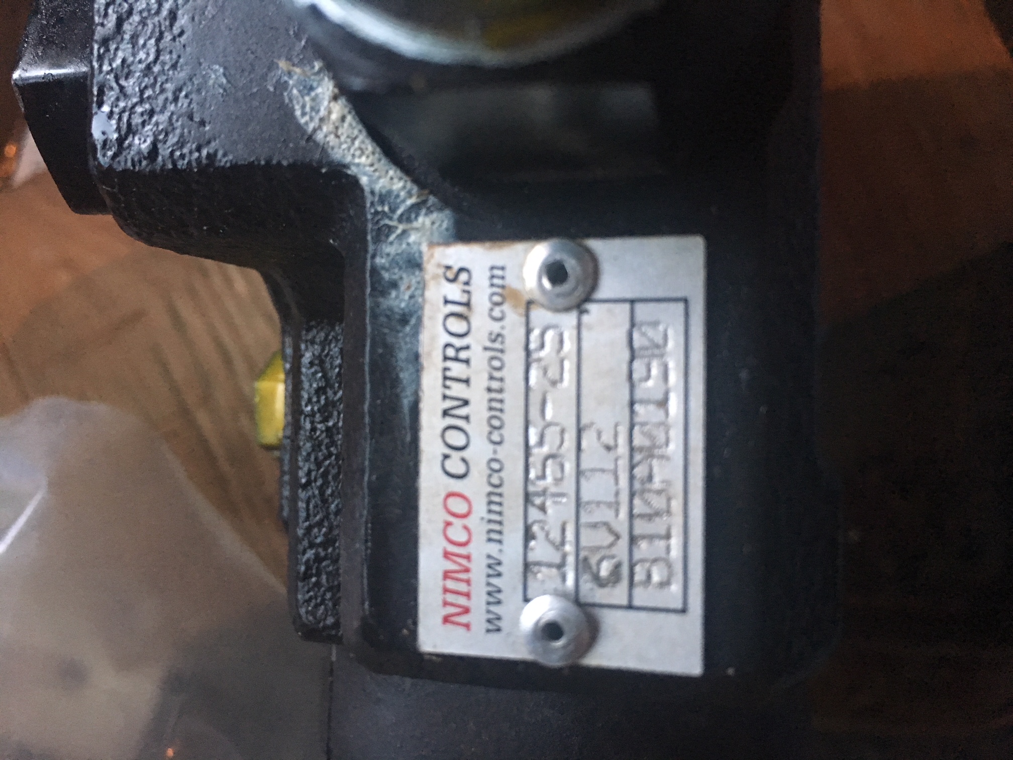

/ Loader Valve Is Restricting Flow--Need advice #28
Npalen,
I looked and the Nimco valve that I have is 12455-2S CV112. The curl spool travel is approximately 3/8" total or 3/16" each way from center. When I purchased my tractor with this valve the joy stick knuckle assembly was a ball of rust that I have to work free.
Nimco says you have a load check on each spool with a CV112
Two spool compact special loader valve with built in load holding check valves for each spool section. Designed for minimal spool leakage less than 1cc/min and optimal load controls on small front end loaders.
Nimco
Dave M7040
