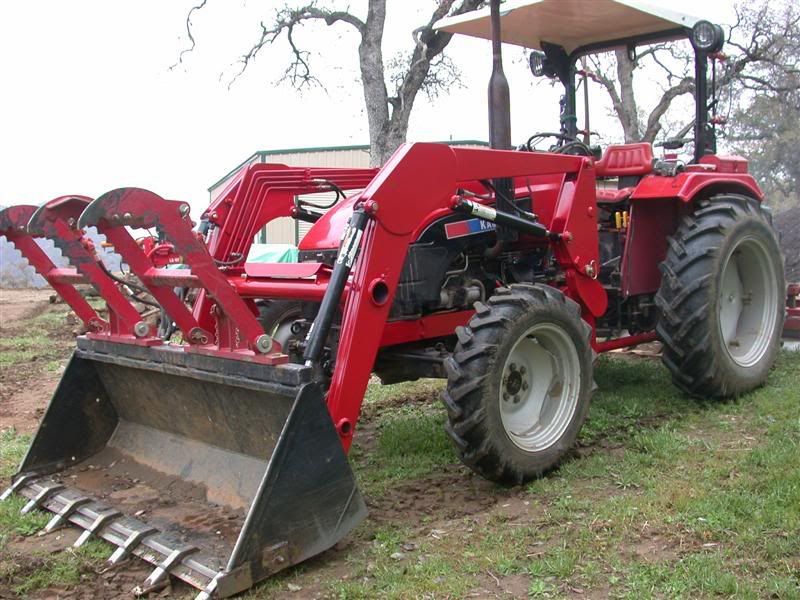

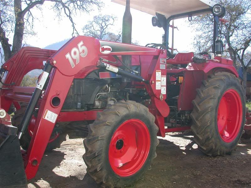

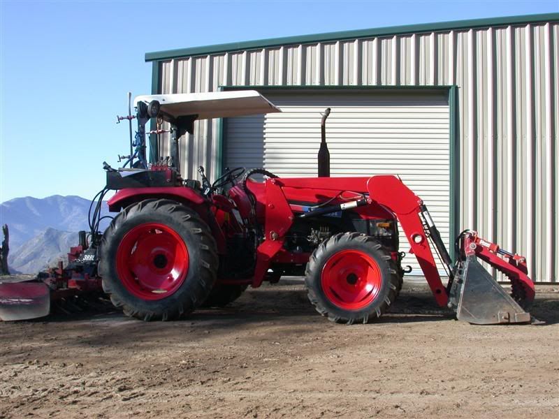

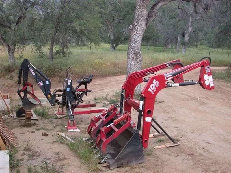

But not before I painted the loader red. I've always liked the way Brad's Koyker 195 looked, so I decided to copy him. I ordered new decals from Koyker and they are on the way. It was a good opportunity to clean all the pins and bushings and check for wear. I've had the loader on for 3-1/2 years and never taken it off before. As usual, Loretta was out there helping me clean it all up. Then she helped me mask off some parts and we started painting the components.

Just before that, I've always had a problem getting a grease nipple to the end of the loader arm. To get to it you have to raise the loader up a certain amount. It was always a problem getting the grease gun on and then getting it off. So I added a couple of Zerk fitting on top where I could get to them easily. I added 2 per bushing because I could not put one in the middle because of the seam there.
When I got it all together, it looked pretty good.

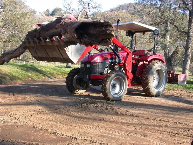

Here are a couple photos of it cleaned up and ready to work. I didn't wast any time getting back to that spot where the clutch went out. After moving some dirt, I got to the logs we wanted to saw up and split for firewood.
I also replaced a busted rear tail light, a busted front headlight and fixed some puncture holes in the grill. Then I repaired the brake light switch and adjusted the brakes. I also got a mechanical oil pressure gage since my sending unit was broken. There was a lot of wear and tear over the last 3-1/2 years, and this was a good opportunity to get some of the well needed repairs done.

I do try hard to keep things up to par except my golf game.:) I too am glad to have the tractor back up and running good again. I found out that Brad's loader is black like mine was and it was pj's loader that's red. Sorry about that pj.

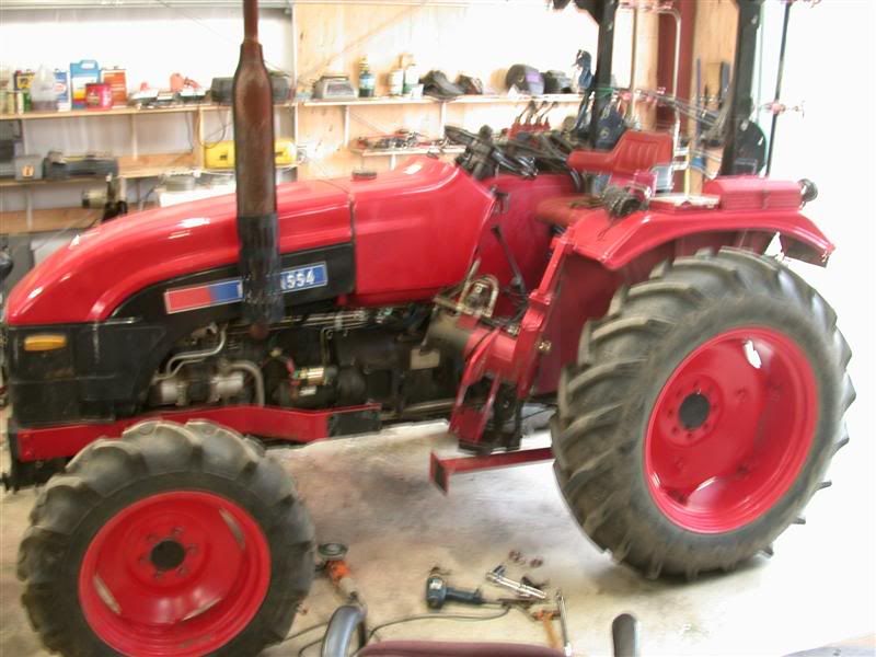

OH, did you see what I did this morning? I spit shined the wheels ...
I can't wait for the new decals to come in.
Rob-

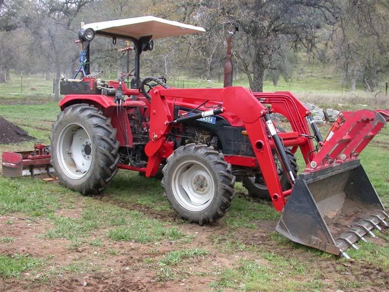

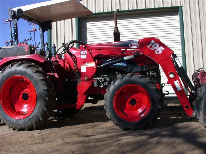

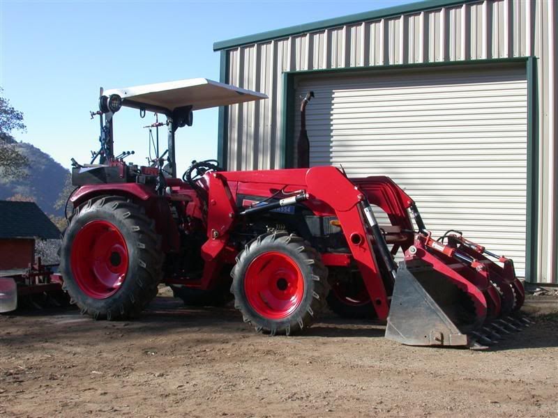

Just to finish off this thread, here are the photos from earlier today.
I already got the logos and safety warning labels and put them on this morning. There are a lot of safety stickers.
Tomorrow morning Huge Kama goes back to work pulling out some boulders for my neighbor.

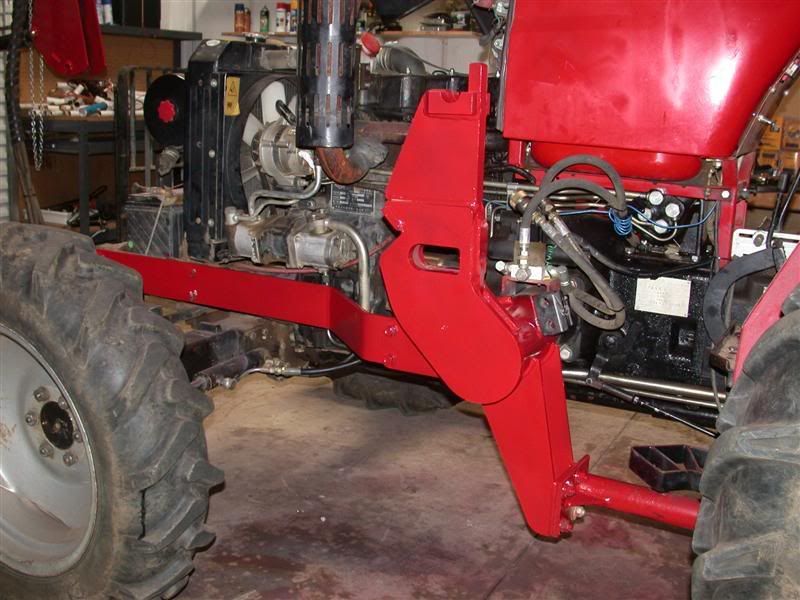

When I removed the Koyker loader arm mount (right one for checking and adjusting the clutch) and splitting the tractor to replace the frozen throw out bearing, I did not remove the left loader arm mount. I left that one bolted to the tractor. After another 80 hours of working the tractor, (665 hrs now) I heard a loud "POP" while doing some loader work. I was filling the bucket completely heaped over so it was at maximum lift capability which I think is around 2,500lbs or so. Anyway, I stopped working and started to check things out to see what busted.
I couldn't find anything until the next day.
My well driller guys were over looking at the tractor and they pointed out that a couple of the big bolts that hold the Koyker loader arm mount to the tractor were backed out. One of the heads had popped off and was missing. I pulled the tractor into the barn after taking the loader off. It was very easy to do that now that I know to leave the bucket on.:D You need the bucket to tilt the loader arms out of the mount easily ... It took literally about 5 minutes to take off.

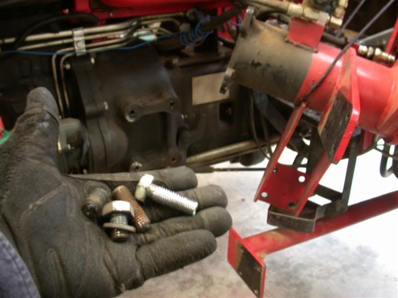

Once I removed the right loader mount, I realized all but one of the bolts had broken off. You can see that in the last photo. Only one bolt was holding mount to the casting. One bolt broke off at the threads, right at the casting, so I was worried about getting it out. The others where only the head broke off, I was able to get out with a pair of vise grips. I cut a slot in the short one and was able to remove it with a large screw driver blade.
Of interest is that of all the Koyker loader parts, only these bolts were Metric. All the others were SAE. They are Metric because they screw into the cast bell housing. Anyway, a quick trip back to the hardware store and I had all new bolts. It only took me about an hour to repair and get the loader back on. I'm sure it could've been worse, but I was lucky.

What grade bolts were the ones that broke? What were the replacements?
/ Loader Upgrade and Paint Kama 554 #12
I would not put stronger bolts in. The factory ones lasted 600 hours plus, and the last thing you want is a busted bell housing. Its easy to check the bolts or just add replacement bolts to your 500 hour service interval. A busted bolt is nothing for a guy like Rob to get out. The dreaded busted bell housing would require splitting the tractor and making repairs, which I am sure Rob can do and actually make it better while he is at it.
Chris
#13
Parry,
The OEM bolts were 8.8 like an SAE grade 5, I think.
I replaced them with the same grade for exactly the reason Chris pointed out. I had them tensioned really good and I'm glad they snapped rather than stripping out the bell housing or even cracking it. Chris gives me more credit than I deserve, but I sure don't need to add a repair like that to my workload right now. My Koyker FEL has been great and seen a lot of work. I'm very happy with it.
