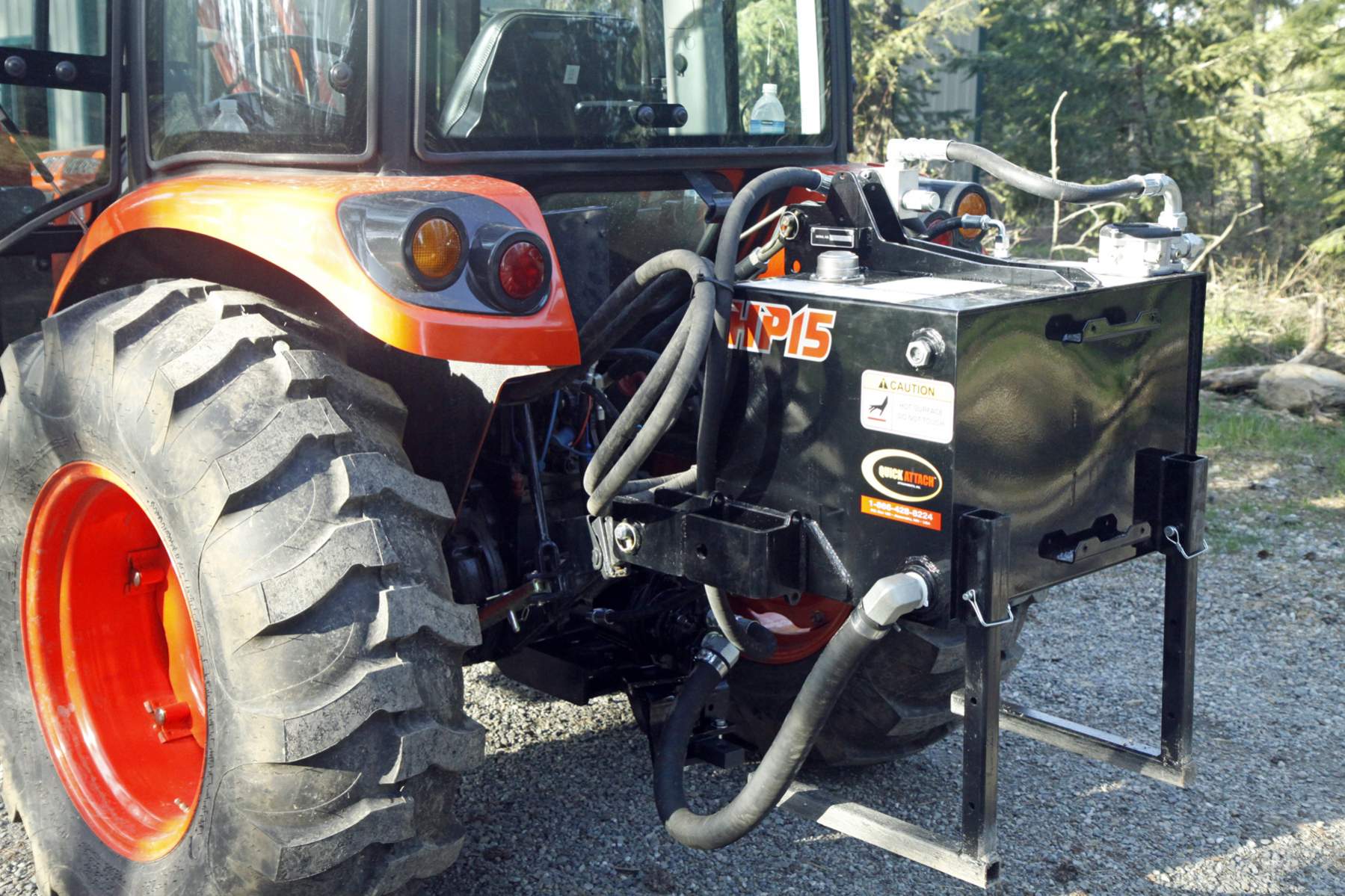

So i have started to work on a snow plow off of my old dodge to make it fit on to the loader of my tractor. All is going well i got the valve body and all of that good stuff. How ever i am running in to a snag. The pump that came off of the truck ran from a belt. The main pulley was the crank pulley down to about a 6inch pulley. So i know that the pump is way to high speed to be shaft driven off of the pto. So i am looking for is suggestions and or ideas. I am in the process of looking for a pto pump how ever they are costly.

yup.. major costly, plus they heat the hyd oil so much that it needs a large reservoir to store it and allow it to do some cooling. Mine has a 50 gallon tank.
\EDIT: SILLY ME.... you said plow ... i read blower. Never mind this post

The pic grs posted is for a loader mounted hydraulic snowblower, that requires a lot of flow constantly, those need a PTO pump as tractor hydraulics cannot drive the blower fast enough.
Grsthegreat,
Sir, your set-up is the one I'm most looking forward to see working this winter! Lots of photos and video are in order! :licking::D
