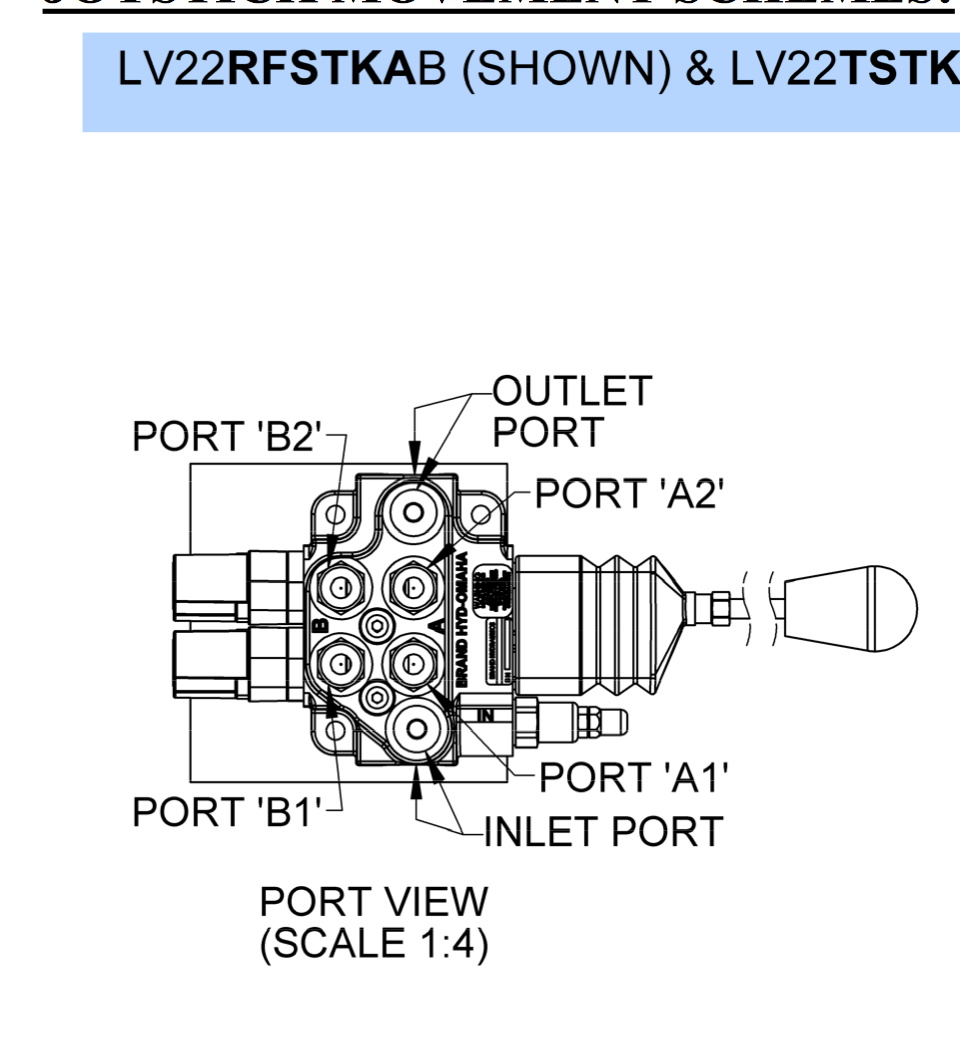

Here's a clip from the link at the top. I can post a photo of MY valve installation tomorrow.
Without knowing more where this valve is installed (i.e., with the 3ph etc...) and the PB setup I can't offer an observation...this could be your problem...but my first thought was...it is easy to cross working port hoses in confined spaces and if you're not familiar with multiple spool valves the labeling can be a bit confusing...never have understood why A1 and A2 don't work one spool and B1 and B2 work the next etc. etc...

I've checked that the A1,B1,A2,B2 go to the correct places, but it's certainly worth checking again. I think they are right because the functions all work. I briefly tested them by moving the joystick just a touch. I'll confirm this later today but my memory is that moving the joystick just a bit (no fully opening the valve) and the function works. However opening it all the way is what causes the pressure to spike.
It's a pretty confined space so it's certainly possible something got connected incorrectly. I'll checking that everything goes where it should before trying it again.

A1 and B1 go to the same cylinder (Curl). A2 and B2 go to the same cylinder (Boom). Wouldn't hurt to check that. 1s go together and 2s go together. Not As and Bs. Diagram is in the PDF showing which port gets the rod end of the cylinders
http://www.brand-hyd.com/lv/catalog.pdf

I confirmed the lines are connected correctly and in fact, after adjusting the pressure relief valve (down to 1000psi) things seem to be going better. I think maybe the relief valve was stuck. I plan to adjust it back upward to 2000psi but I've still got a problem to solve. It seems the system is really sucking air from somewhere. After running for about 3 minutes the tank overflowed because of all the air it had drawn in.
