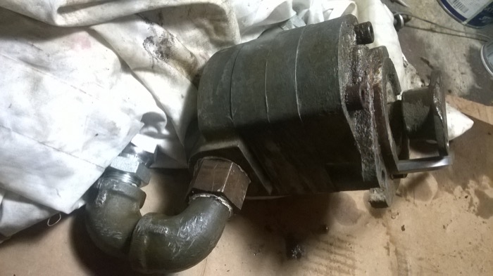

Unfortunately the 5Z420 means nothing, it is a casting number and not a valid model number. Also could not find any info on where a model code could be.
I also could not find any dimensional information to see if the different displacements had a different overall length. I suspect they do but not sure. The 0.5 cubic inch would provide around 2 GPM at 1000 RPM and 4 GPM @ 2000 RPM. This would be a reasonable match to a 4 gallon reservoir.
I know very little about pumps, but physically this seems larger than 2GPM. I'll hunt around more on the shell to see if I can find any model numbers. But based on the condition of the shaft (pretty rusted) and the fact that I could be guessing about the model, I'm not sure repairing this is worth it. Besides I'm not sure the 2GPM pump offers much in the way of improvements over what I had.

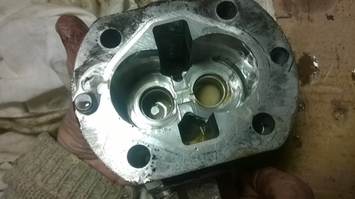

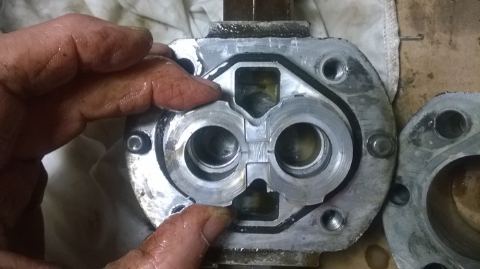

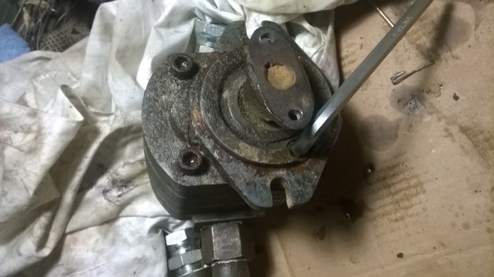

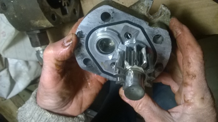

Here are some photos of the pump after removal. WP_20160119_005.jpgWP_20160119_004.jpgWP_20160119_003.jpgWP_20160119_002.jpgWP_20160119_001.jpg

Looking at the pump pictures and presuming the pipe fittings are the inlet port this is a CCW rotation pump viewed facing the drive shaft.

Pump And Motor Identification
CROSS pumps and motors are stamped with identifying six digit stock numbers on the lip of the flange as shown in the diagrams below.
If stamped numbers on the flange are difficult to read, displacement may be determined by measuring the body or gear width as noted.

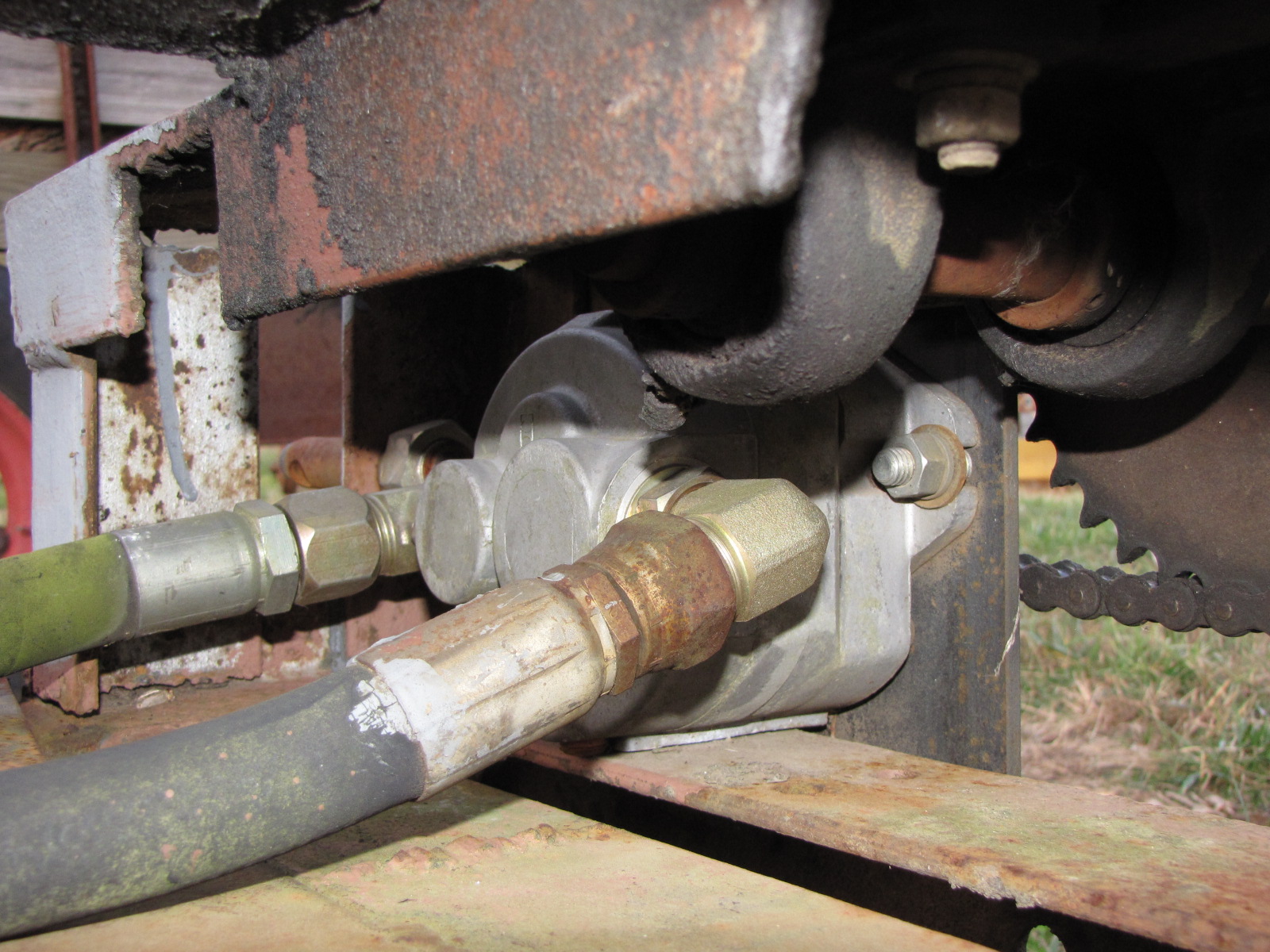

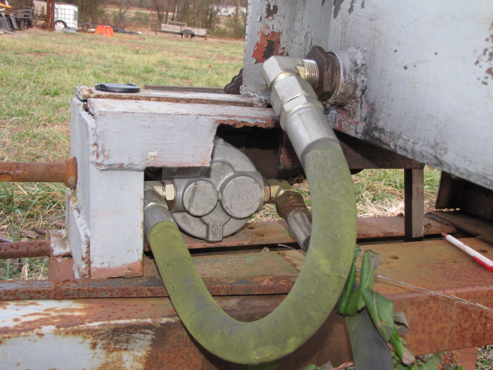

I still think the intake is just chocked down to much and my guess the pump is the 07 pump. If it is then the pump is ok. I have a cross on my log splitter and the intake hose is 1" and pressure is 3/4". The pump is about the same size as yours.If your valve has 1/2" intake then chock it down there not at the pump. Here is a couple pictures.
BTY I am turning my pump CW, that is why the intake is on that side.
If this is true than I had the in/out setup correctly regarding the tank and valve.
