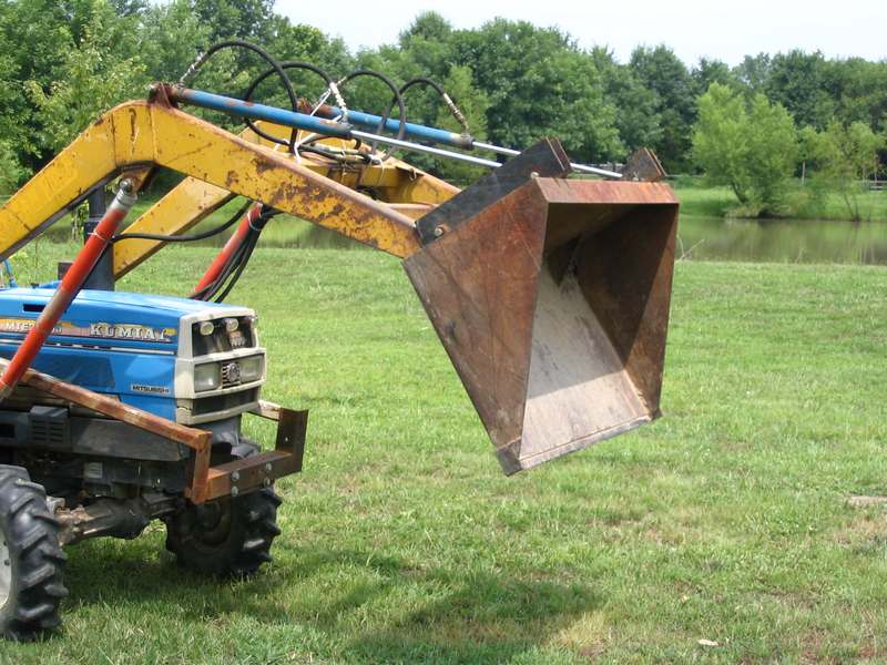

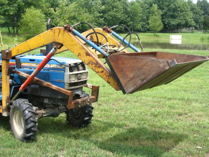

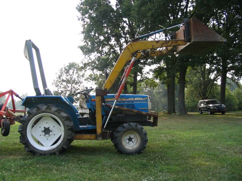

Finally some pics.

I can see why you want some weight on the back. The buckets a long way out in front! Doesn't look like youve got much curl or dump on the bucket. Might be able to fix that by moving the bucket ram pins down 4 or 5 inches.
   / Loader questions and how much is too much? #23
That is out there a ways. Your lift rams also don't initially look like 73 degrees from vertical. That steeper angle will increase your available torque at the arm pins, and the your lift force at the bucket. Eyballing it in the first pic, it looks more like 50-55 degrees from vertical. I already have your arm pin to cylinder attach point dimension. If you can get me the distance from arm pin straight down to the lower cylinder attach pin, I can re-calculate the availabel lift force.

I attached some pics of roll back and dump. The first pics really didn't give an idea of the actual angles of each. I think they are adequate but really don't know how far loaders roll or dump.
Ron wrote: ""That is out there a ways. Your lift rams also don't initially look like 73 degrees from vertical. That steeper angle will increase your available torque at the arm pins, and the your lift force at the bucket. Eyeballing it in the first pic, it looks more like 50-55 degrees from vertical. I already have your arm pin to cylinder attach point dimension. If you can get me the distance from arm pin straight down to the lower cylinder attach pin, I can re-calculate the availabel lift force.
I remeasure and your right, it wasn't 73 degrees. I had used a triangle square against the upright last time and eyeballed the angle and arrived at 73. Used the same method this time but used a 3 foot straight edge to parallel the cylinder and extend the line across the square and it is actually 65 degrees ( sorry about the misinformation) :eek: . Both times it was with the loader fully lowered. In the original pic with the loader slightly raised it probably is closer to 50-55.
The distance from the arm pivot pin down to bottom cylinder pin is 29 1/4".
Yes, the bucket is way out there. The tractors wheelbase is about 60"-about the same distance as the front axle to center of the bucket. While I have no idea what the original loader was on or designed for, I assume it was a tractor roughly twice the HP as mine. Even after removing length from both ends of the arms, it is more than my tractor needs. I had to shorten both the lift and bucket cylinders (the bucket cylinders were originally 65" w/41" stroke-YIKES). I should have shortened the lift cylinders more than I did and positioned them differently but hind sight is 20/20 isn't it. I guess I could always shorten the lift arms and cylinders in the future and maybe I'll consider that this winter when I sand blast/paint it. That will likely allow it to exceed the tractors limitations however...guess I can always drop the pressure on the relief to counter act that though.
Thanks Ron.

With the bucket in the position in the first pic you posted(bucket about 1' off the ground), and using those dimensions, your cylinder angle is about 55 degrees from vertical referenced to the arm pivot and upper cylinder attach point. That gives you a lever arm of around 22" or more than double the 73 degree calculation. Using the numbers from the last calculation, 10,681 pounds of cylinder force X 22"/1.833' lever arm equals 19,581 FT/LB of torque at the lift arm pivots. Divide that by the 77" or 6.42' distance from arm pivot to bucket pivot equals 3050# of available lift at the bucket pivots 1' off the ground. It will be less with the bucket on the ground, perhaps 2700#, due to the cylinder angle. The lift force will peak at approximately 3600# when a line between the arm pivot and the upper cylinder attach pin is perpendicular to the line between arm pivot and lower cylinder attach point(50 degree cylinder angle, 26" lever arm). I am guessing that would be with the bucket about 2-2.5' in the air. The available lift force will decrease from there with loader elevation and decreasing cylinder angle.
Is that tractor front end easy to get parts for? I would lower the safety so it has trouble lifting a full bucket and won't lift a heaped bucket. Another way to set it up would be to inflate the tires to rated pressure and set the relief so it can't lift more weight than moderately squishes the tires. Afterall it is a tractor not a loader.
Shortening the arms would allow more weight in the bucket with less stress on the tractor front end.
Good Luck.
