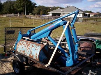

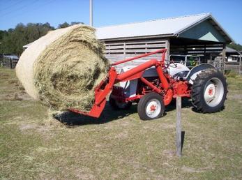

Here is a 660 i own with a ford 722 front end loader. it's a 1-arm job.
Uses the built in hydro pump on the tractor ( 4gpm ).. is hyd up, and hyd tip/curl... thus it needs a dual spool with one DA, and one SA port. The dual valves that fit the top cover of the hundred and thousand series fords are still available.
I am in the process of purchasing an 850 to drop another 1-arm loader on, a 711.
Here's a pic of the 722 on my 660 lifting a bale of hay..
Then a pic of the 711 as i bought it from a junk dealer.. and how it now sets.. waiting for a tractor to hang it on..
