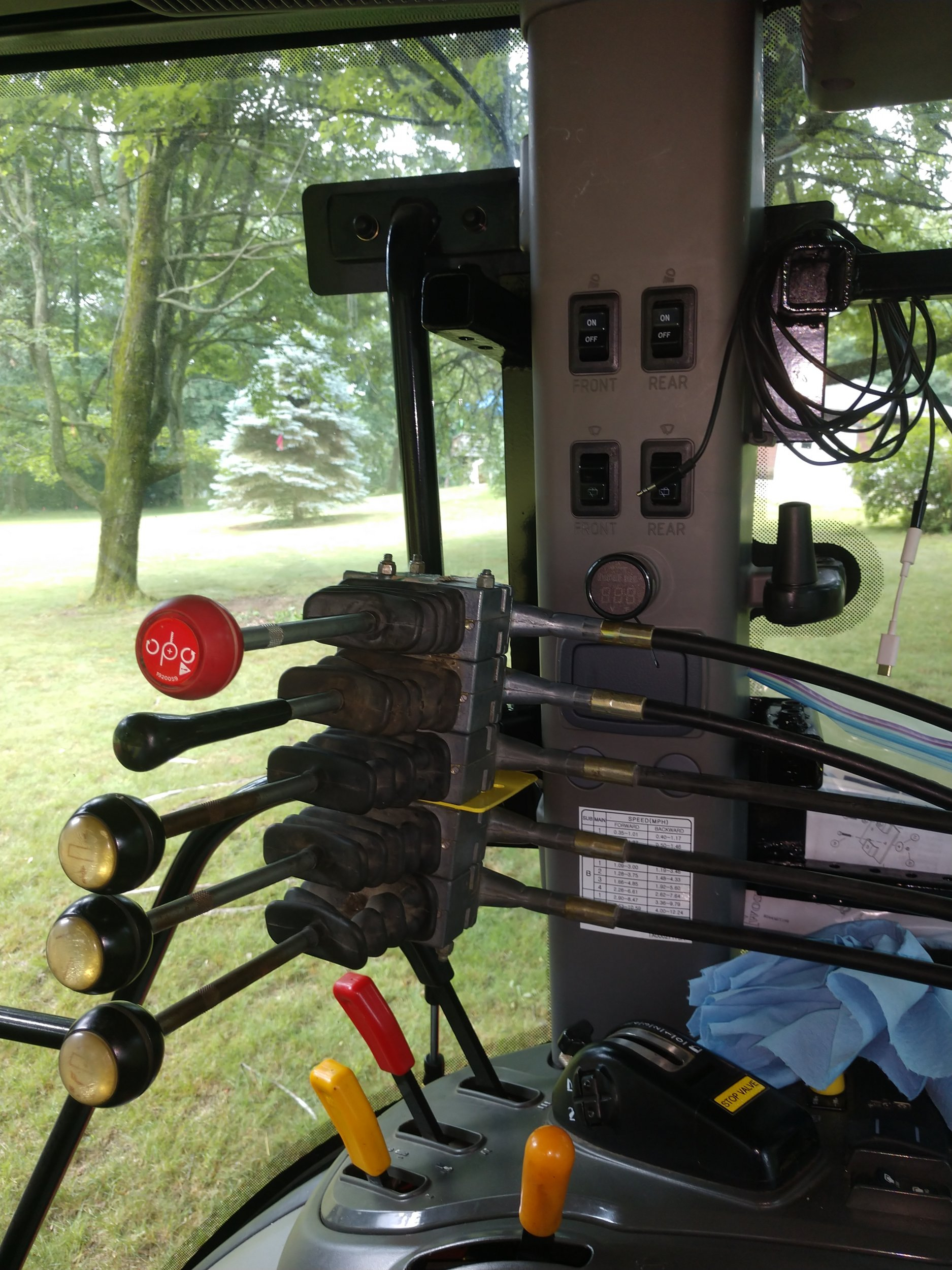

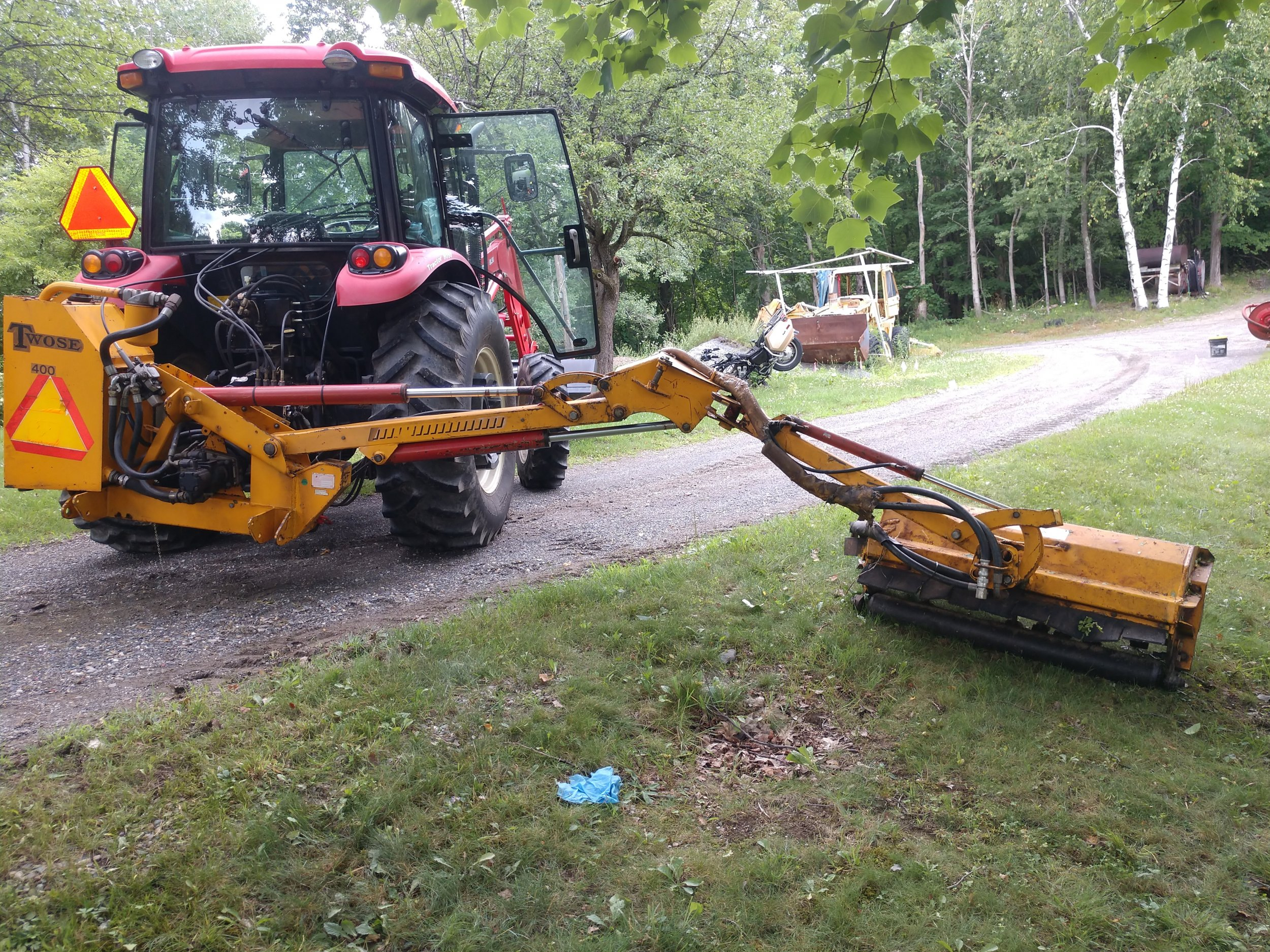

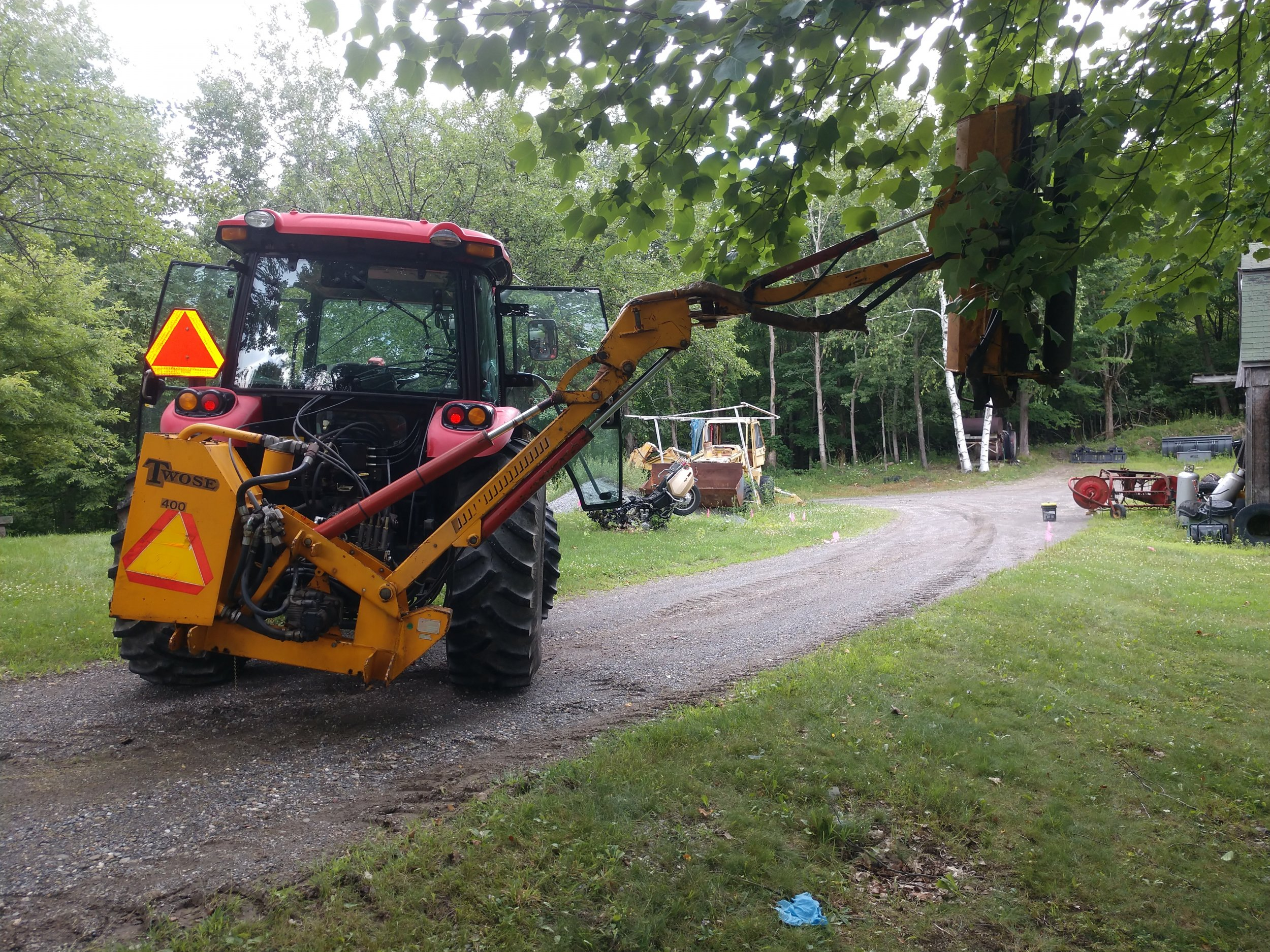

/ Loader Mounted Swing Arm rotary Boom Mower #10
My 3 point boom mower has a 3- 1/2 foot flail head.
It has dual dedicated pumps on it one just to power the cutter head, and another for all the controls.
My tractor tips the scale at just over 11,000 pounds there is no way I would want that weight on the front of the tractor.
Even at the rear it will bounce the tractor all around especually when the mower gets boomed out on the down hill side.
These are the 5 control levers to run the mower
/ Loader Mounted Swing Arm rotary Boom Mower #11
That’s a nice mower!
/ Loader Mounted Swing Arm rotary Boom Mower #12
I like it. it's very handy. It is heavy and a bit of a bear hooking up. It mounts so close to the tractor that it is hard to get in and connect the pto shaft. I actually stop backing just before I get to it and slid the pto shaft on then back up a bit more and try and reach in and latch it, then back into the mounts. When I disconnect I unhook the lift arms and top link then drive away and let the shaft pull apart then disconnect and reassemble it. I need to put it on this month and do some trimming in the hard to reach places and prune the lilacs down a bit(3 feet).

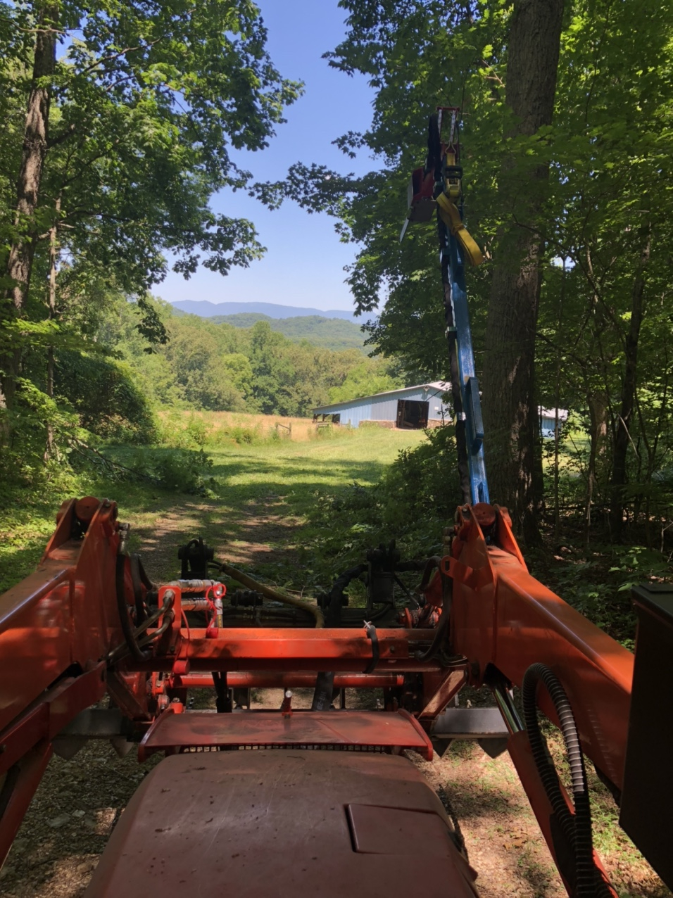

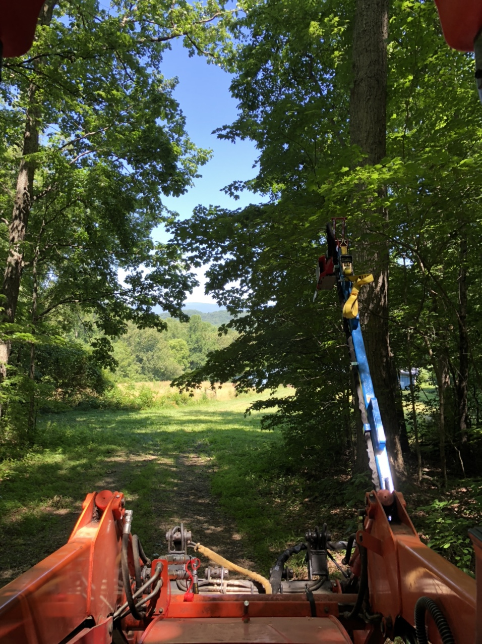

Hadn’t seen a mid mount mower that could be taken on off easily. Most are permanent mount without a loader.
Have yet to meet someone who has bought a county mower and used it as a mower. They take off the mower and try to use it as an ag tractor with mixed success.
Different parts of the country have different tree, shrub growth and clearing needs. It’s a jungle here.
Newly made hydraulic polesaw with grapple and rotary cutter has opened roads and cleared around fields this year.
Thanks for your t houghts an Pictures.
