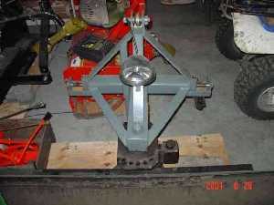

At one point I found pictures of a FEL that someone had mounted a rear blade to. Does anyone know where I might find it?

The John Deere 419 FEL has a blade attachment (bucket drops off, blade goes on) that has the appearance of a rear blade mounted on the loader frame.
I expect the the other Deere FEL's have a similar attachment.
/ loader mounted blade #6
I mounted a rear blade on my loader arms too. Removed the bucket and cylinder, mounted the blade, and even used the bucket cylinder to angle the blade. Works great. I windrow the snow as much as I can, then turn around and hit it with my snow blower. I'll try to post a couple pictures, but at this moment, do not have the blade installed. The width was almost perfect for the loader arms.

Testing photo of my blade

OK, I think I got the hang of attaching a picture, so I'll explain further. The loader arms attach to the blade via two bolts that are the same diameter as the bucket pins. The bucket cylinder is removed, and a top link is installed to hold the position of the blade. In this picture, you can see where the bucket cylinder is attached (I apologize, I have the bucket on right now, so you cannot get the full picture.) I had to lengthen the hydraulic lines on the cylinder to accommodate the new position. The angle feature works great.

Thanks for the link. Nice job on your universal FEL mount. I like your thinking. G
/ loader mounted blade #14
There is a post from last winter in which I mounted a pickup truck blade to the loader. If you want to plow snow it is great.
