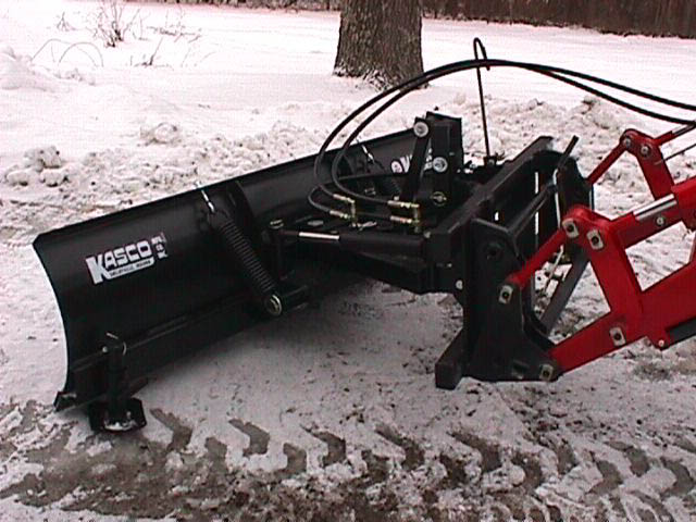

I don't know what the experts like to use, but a couple I've heard of for tractors is Curtis and Kasco. I bought a Kasco at the tail end of winter here, and didn't really get to use it much. I don't have a skid steer mount, however the Kasco has brackets made specifically to fit my Branson quick attach loader. It's a 5 minute job to put it on. I got it so I could keep my backhoe on if I wanted. I use chains on the front tires to navigate my hills. Kasco is in Indiana.

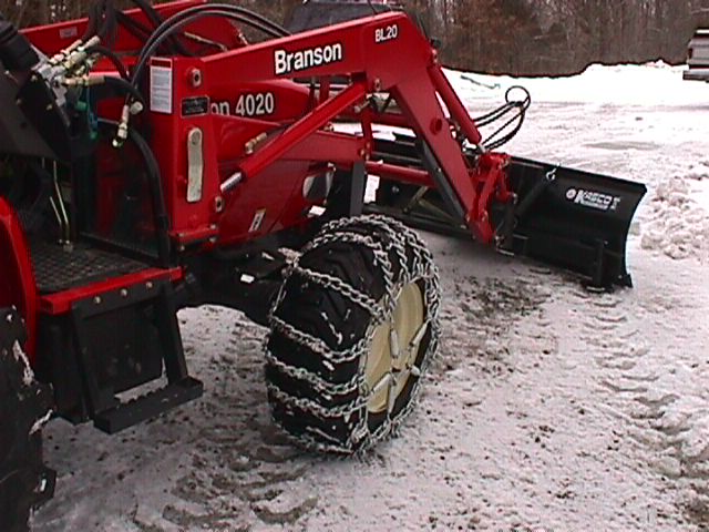

Also, this plow is pretty heavy...about 600 lb....so a rear blade is not nearly heavy enough to offset the weight...unless you have a way to add weight to the rear blade....eg I've seen some people weld brackets and put hanging weights, or even use bar bell weights on the rear blade. Weight is good on a plow though, as it helps in digging off the crud. Makes me wonder how well the polycarbonate plow would work...as seems it would be light.
