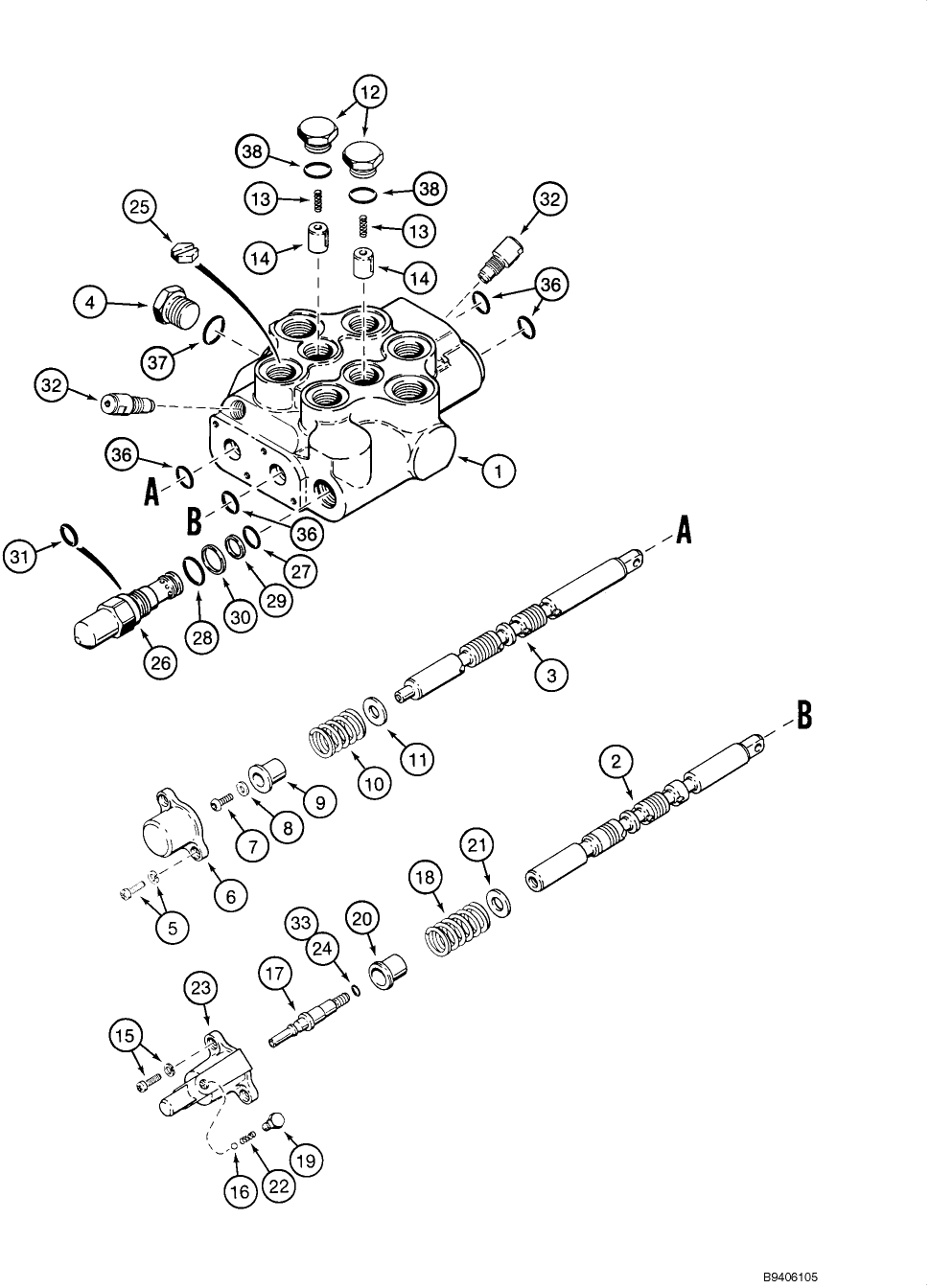

I am looking at a valve that has a spec of 15ml/hr at 120bar. That is 0.5oz/hr at 1740psi. How does that compare to what you guys would consider as normal?

The precision is a double-edged sword. The more precise is the match between the valve body and the spool the more it is sensitive to dirt. I work with hydraulic actuators for steam inlet valves for steam turbines. The turbine oil is filtered and kept clean to pretty high standard but since the components of the positioning of the actuator are very precise they require additional filter that will catch particles measured in fraction of microns.
(1micron=0.0000394")
I suppose the tractor components design is a compromise between dirt tolerance (dirt in this context is a relative term) and perfect function.
I know few things about hydraulics in general but I am not an expert on tractor hydraulic. Having the disclaimer out of way I would propose a test.
Provided that one spool is not passing I would swap the hoses between bucket curl and FEL lift. If the bucket uncurls and the lift stays then it is the spool valve. In opposite case it is leaky cylinder. I think it could work.

Do you mean to say that the bucket is pulling on the curl cylinder enough to tilt the bucket down, and was the bucket loaded or unloaded? Does this occur with engine on, and off. A good test would be to lift a load of dirt up in the air, leave it for 6 or 8 hours and see how much the lift arms or bucket move.
/ Loader Leaks Down #30
I am reluctant to stick my nose in this, but I just can't help it.
Acceptable spool leakage is determined by a set procedure and measured in cc's.
System pressure should be at 1000 psi and oil should be 100 degrees. You have to measure the travel of the cylinders and not the loader bucket. The amount of travel in the loader bucket is all related to geometry. The valves of today are heads and tails better than the valves of yesterday. As someone else mentioned, the more you tighten spool tolerances, the more other issues you have to deal with. There is no valve that will not leak down at all. The problem people face is that they say my old loader did not leak down.... Well it did, but the loader design and cylinders sizes made it not stick out. With today''s MFWA tractors, loader engineers are having to use shorter, fatter cylinders and way different geometry to achieve the required specs AND stay out of the front tires. 10 cc's of leakage in today's loaders is WAY more noticeable than one 20 years ago. The amount of acceptable leakage is high mainly because people normally have to measure cylinder travel over a period of time and there is a large margin of error there. 1/8 of inaccurate measurement over a 10 min time frame makes for a large displacement difference. Anyone that would like an actual written out procedure for leakdown testing is welcome to PM me and I can email you one. You will have to find out your cylinder specs however and calculate your own displacement figures. Our chart is setup to tell people the allowed travel since we already new our own cylinder designs.

It almost has to be a valve leaking, and you can test this. With the bucket down, disconnect the hose to curl down cyl. With the engine running, and the valves in neutral, there should be no fluid coming out the hoses. Have the hoses above the level of the valve. Do the same for the lift cylinders. No fluid should be coming out the hose, in neutral. It might get messy, have a container close by.
