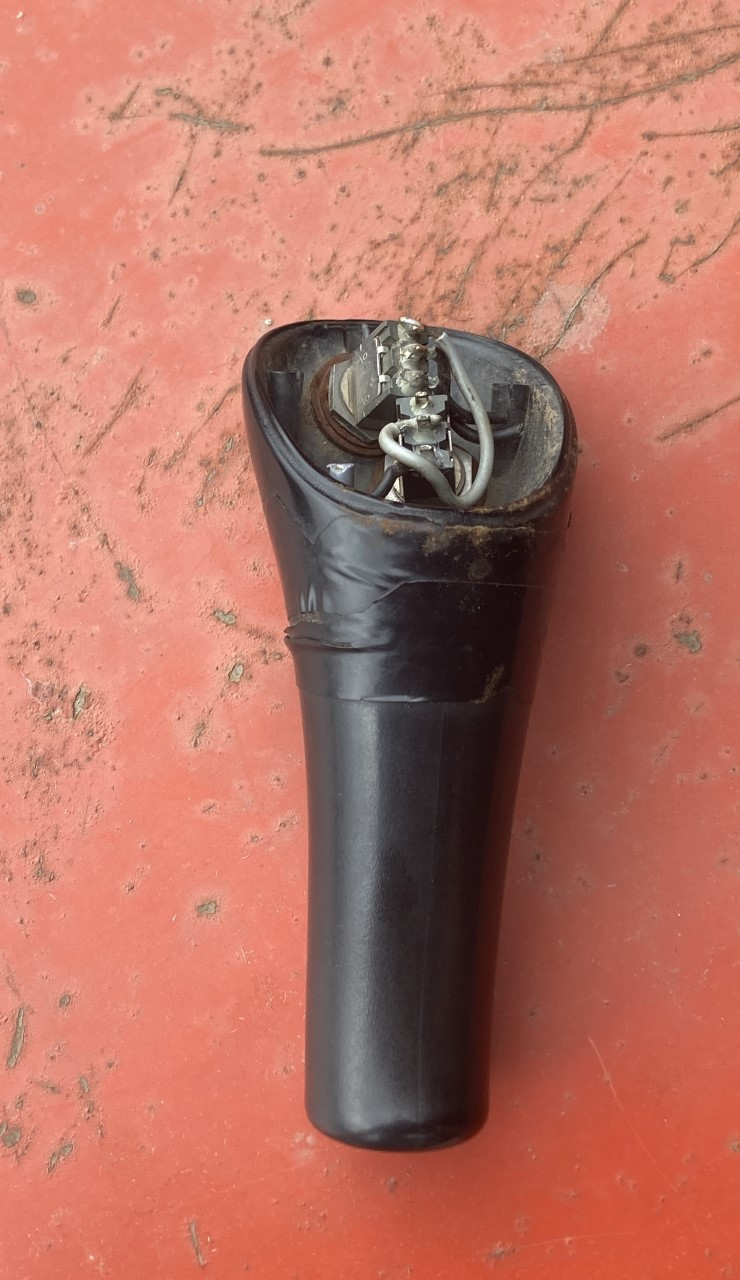

The company tractor is fitted with a Quicke loader. The joystick had seen better days- it was missing the top cap and I was getting tired of nicking my palm on the exposed terminal ends. I searched and searched for some sort of farm tractor replacement grip. I found a grip for a Koyker loader on Shortlineparts.com, but wasn't too excited about spending $75 plus freight.

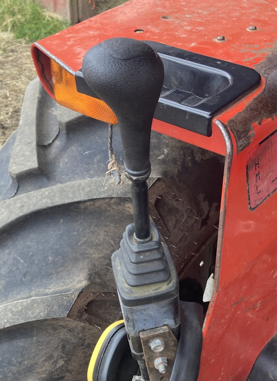

Then I came across this Mercedes W190 style shift knob on ebay for $15 and took a chance on it.
It had the shift pattern imprinted in the top of the knob, but one pass with the propane torch and that faded away. I drilled out the insert on the knob and tapped it to match the Quicke joystick thread and wallah!
I should say, this Quicke joystick did have some auxiliary buttons on the bottom side, but our machine doesn't utilize them.
Hoping this helps someone out!

Nice fix, good thing you did not need the buttons,
