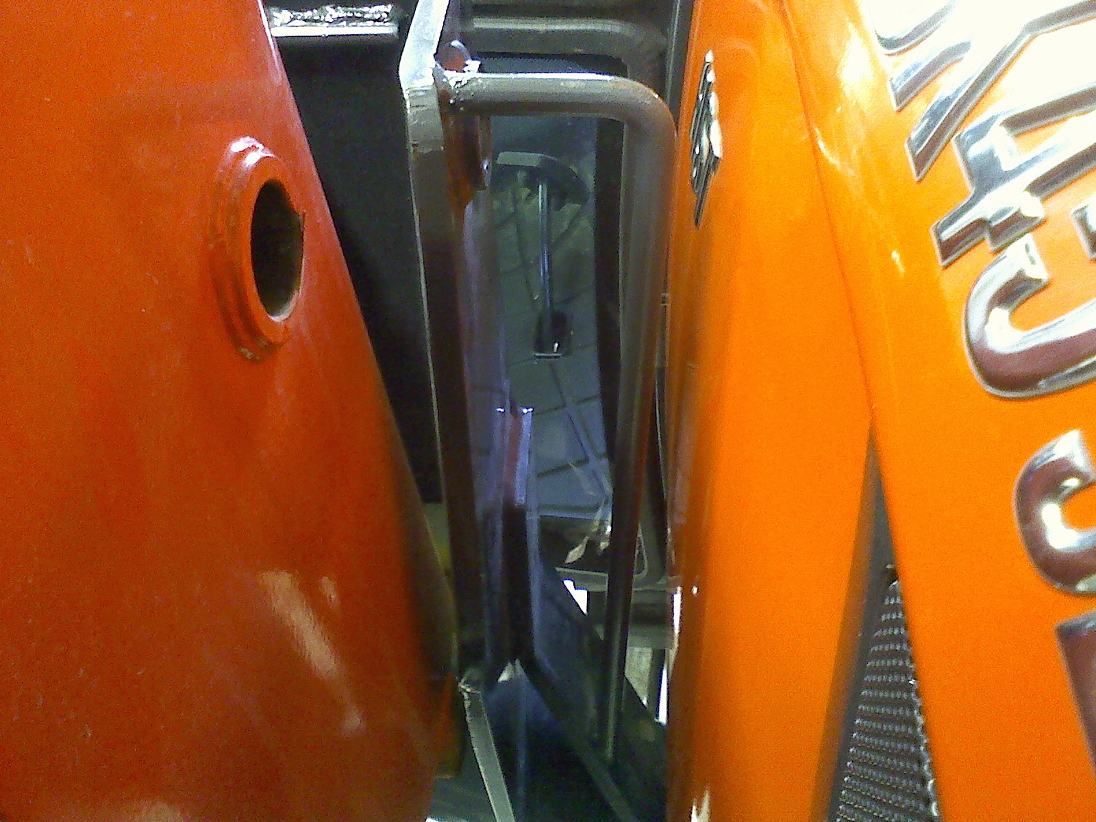

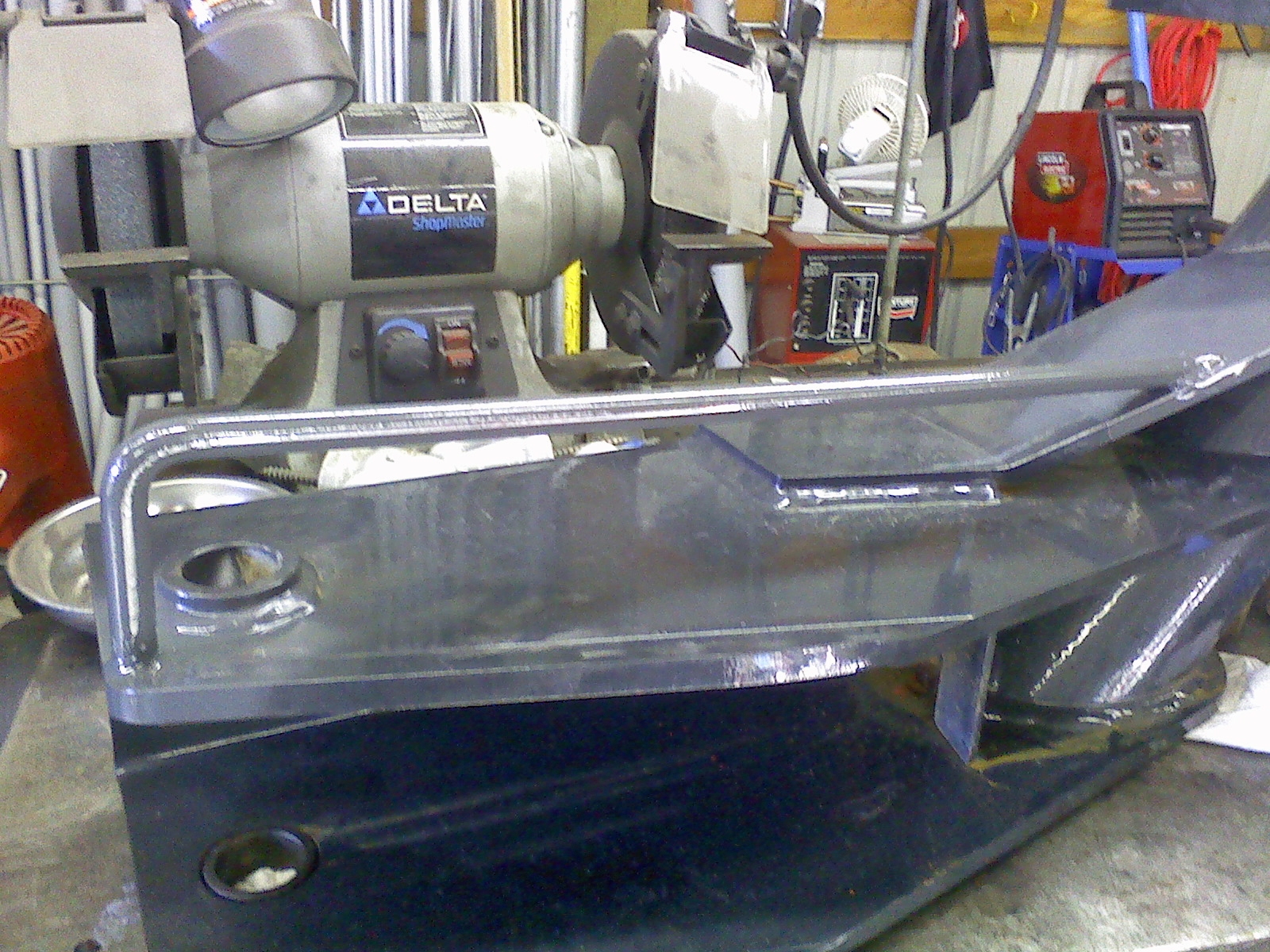

i added a weld on bracket to mine, as it was rubbing the paint off. i cant find any pics showing the 6 hoses running thru it, but this did keep hoses from rubbing on side and hood.
