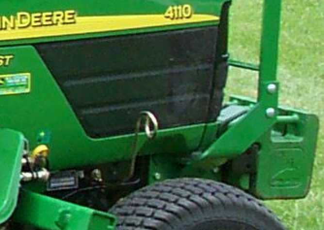

There is also a hose guide available. It shipped with the front hitch for my 54" plow. I have attached a zoom pic to give you an idea of its use on the 4110. Sorry--can't find a part number
   / Loader hose question
That's too far forward to work for the CX200 on a 2305. There is one on there already, but I'm going to look it over to see if one of those can be added to help.

I didn't explore whether there was another mounting point closer to the hydraulic quick-couplers on my 4110, but it might be worth looking at on your machine. I'm sure there is an adaptation or mod that would work for the 2305.
