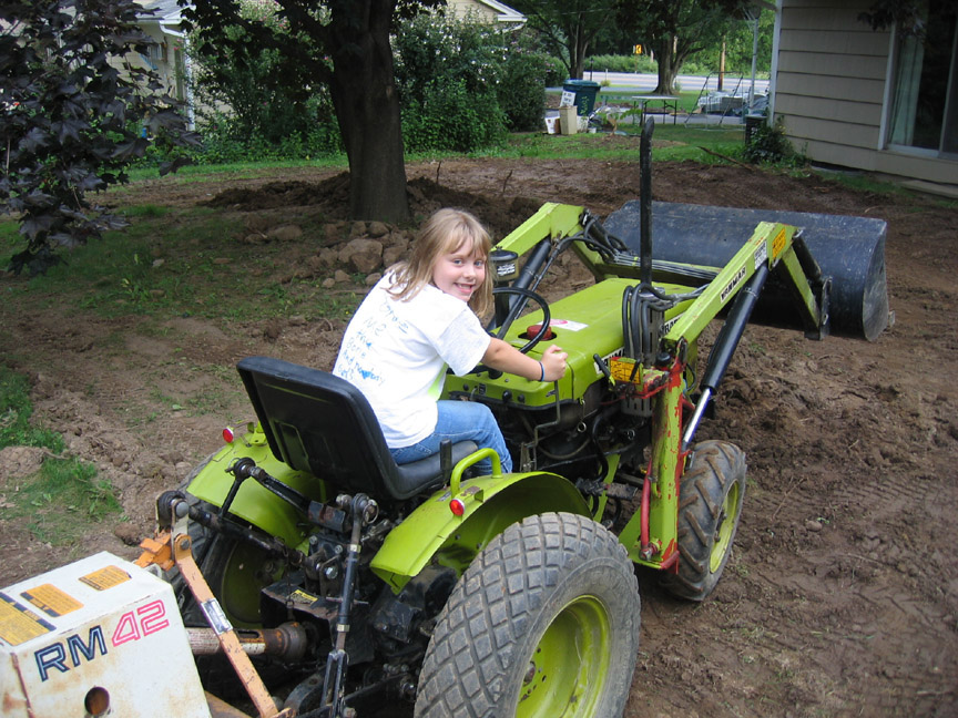

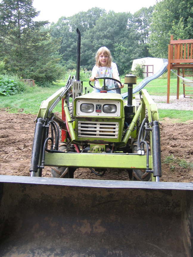

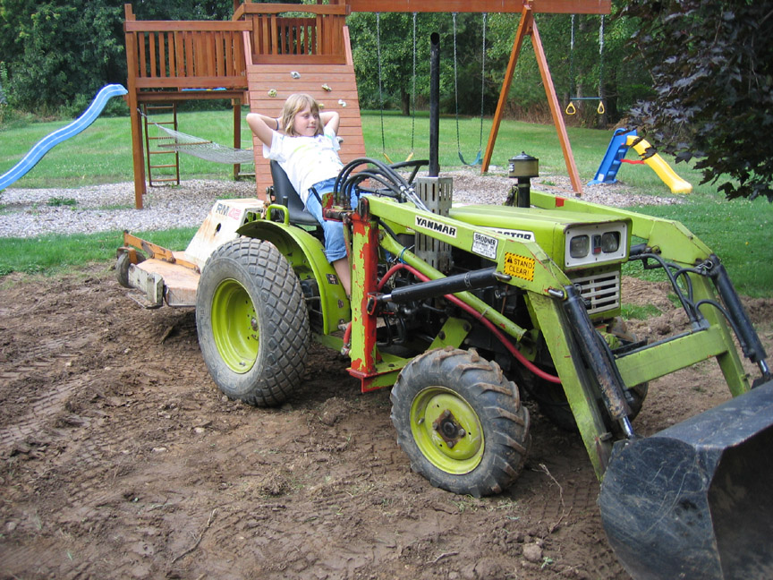

Hello Hard Knocks,
I believe your 1300D is similar to my 155D. It came with a loader that I think is the stock Yanmar YFL-155 loader. I imagine it would be hard to find used. I do appreciate the compact size of the machine overall and the rounded bucket which make material less likely to get stuck in the corners.
