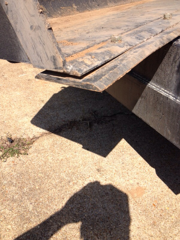

I bent the end of my bolt-on loader cutting edge. I tried heating, straightening with a o/a rosebud, but not too successful.
Should I just leave it off? I don't really use the loader that much for grading. No asphalt or concrete to scrape. My old 4500 tlb survived for decades without one.
I don't want to wear down the bucket either, the machine's only a year old.
I am considering a piranah blade to aid in pulling out Jap barberry sometimes in the future.

Why not just buy a replacement cutting edge, and have someone weld it on?
I bought a new 66"x1/2" edge from an online seller for $150 delivered, last year.
Get a professional to weld it on though.
It needs to be very carefully, and slowly, "skip welded" to avoid buckling.

Take it to a shop with a press and pay to have it straightened

Bent mine a while back, I just used a press and straightened it. After I bolted it back on I welded the edges to the bucket, just enough to add support to the ends of the cutting edge.

I bent mine like Countrybumpkin, and had my dealer drill two more equidistant bolt holes closer to the bucket's edges, (one for each side) and bolted it in place. I'd keep it and use it if you have it, no sense messing up the OEM bucket edge, and it sure does add rigidity to the entire bucket for digging, back blading, etc. I wouldn't go back to not having it. When I found out it was available I immediately got one.
Adding the bolts will keep the bending from repeating, and it's still reversible, in case I live long enough to need to.:thumbsup:

I couldn't straighten the bent and twisted end of my cutting edge. I ended up cutting off 10" and splicing in a new peice of flat stock. I beveled it to match. Drilled a 1/2" mounting hole and ground it somewhat square. This time after it was mounted I welded the edges to my bucket.
The original designed of having the end mounting holes away from the edge is the reason for failure. Two tack welds on the ends are needed, and anyone with a bolt on cutting edge should do this.
