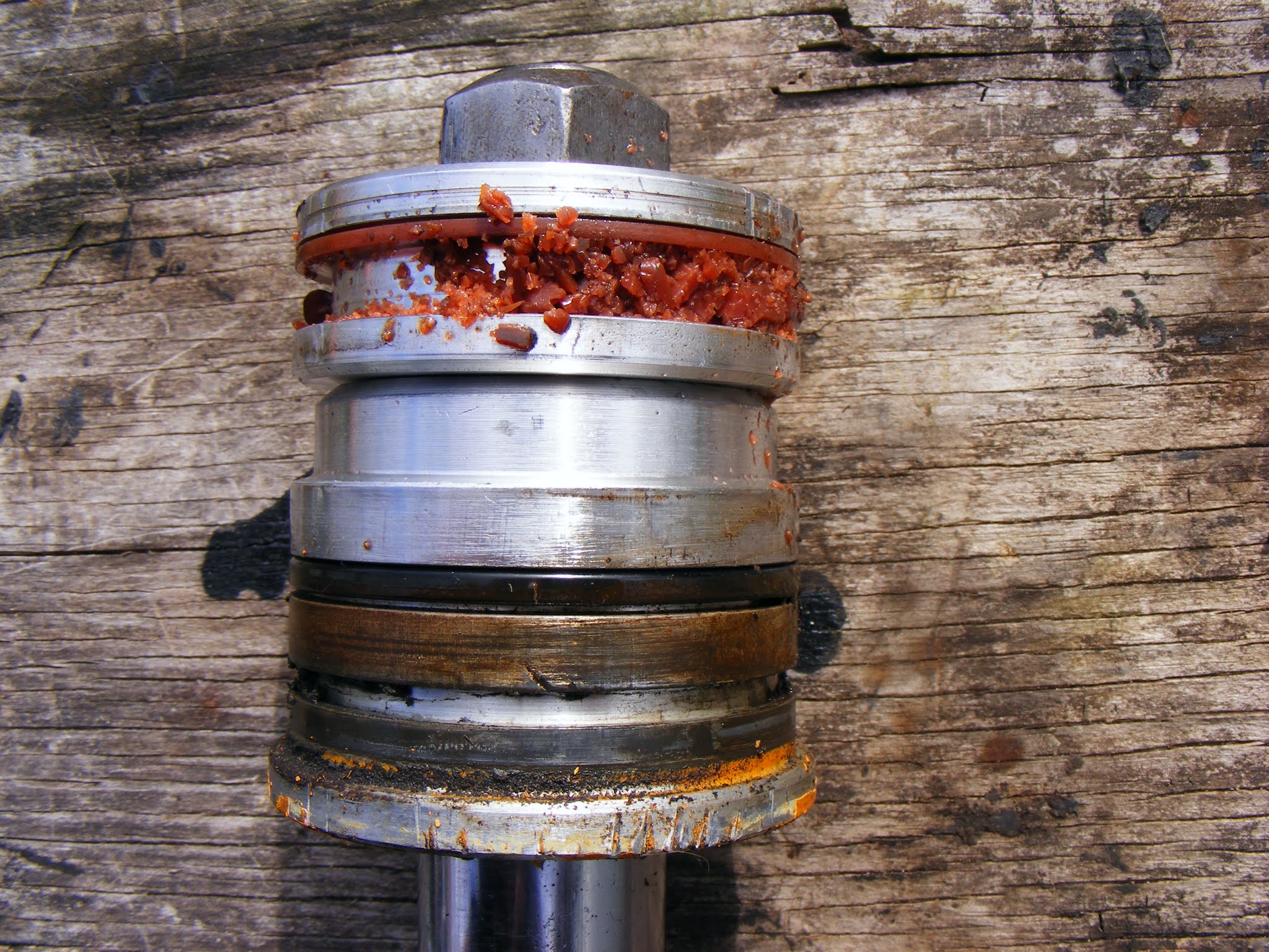

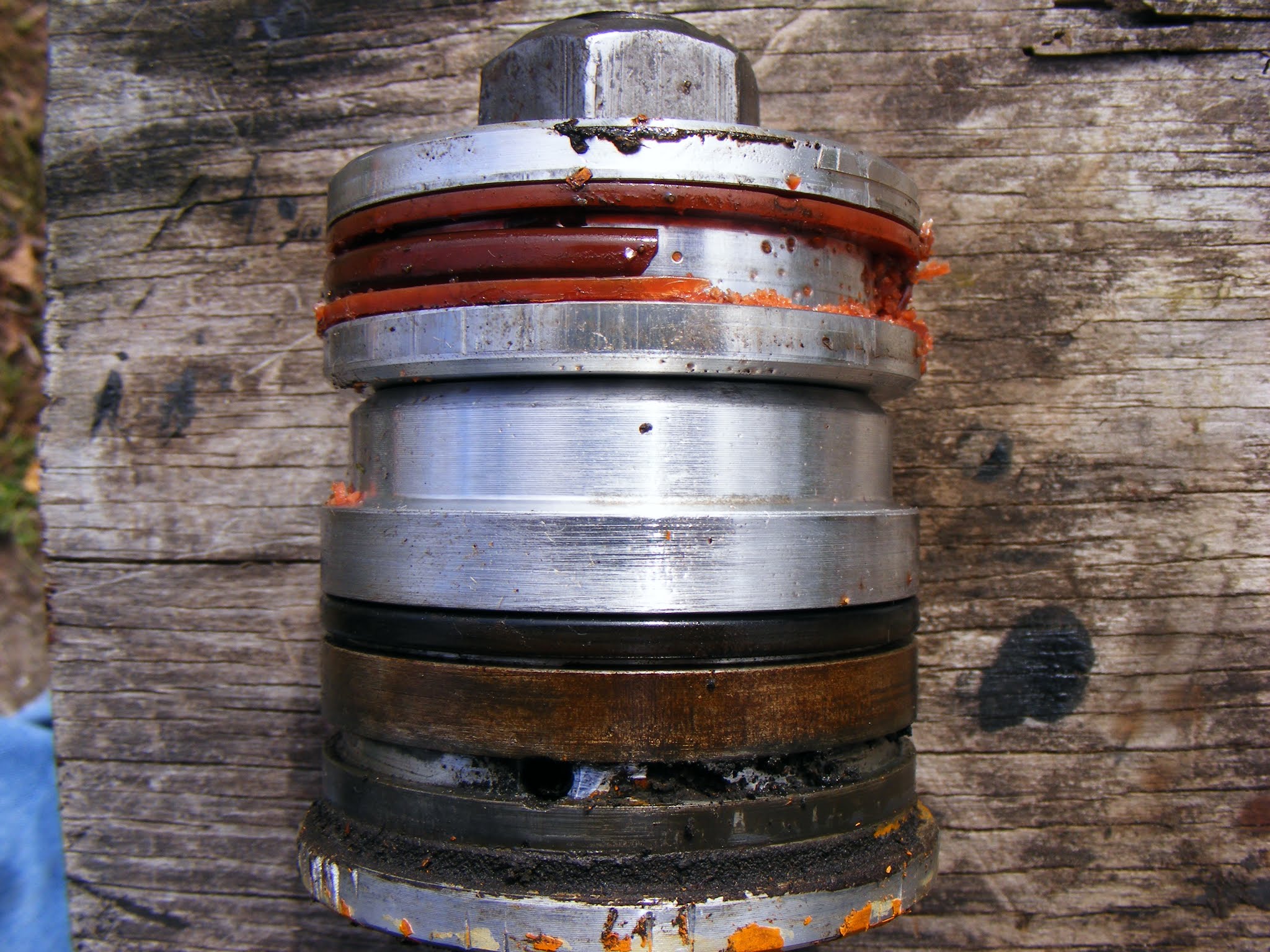

I had that same problem with my loader, it would go down just as fast as it went up and it was the seals. In my case it was just O Rings and shims and wiper seals at the cost of $15 for three cylinders. I think mine had been rebuilt with the wrong O Rings and were not ment to be in oil , who knows, but they came apart in my system which uses ATF type F . DSCF0441.jpg Not a hard job to do but messyDSCF0442.jpg

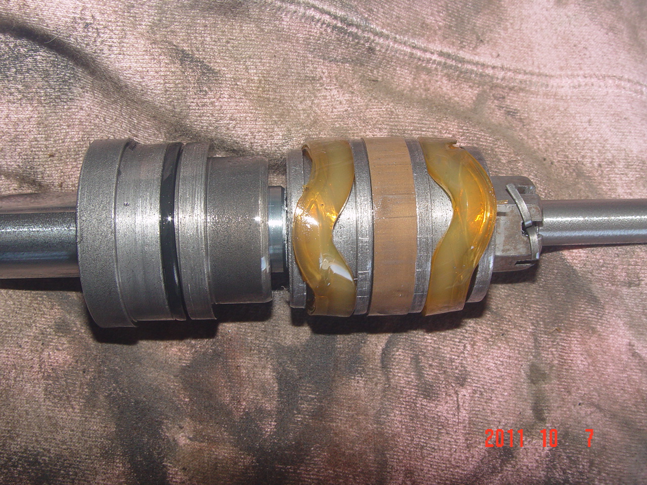

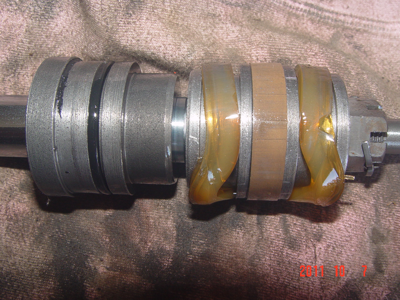

When I rebuilt mine on the Case Loader I did not remove the hoses, I did not remove the cylinder from the loader, I removed the pin on the bucket end then the clip holding the head on the cylinder, used a piece of pipe 2 foot long through the hole the pin came out off and pulled the ram out. Remove the nut from the end slide everything off and start replacing all the rubber parts. I always take pictures of what I am doing every step so if it can go back together two different way I can look at the pictures and pick the right one and also share with someone that need a little moral support. I drove a desk for eight years and I enjoyed fixing or trying to fix things more then .
