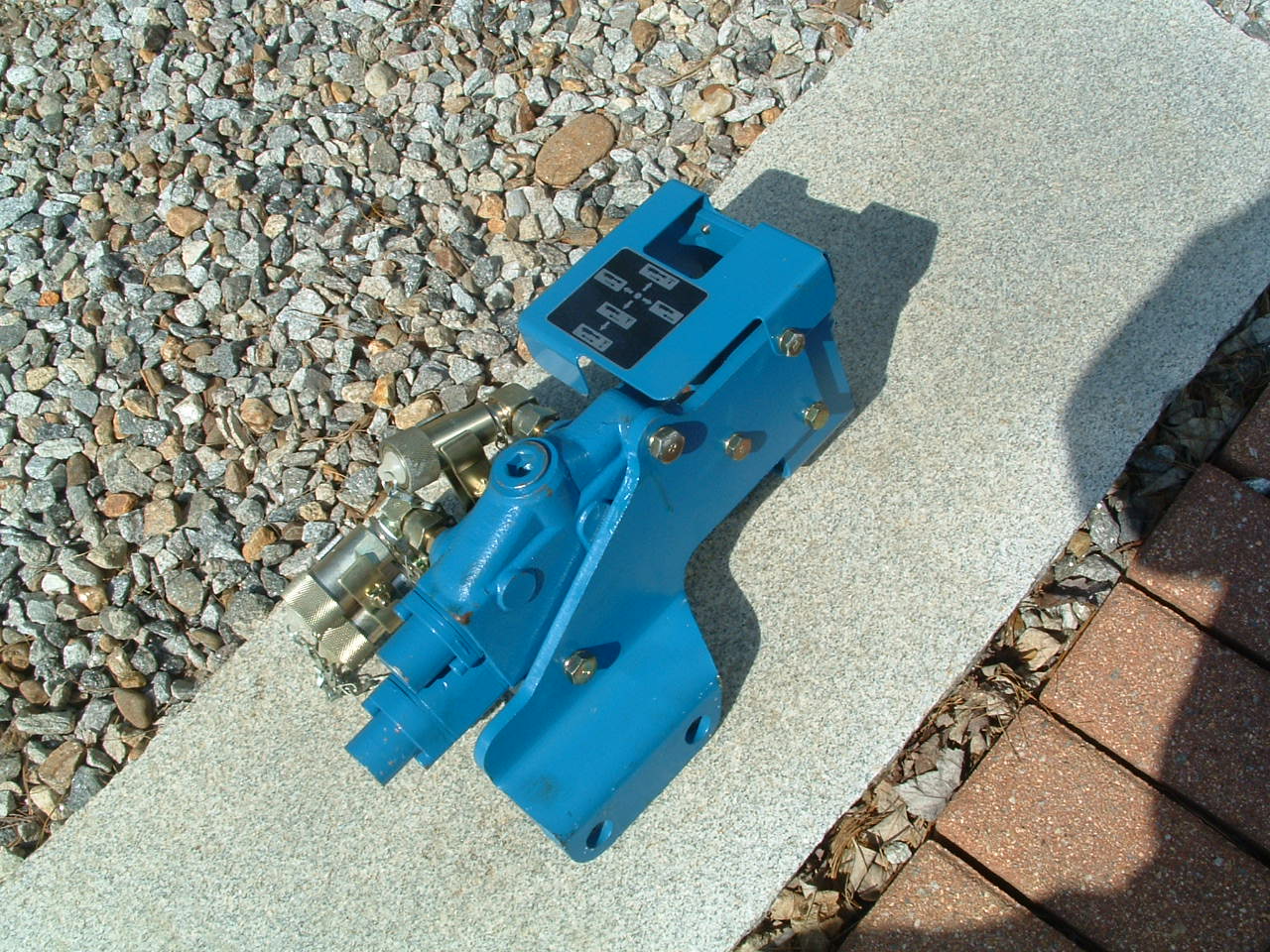

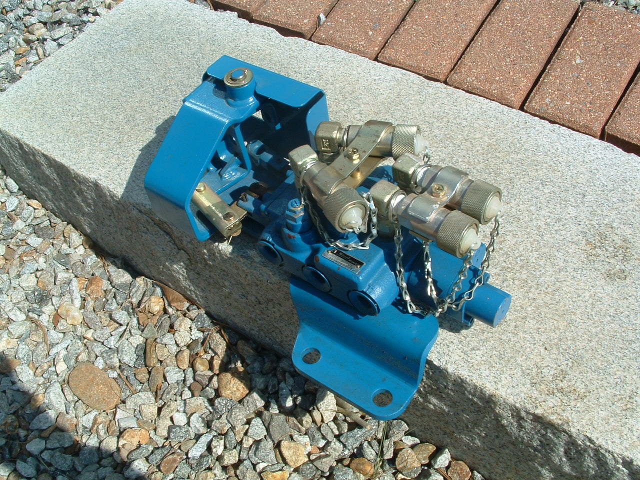

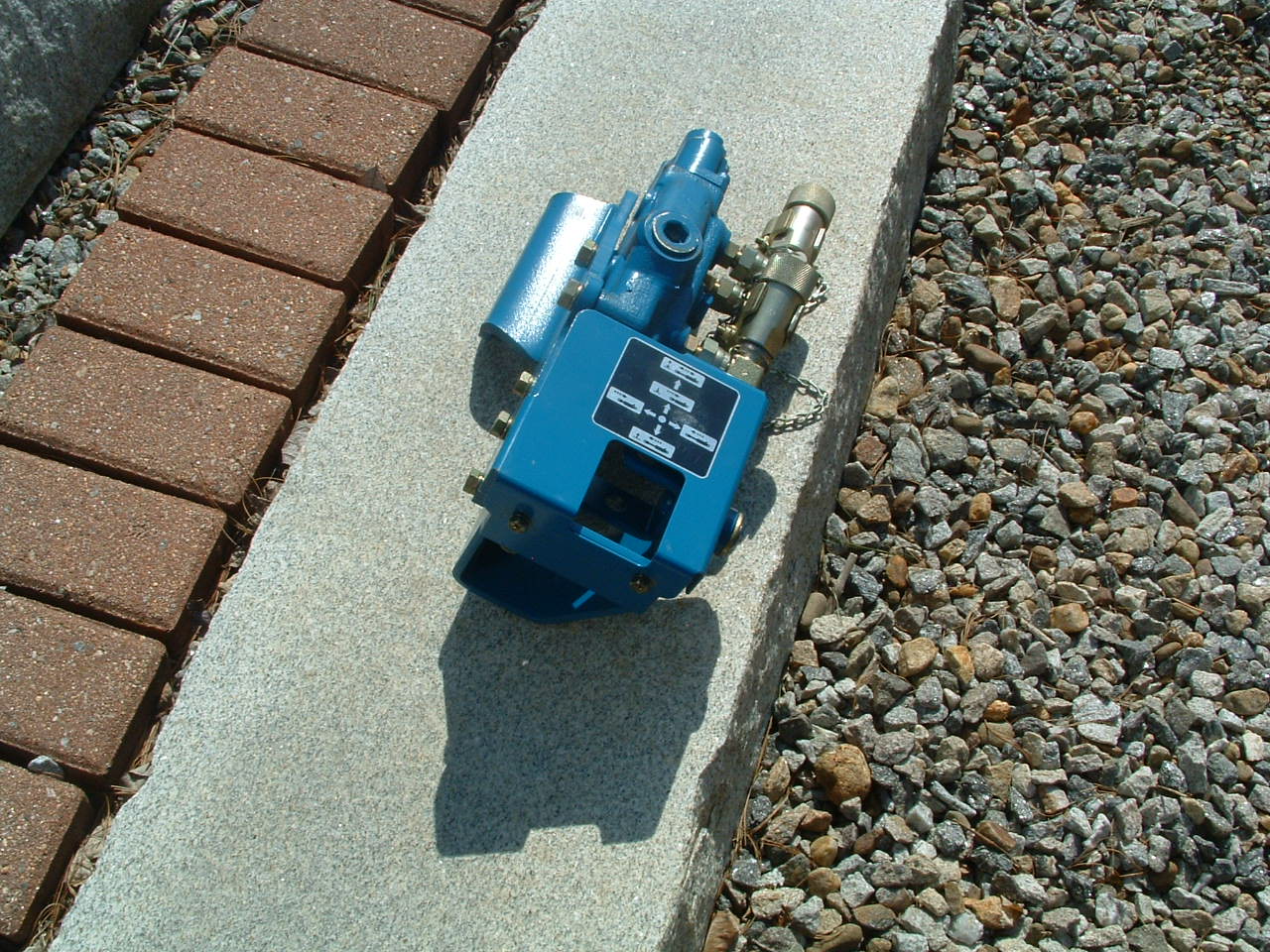

Can anyone tell me just what model & years this Ford/New Holland loader control valve fits? I bought it years ago to convert my Ford 1715 to single lever but never did the deed. No luck on a web search and the local dealer was no help. The ID plate shows: Diesel Kiki, made in Japan, (SN) 75005, P=142, Assm. No. 307800-0320.

What difference does it make what model tractor it came from? If it has power beyond(three system ports, pressure, return, and sump), has a built in relief valve, it should work.
/ Loader control valve
I finally nailed down the application with advice from a local New Holland expert (and found it on the Messnick site). I didn't explain myself too well in the first post Harry, but I was trying to find the info to help sell the valve. I sold the Ford several years ago. You're right, it'll do on most anything you can bolt it to.
