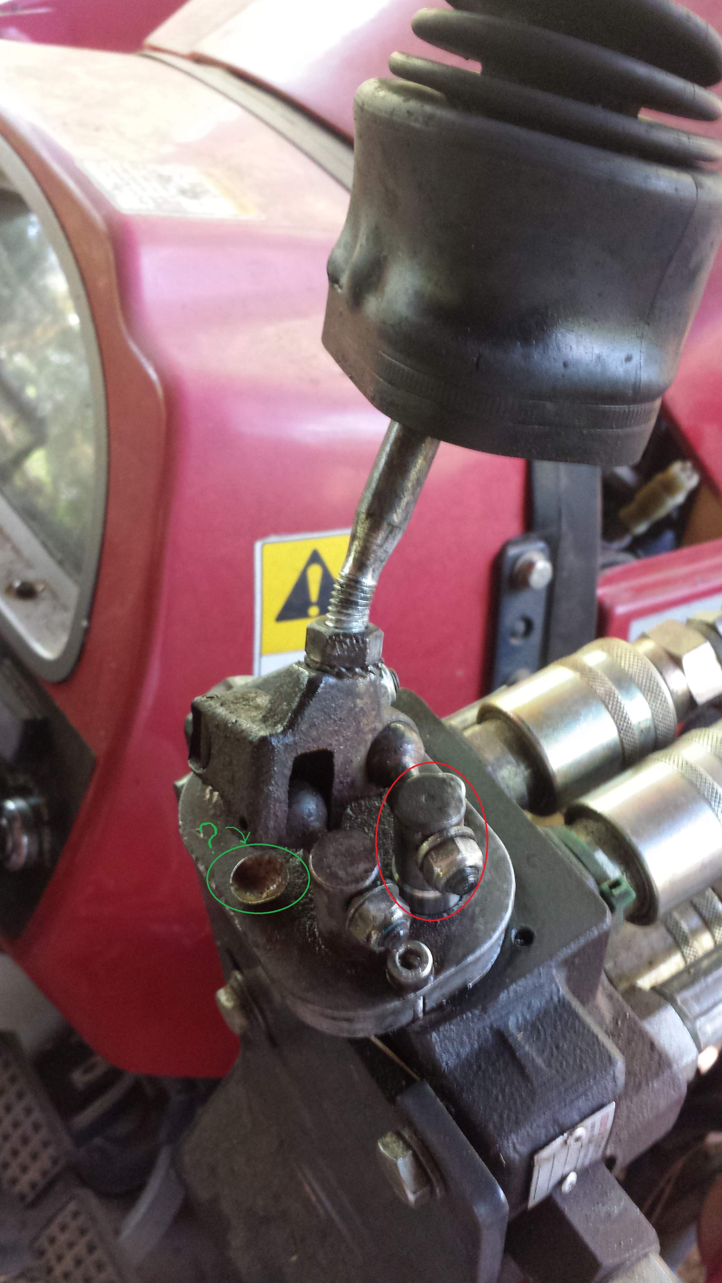

Thank you for the reply. Pardon my ignorance but what is a spool cap? Below is a picture I took when I removed the joystick boot today. The cylinder I circled in red is what I think is the problem. When I try to pull the joystick which should make that cylinder go down and in turn curl the bucket, nothing happens. The joystick will not really go to far left of center. Also, I noticed a small thing shaped like the outer half of a ball bearing (circled in green in the picture). What could this be, and where does it go?

When you say "spools" are you referring to the 2 cylinders under the rubber boot that move up and down depending on which way I move the joystick? If so, the one on the right moves fine (this one appears to lower and dump the bucket depending on whether it is up or down). The one on the left will go up, but it will not go down when I pull the joystick left. I tried pushing it down by hand as well but it would not go down.
Just so I am clear, in the picture below, are you saying to remove the hex bolt (circled in red) and the one on the other side that is not visible in the picture. What I am looking for when I remove these bolts?

When you say spool, I am still not sure what you are referring to. Below is a picture that I took of the control valve where the joystick is connected to it. IS the vertical cylinder thing that I circled in red the spool? If so, this is the thing that is not moving down when I pull the joystick to the left. I cannot push it down by hand either. Its like something is jamming it, but I do not see anything in the picture that would be causing the jam. I think it may be something underneath this cylinder that is preventing it from going down, but I am not sure how to inspect underneath it.
Also, if you look at the picture I also circled a little half ball shaped piece of metal that was just sitting inside the boot. Where could this piece have come from?
I also noticed that the joystick does not return to center and flops around a lot. Could there be a broken spring somewhere? This is the first time I ever looked at a control valve so I am not sure where the spring would even be.

If the spool will not center, then you have to remove the can on the bottom of the curl spool and remove the parts on the end of the spool.
It will have a spring and two spring cups.. If may have some balls and spring for the regen if your spool has regen.

Yes, the red circled part is the spool.....the spring/can/bonnet/balls will be directly inline on the back side of the valve body (underneath)

I went back down to the farm today and took a video (see link below). As you can see when I pull the lever to the right in the video the spool on the right side of the video should lower, but it does not. Is this clearly a problem with the joystick area, or could there be something under the spool that is not allowing it to lower?
I am a little confused as to what possible things could cause the spool not to go down. Even if there was no hydraulic fluid in the system, shouldn't this spool go up and down with relative ease? I am apprehensive about removing the spool caps and having to reassemble springs and bearings.
I did notice that there is a little pin that is missing from underneath one of the circular ball joint things, but I just stuck a nail through the hole for the time being for support and that did not affect any change.
