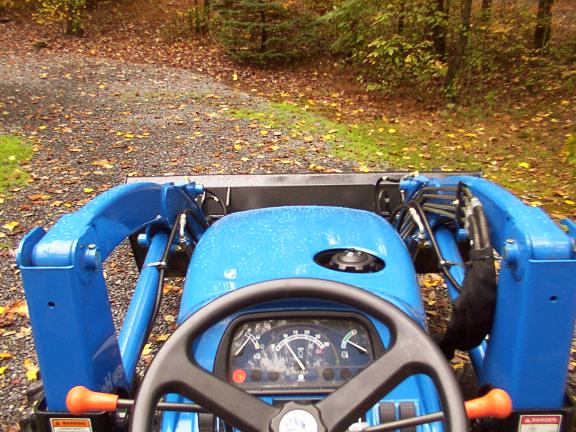

Amen brother! That's why I decided to move up a frame size to the TC48. Here's a view from the top, with that .64 cu. yd. bucket. /forums/images/graemlins/grin.gif
