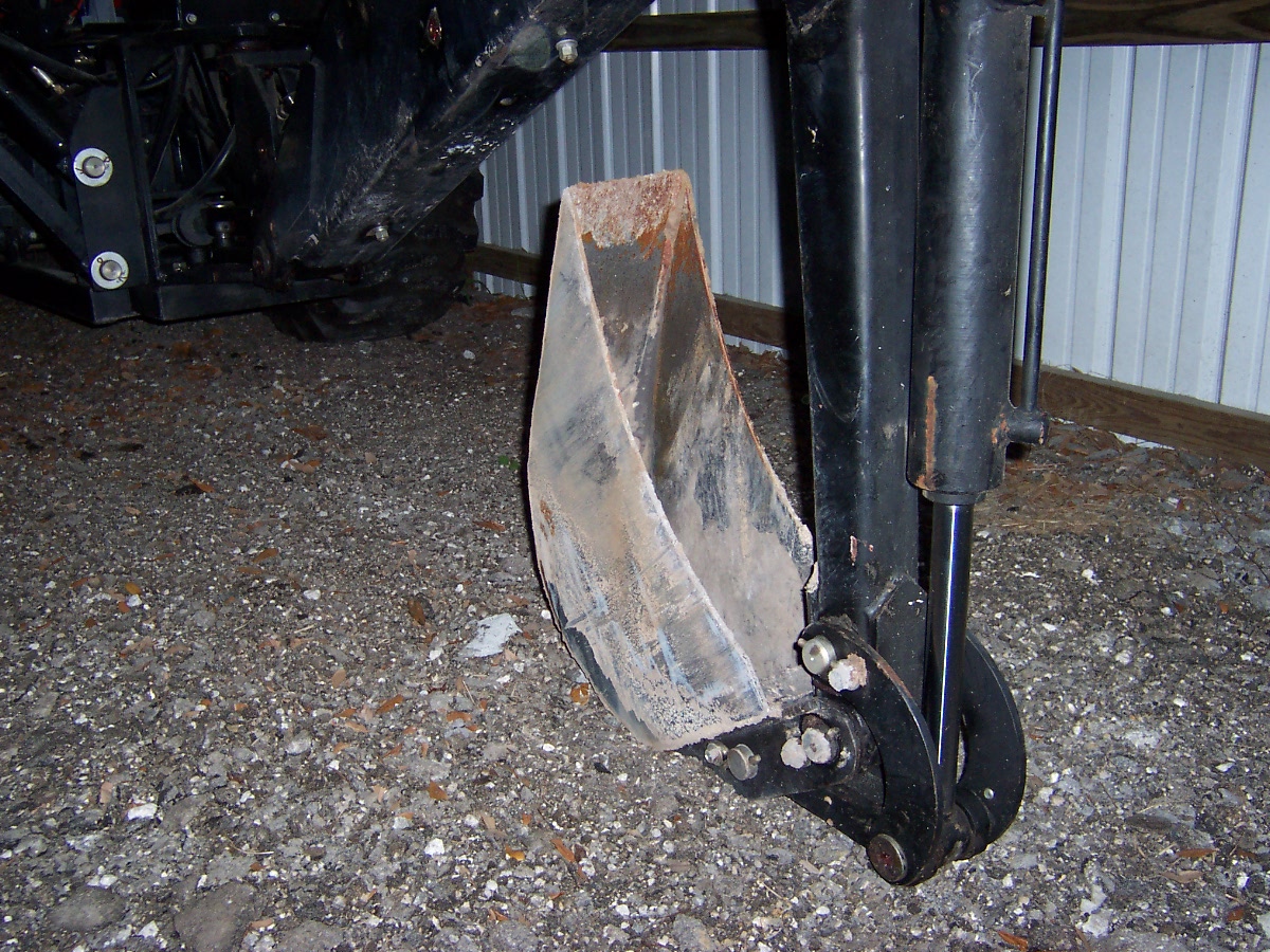

   / Loader bucket plan #6
Find a bucket you like and make a cardboard template of the side plates.
I made the bucket in the pic for my backhoe. I had a 12" bucket and needed a 6" so I made a template and it works great.
