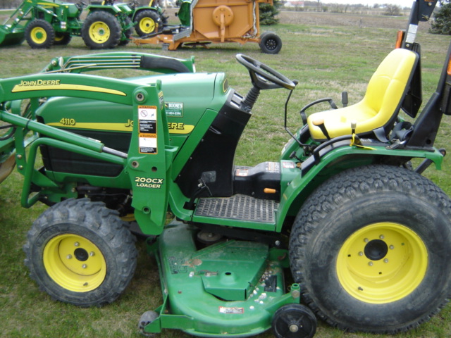

does anyone know what brackets if any that i can use to mount the 200X loader to my JD 4110 i cannot find the 410 loader for my machine

very different mounting between what the 410 used (*** square shaft mount) vs the 200 series that uses a vertical mounted pin and latch system. You could probably fabricate the tractor side of the 200cx mounts to fit your machine. But if looking for a bolt on loader you are probably better served looking at some of the aftermarket loaders. I could be wrong but I don't this Deere has a loader option any longer for this tractor. Good luck

I know for a fact that the 200 series loaders can mount to the 4110 as I almost purchased this tractor back in 2009 with a 200CX loader on it.
The brackets appeared to be the brackets that came with the loader. I don't know if any modifications need to be made on the tractor to accept these brackets. A good member to ask would be Kennyd as he is very knowledgeable about the 4110's. Good luck! :thumbsup:

Yup, the brackets are available from JD, I responded to your PM.

Thanks for the contact Kennyd had the info..

Just put the 200cx loader on my JD 4110, if you can find a dealer that still has the bundle package it will save you $$$$. It is BW15398 but is near impossible to find. Go to jdparts and look up 200cx it will give you all the parts needed it is several. The actual frame is AW34065 and AW34064 that fit our tractor. Good luck I love my tractor and new loader.
