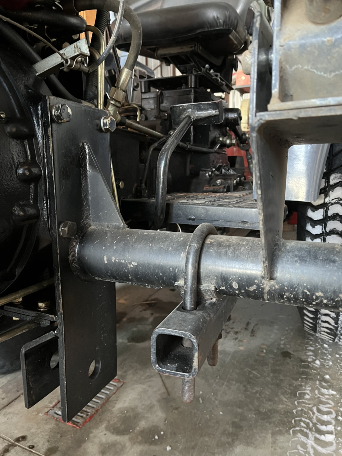

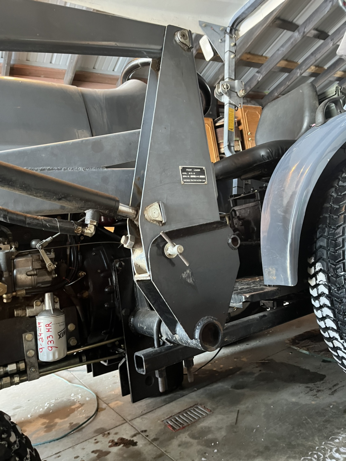

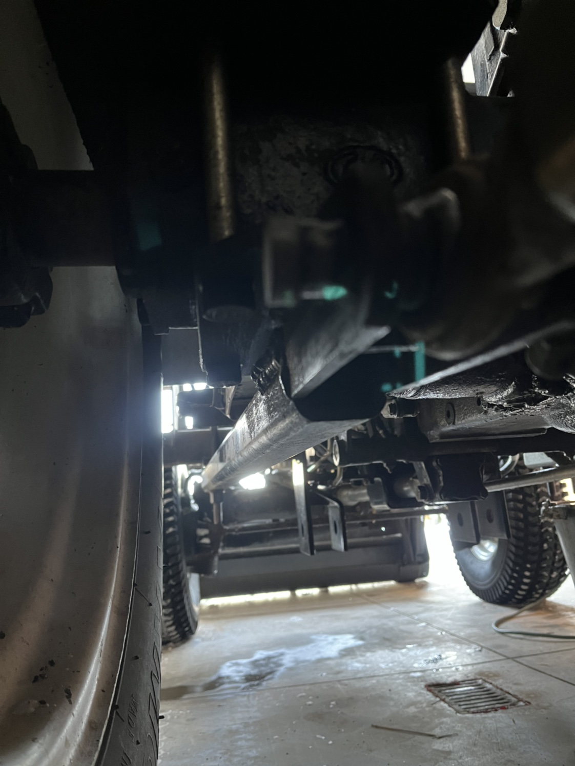

How many of you have tied the bell housing loader bracket to the rear axle? The first year I had my Jinma I learned on CTOA that some were breaking the bells and breaking the tractor in half. Some speculated that it was abuse/backhoe etc. but I didn't take any chances and modded mine. Welded a 2x2 3/8 wall square tube to the rear fender mount, under the rear axle which clamps onto the axle, then had the local truck shop bend me 2 u bolts (for rear axle springs) and clamped the loader mount to the tube. Now any pushing stress is transferred to the rear axle and not on the bell. Just an FYI.

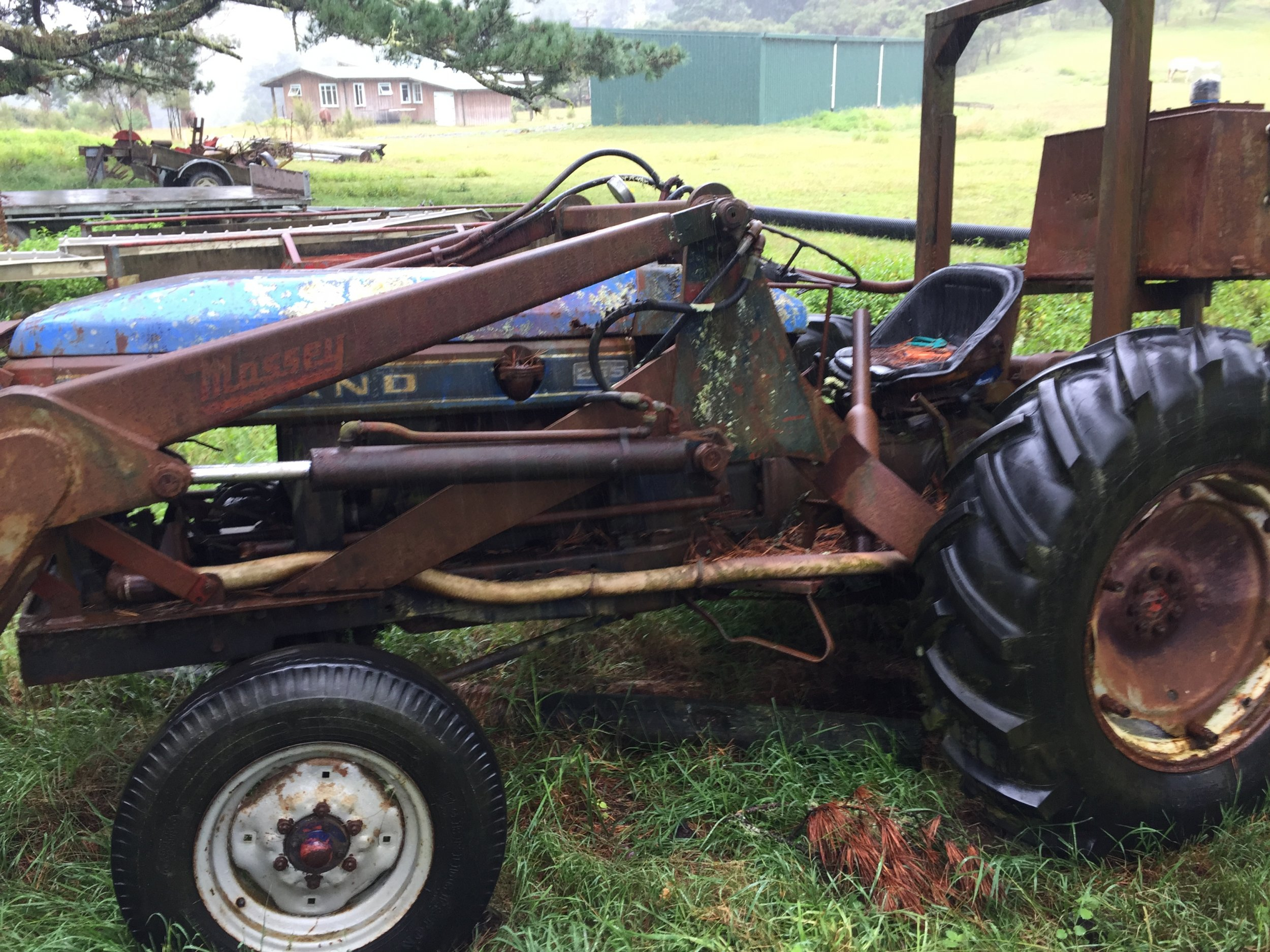

picture of an old parts tractor I have out back where the guy who set it up obviously was concerned out breaking the tractor in half its a bit far gone to save but definitely set up to take punishment

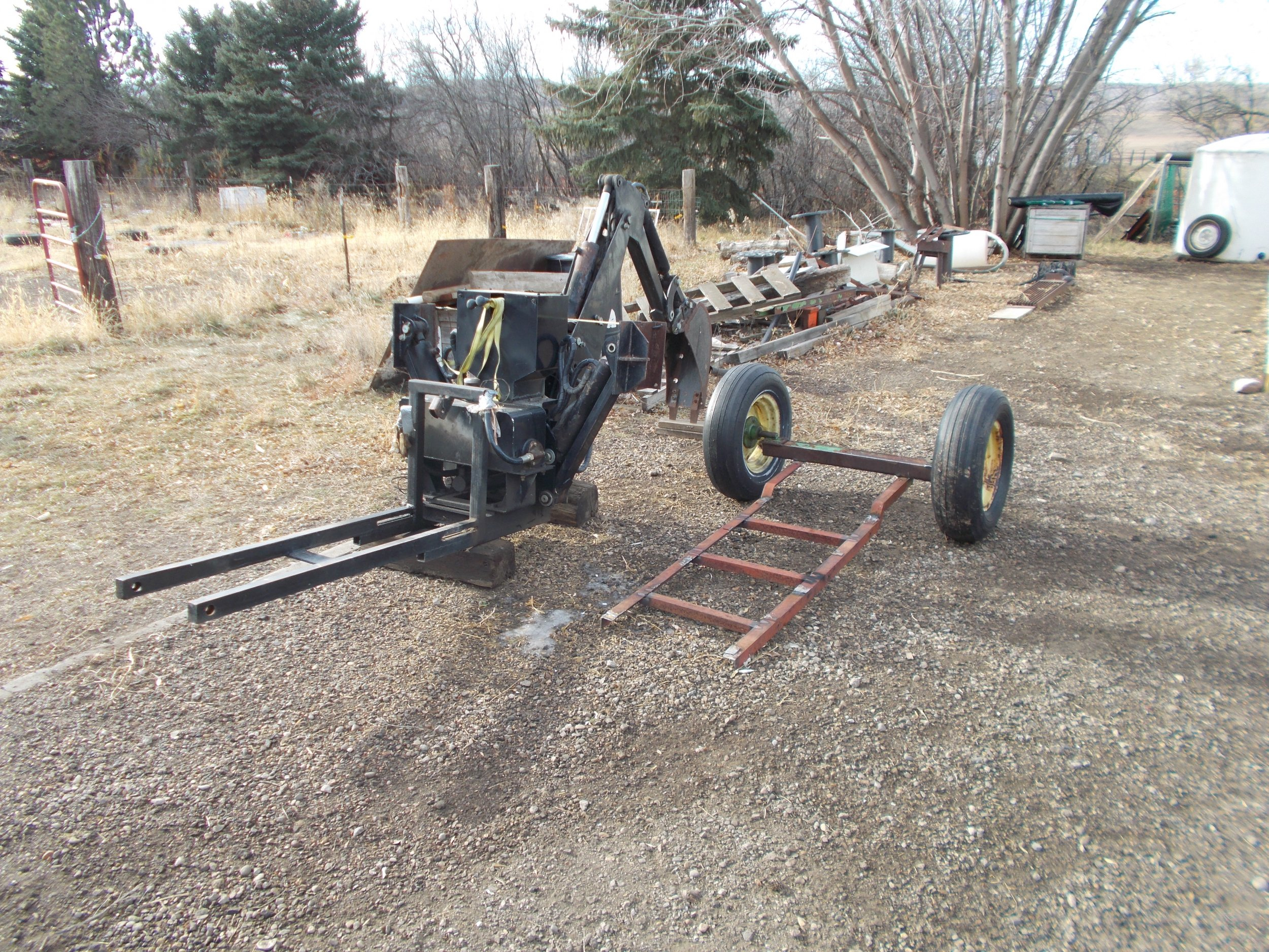

The frame and wheels are the start of a cart to store the backhoe on. It sure makes moving it in and out of storage a lot easier to have wheels under it!
