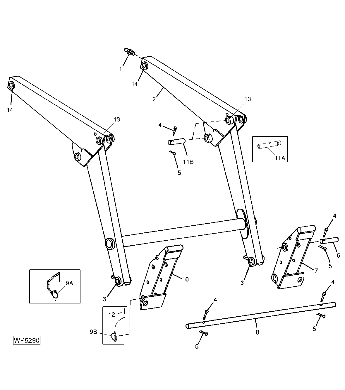

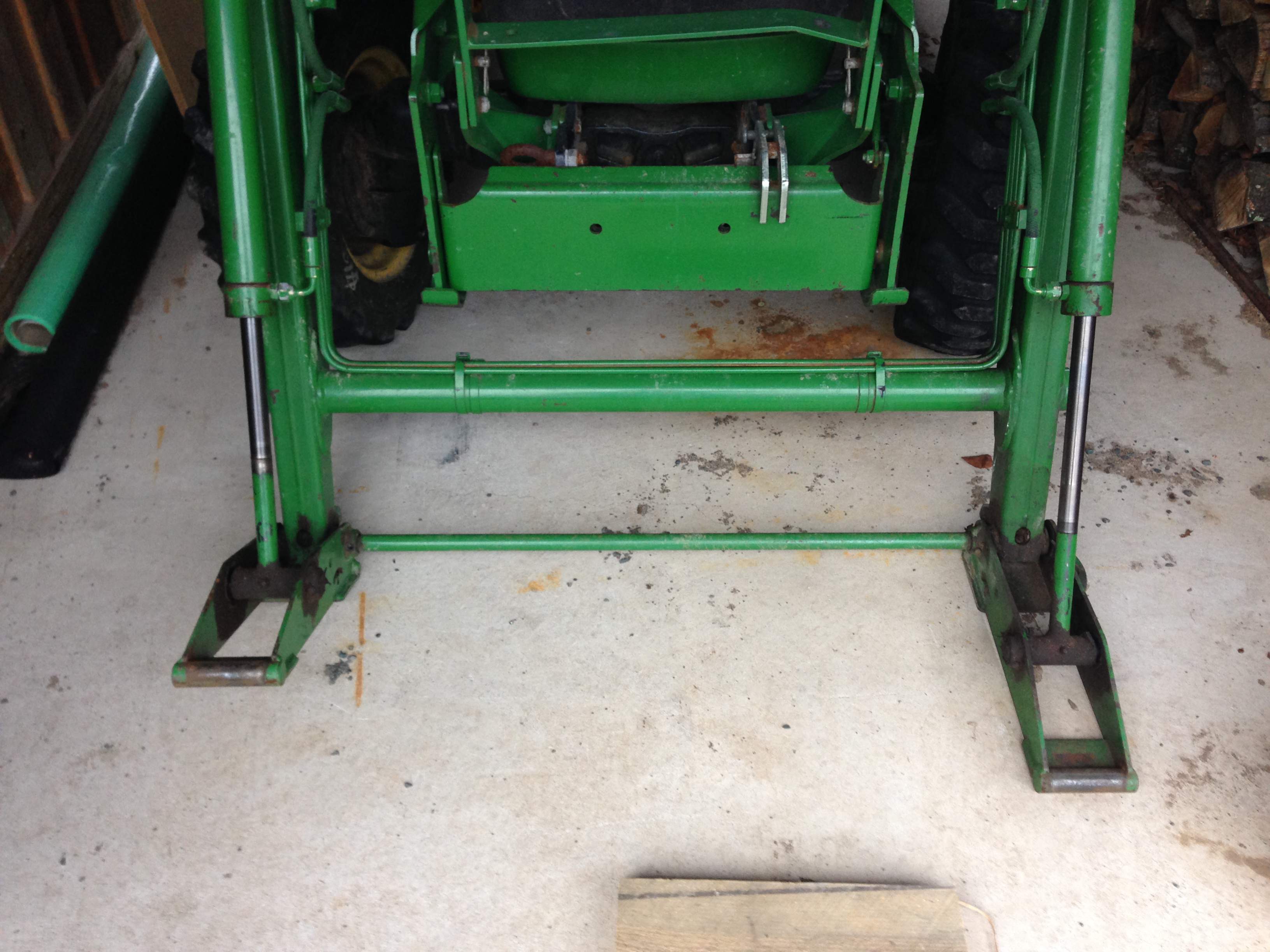

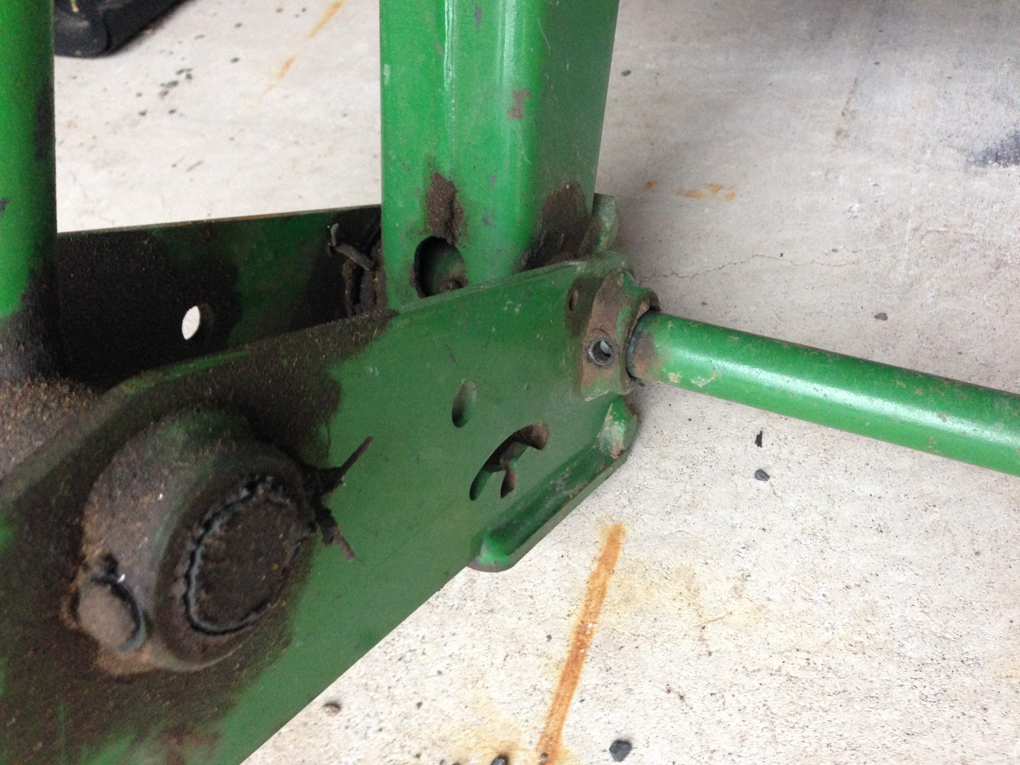

In the middle of swapping the forks for the bucket one of the loader "holders" drooped. Obviously a curl cylinder is shot but I also see that one of the "pin fasteners" is missing. Pin fasteners are the sheer pins that hold the "pin" in place. The pin is a rod that connects the left and right loader arm holders probably to balance the forces and load.
So I got to thinking: Which broke first, the pin fastener or the cylinder? Does it matter? Could I have been operating with a broken curl cylinder for weeks and not known it because the good cylinder has been able to aide the bad cylinder via the pin? Full disclosure: I definitely maxed the loader with an unbalanced load recently.
Attached is a (JD 420) loader diagram (8 is the pin) and a couple shots of the loader including a closeup of the missing pin fastener.

Are you sure the cylinder is shot? Without something tieing them together they will extend at different rates, the one with least resistance will extend faster.

There is nothing wrong with your cylinders.
The broken pin in the QA cross tube is causing the cylinders to run uneven.
All you need to do is fix the pin. Done..
   / Loader boom pin or cylinder: which broke first #7
DK is right
   / Loader boom pin or cylinder: which broke first #8
Yup, curl until they both bottom out and put a new pin in, done.

I'm not certain the cylinder is shot. There are no leaks, bends, or breaks but one side moves in sync with the SCV and the other is slow to respond. It's as if the tractor had a stroke.
Both cylinders offer similar resistance when I push on them. I can get them lined up with brute force but as soon as I hit the SCV the right one snaps into action and the left one moves in slow motion.
If indeed there's nothing wrong with the cylinder why do the cylinders move at such drastically different rates? And why doesn't that eventually translate into a broken cross rod and racked loader arms?
