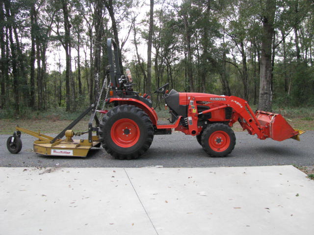

   / Loader and brush hog at same time? #3

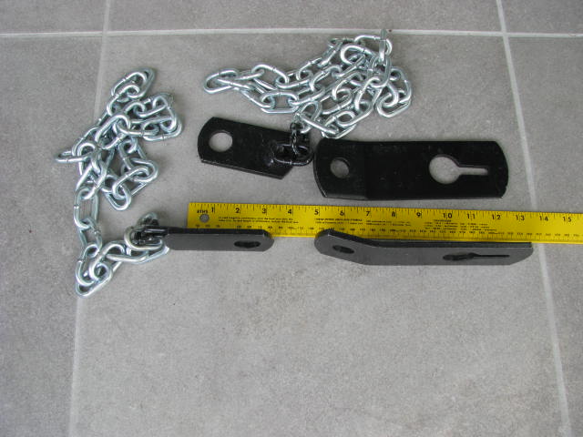

   / Loader and brush hog at same time? #4
Thanks Utopia.
Man that Ratchet Rake would help me out a lot in the N.W woods where I live. Lots of Vine Maple.
