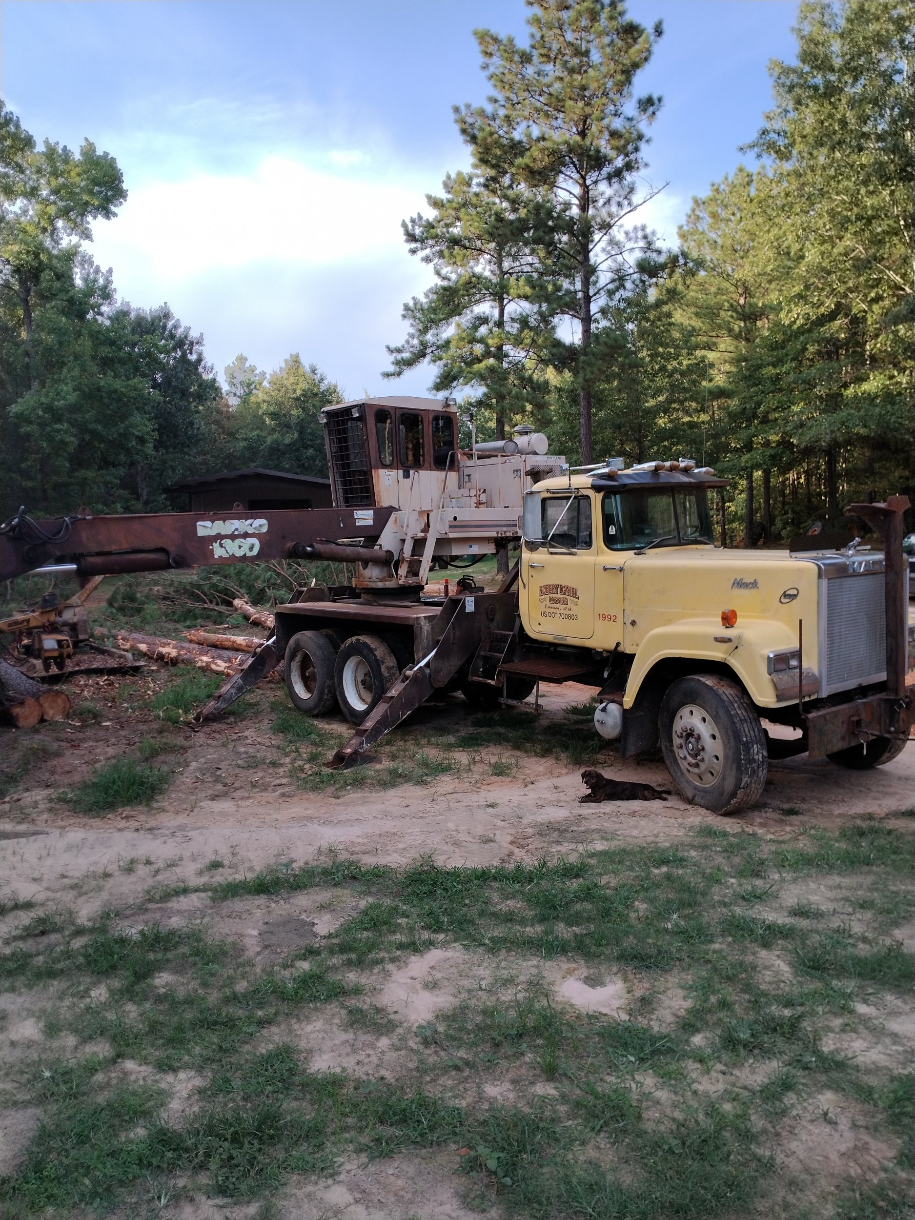

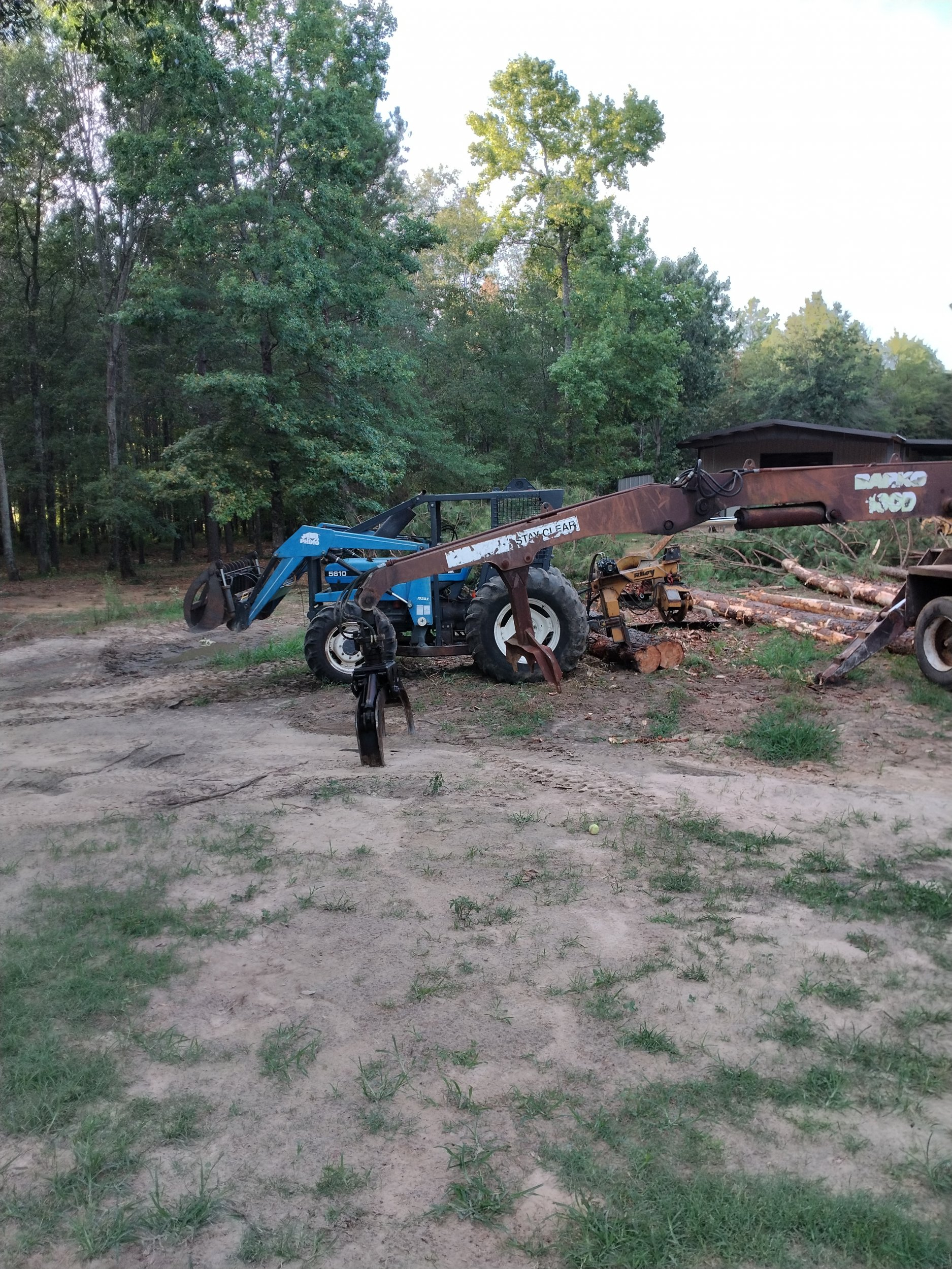

13lbs will roll an R4 off the rim easily we run 30 with a loader
We run 30 in the front. Not in the big tires on rear. My brother saw the 32 on the side of a rear tire. Aired it up to that. Went out in the field in the sun, I thought a bomb exploded. Blowed that tire like a balloon. He said he saw 32 on it, I said seating bead only is what it says. We run 13 in all back tires. We carry two 6x5 round bales on front every time. We use the forks spread wide. Frame for forks is 7' so it spreads wide enough to stick a fork in the top of two bales. And a bale on spear in rear. We need 2,000 bales for each winter. Plus we log, clear land, load dump trucks, whatever.
