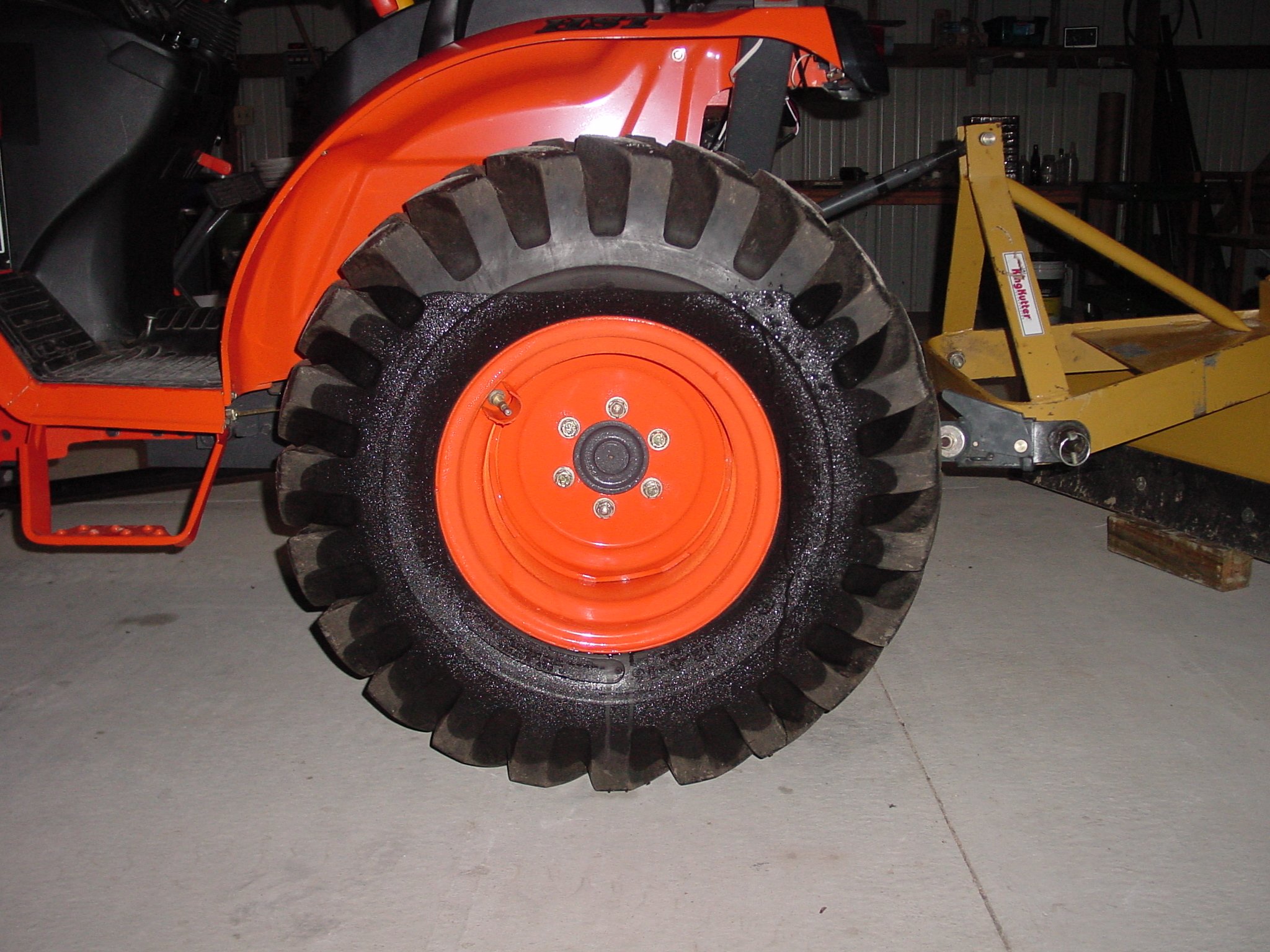

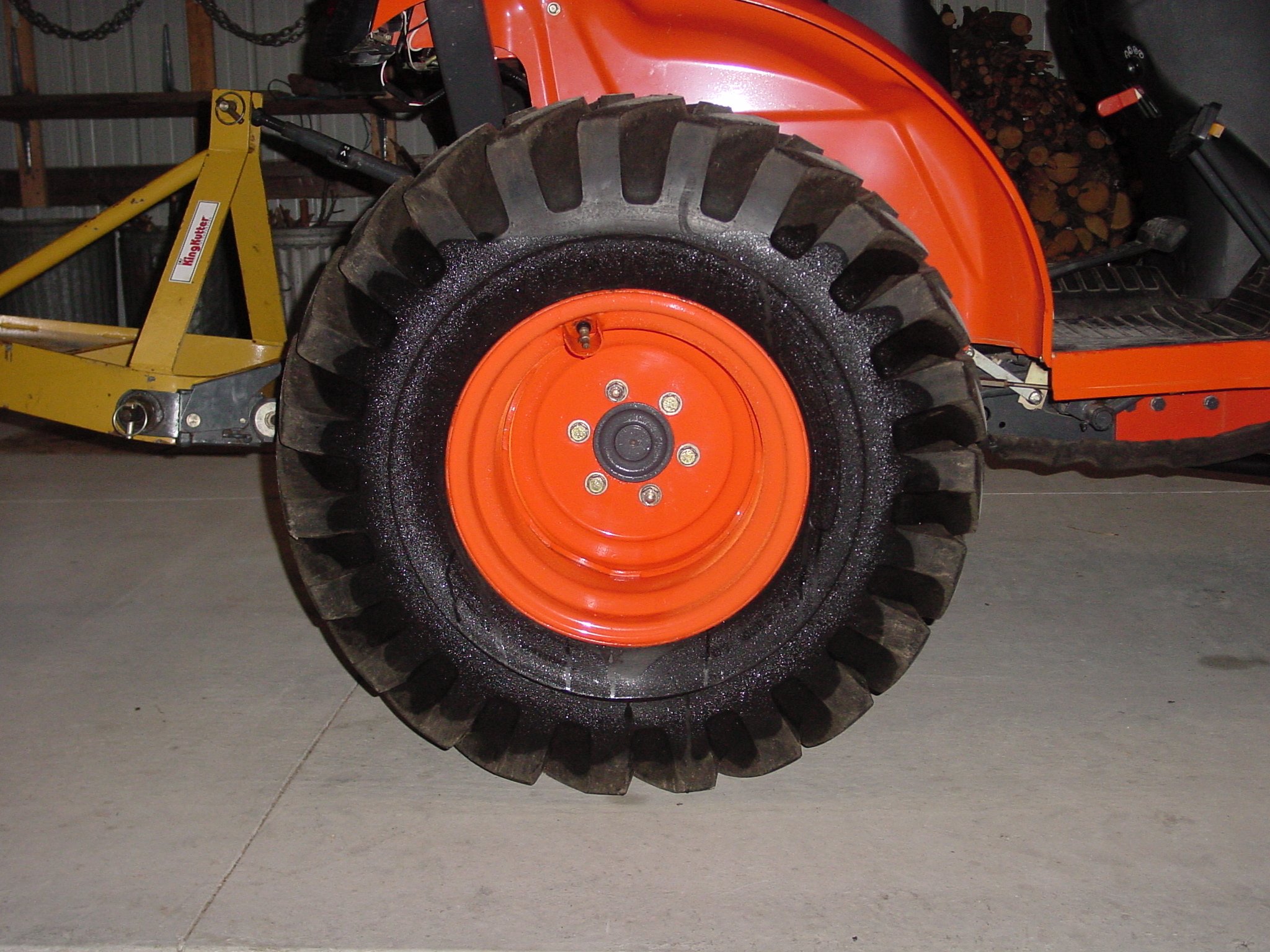

Is it just bad luck or what? 3rd new tractor, 3 different dealers. My new 2720 has one tire loaded 5 in below the top of the rim. The other is just over half full. Very similar situation with the other two tractors. Doesn't seem that difficult to roll the tire to check fluid level.
5" below one rim and the other tire half full? Not sure how you measured this, but 5" below one rim may not be far off from the tire being half full (of course, I don't know what tires you have, or the size).

I never knew for sure how much fluid I had in my tires until I noticed a heavy condensation line the other morning. They are not quite at the same level but are definitely above the tops of the rims. Either I've got too much or I think the dealer owes you some more fluid.
Your tires look right to me.

the same thing happens to me somtimes one is lower some times they are the same i think the condensation varies.
