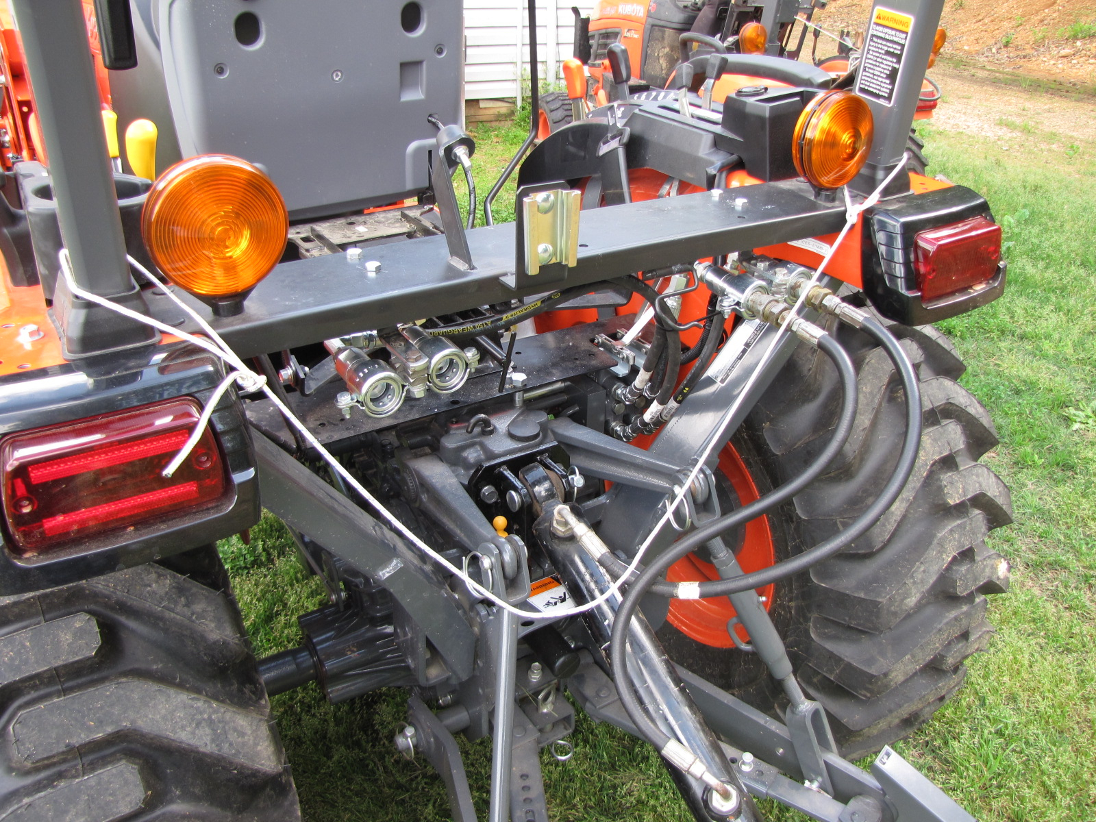

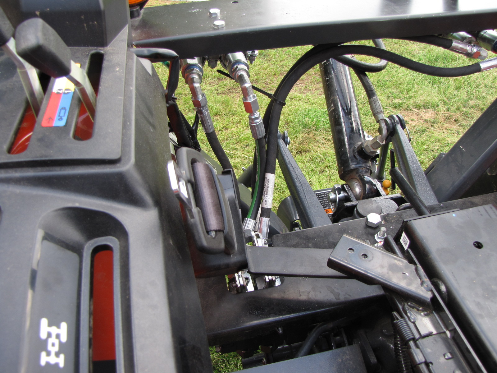

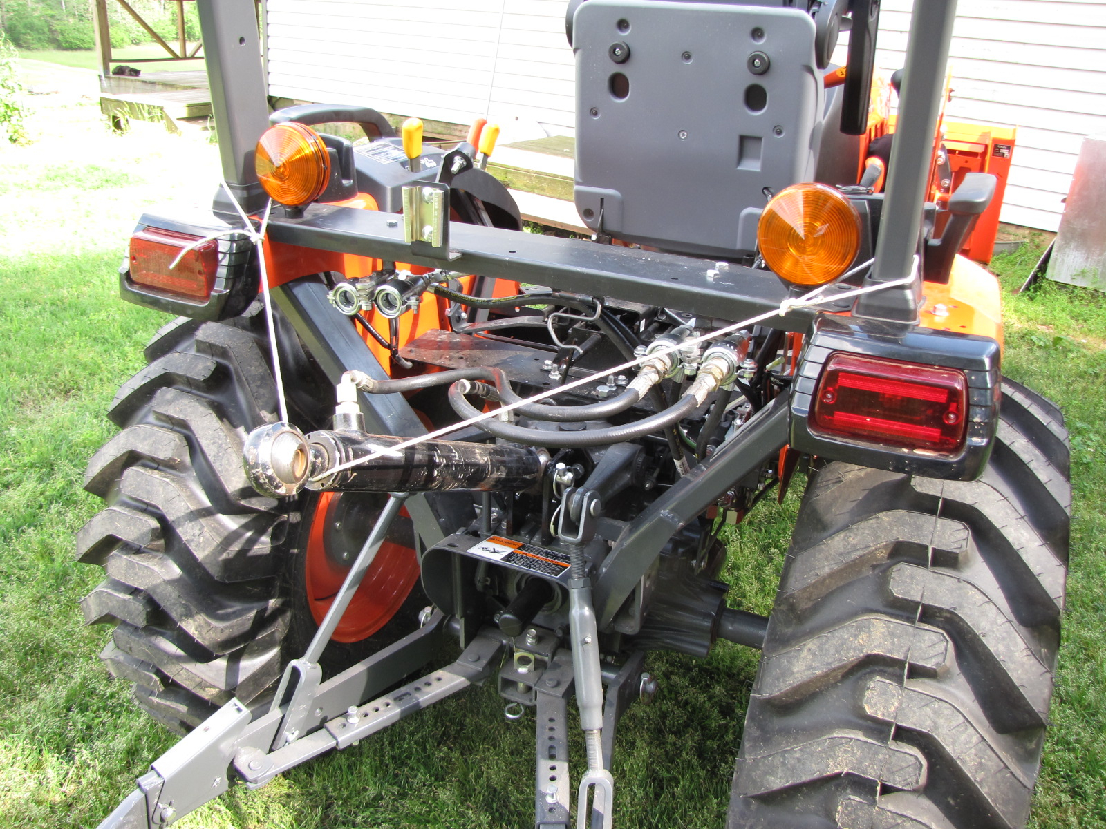

Got a new LX2610 with 2 remotes and the way they are mounted wasn't going to get. I changed and well show you how I did it with a list of parts. All the fitting are from discount hyd.
4 X 9058-06-06 bspp 45 deg
2 X 2501-06-04 90 deg
2 X 2501L-06-04 90 deg
The 4 ag coupler came with the tractor and I mounted them in pioneer brake away mounts. The couplers I have now are only way and I just push on the back side hose and they well hookup. They brake away nice.
On the bspp fitting that came with it were NPT and I changed to JIC.
I wanted to use ready made hose so I ordered the hose from surplus center.
2 X 921-2212 1/4" hose with 6 JIC ends
2 X 921-2224 1/4" hose with 6 JIC ends.
Now here is the real kicker, one of the 12" was a little to long needed a 10". So went to NAPA and got one @ a cost $29.56 and the 12" I got were $7.50 from SC.
