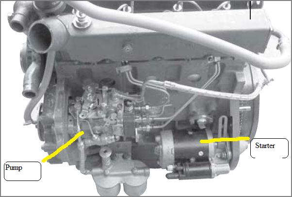

I had the exact same problem with my brand new 7060.
Long story short, the dealer came down, and advanced the timing on the injector pump. What this amounted to was loosening three bolts on the injector pump housing, rotating the pump appoximately 1/4" clockwise on the mount, and tightening everything back up. Overall, it didn't take any more than about 15 minutes to fix. The service was performed at the 70 hour mark, and immediately corrected the symptoms. The machine now has ~110 hours and has had no repeat symptoms.
As the mechanic explained...the engines are timed in India before they are shipped to the U.S. However, the cetane measurements of the Indian diesel fuel are higher than those in the U.S. diesel. And so, sometimes the timing needs to be adjusted.
As others indicated, your machine should be under warranty. Hope this helps.

Im with Farmerboy on this based on your stated timing of the problems occurrence. I am extrapolating from the warmup injection advance system on the 7520 to, perhaps, one like it on your tractor. ... The timing of the injection pump is advanced electrically for about 20 minutes on startup, then falls back to the actual mechanical timing of the pump. I believe what you are seeing is a pump that was set up retarded and gives your engine some problems when the electric advance times out. I am surprised it happens in warm weather -- the 7520 gave a similar symptom only in the cool. A rather small turn of the pump toward advance cured it. I only moved mine a degree or so. Perhaps yours needs a little more.
...I think timing advances momentarily after each start, so try a quick cutoff and restart when it happens. If the problem vanishes for a bit it fits the surmise.:confused3:

Thankyou all for the info
I just came in from advancing the timing but have a reunion to attend today:mur: so I dont have the time to warm it up and use it.
I only changed it by about 1/32 of an inch so it may not be enough but I can always go more, I just dont want to advance it too much.
I'll keep ya'll posted on the results as I go.
BTW: ENG18LT have your swivel and patience ready if you have your loader on there still and you are going to mess with your timing b/c that back bolt is a reach and a half:2cents:

While it may be just enuf to stop the effect, it probably is not enuf to be right. I think the warm up advance is more than the equivalent of 1/8". I went about 1/16 and altho the cold stack effect after the warmup timeout went away I think another 1/32 would be right. I notice the tractor has a little less power after the auto advance times out.

Ok I'll probably try it out and advance it a little at a time untill it seems right its probably gonna be a multi-trial deal.

Well just a finalization to this post.
It seems as though adjusting the timing has done the trick.
I have not had any issues since and everything seems fine.
Thanks to all whom have read and contributed to this post and hopefully it may help a few others out there.
