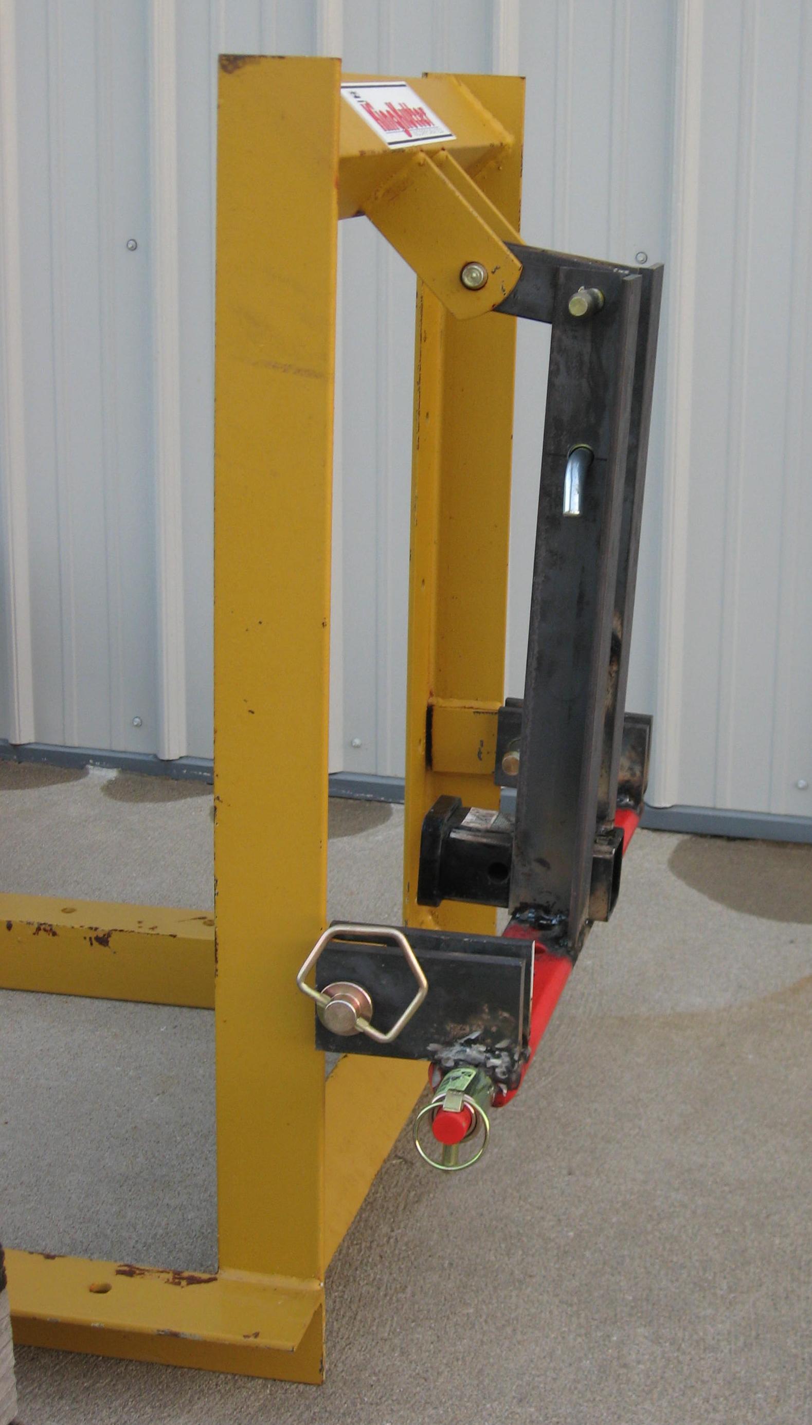

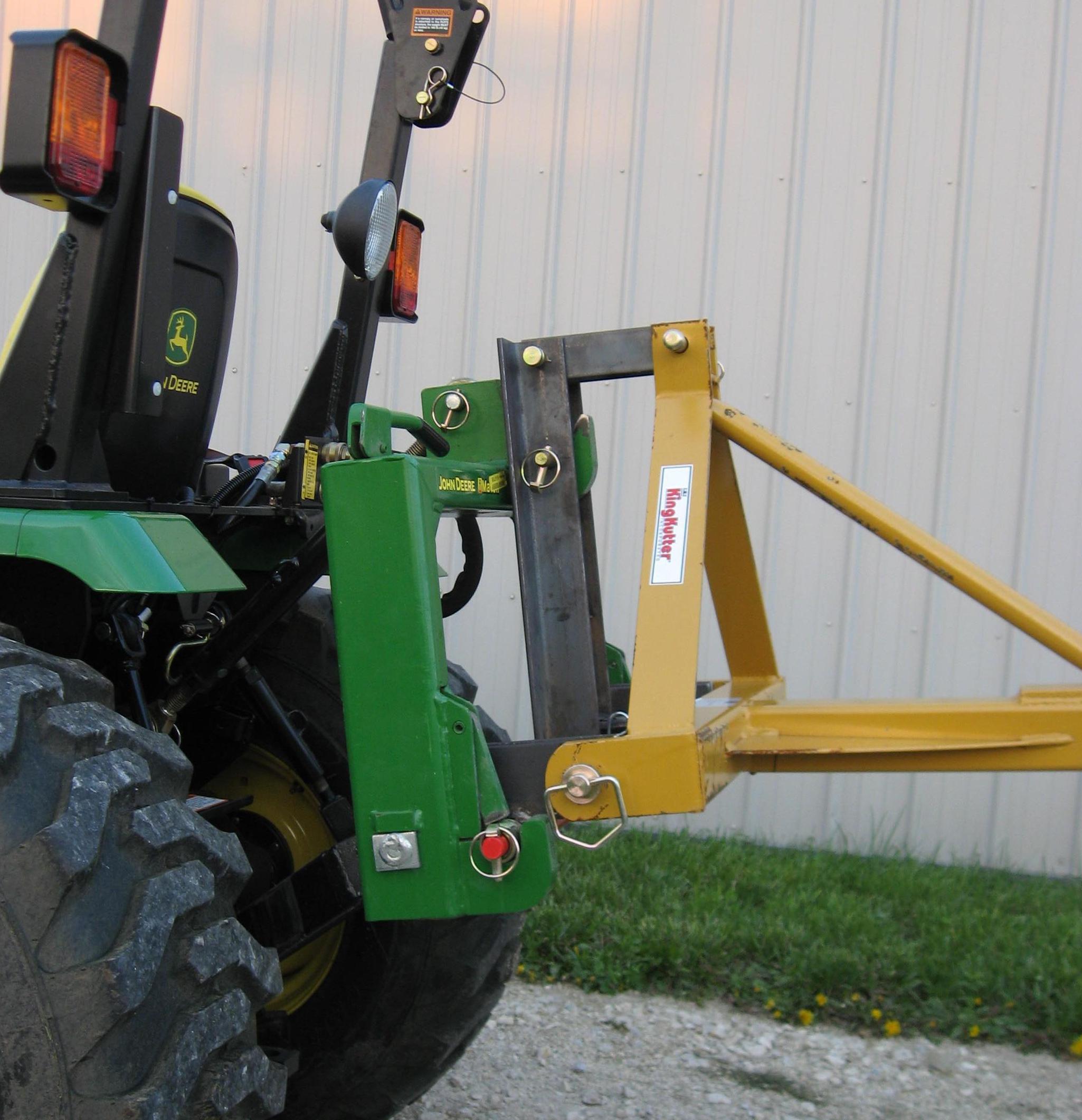

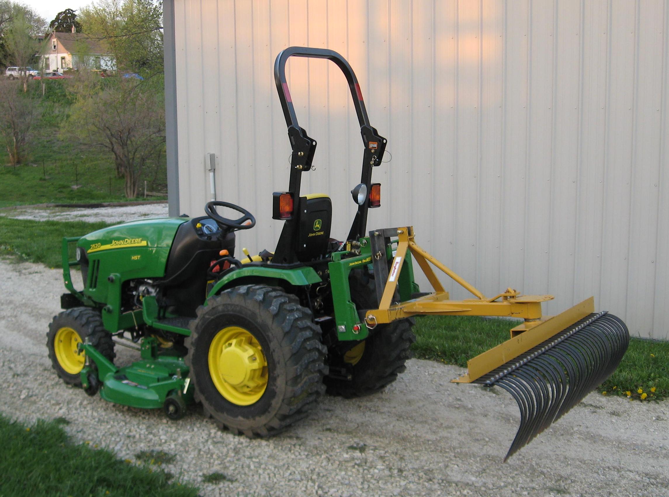

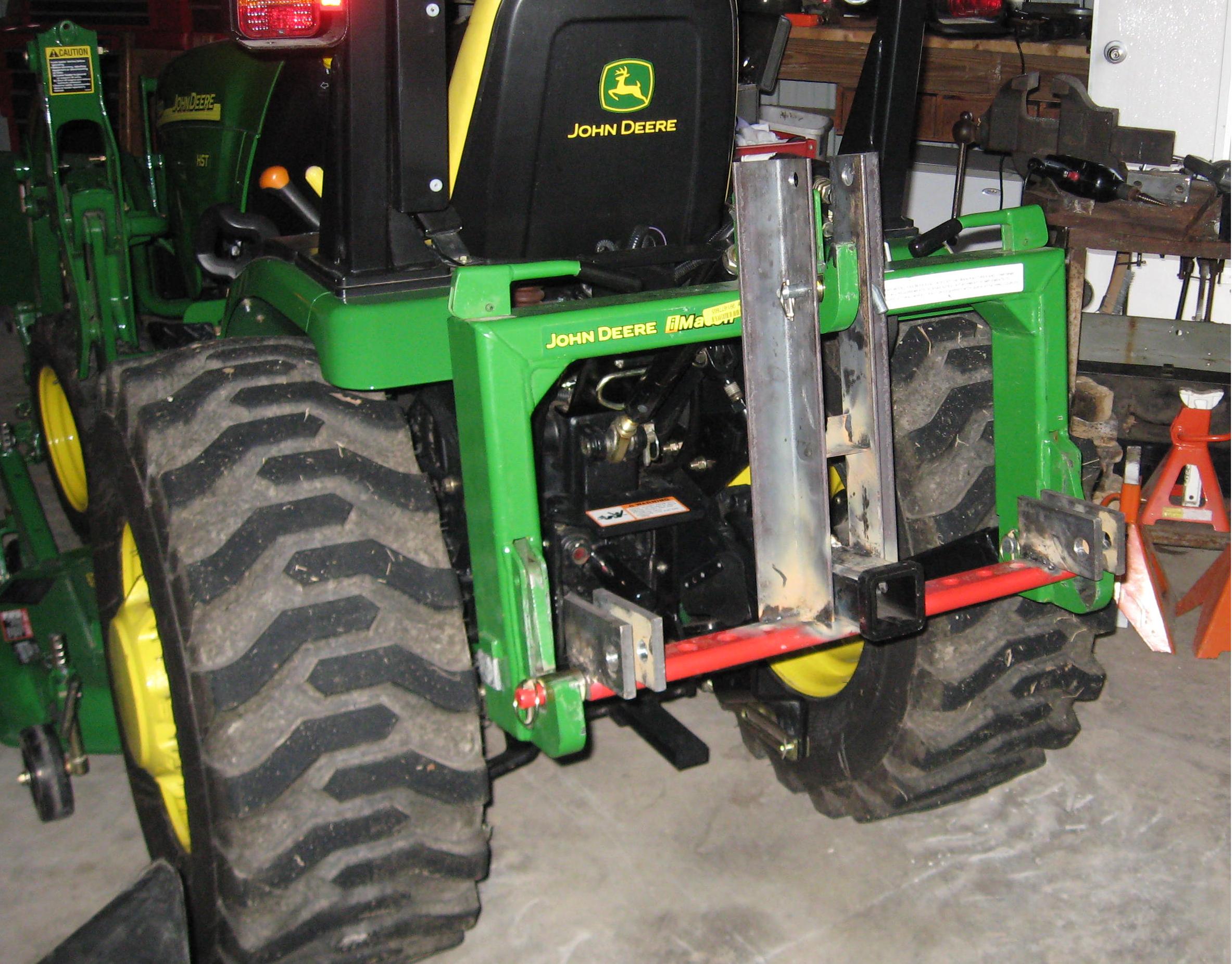

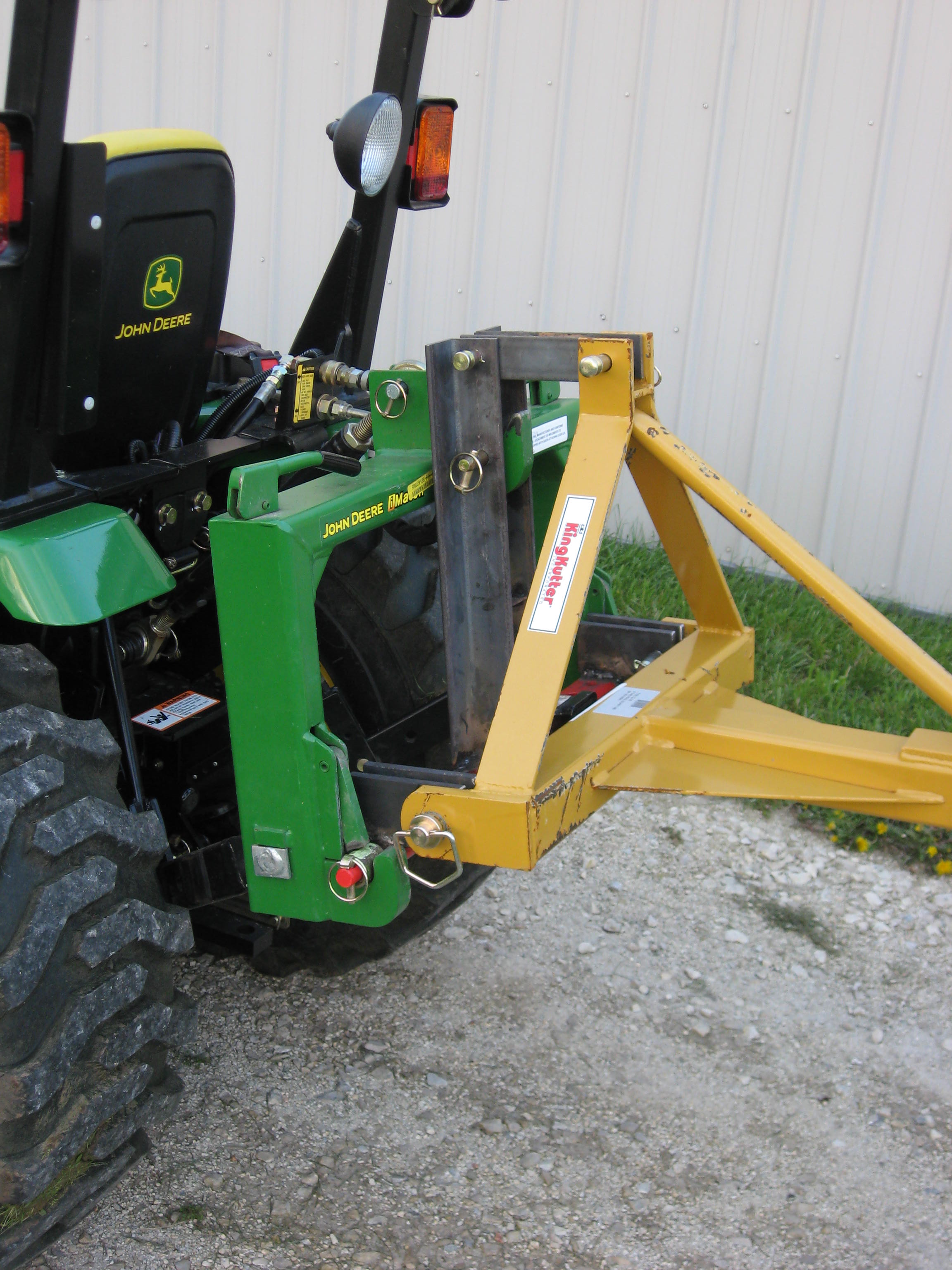

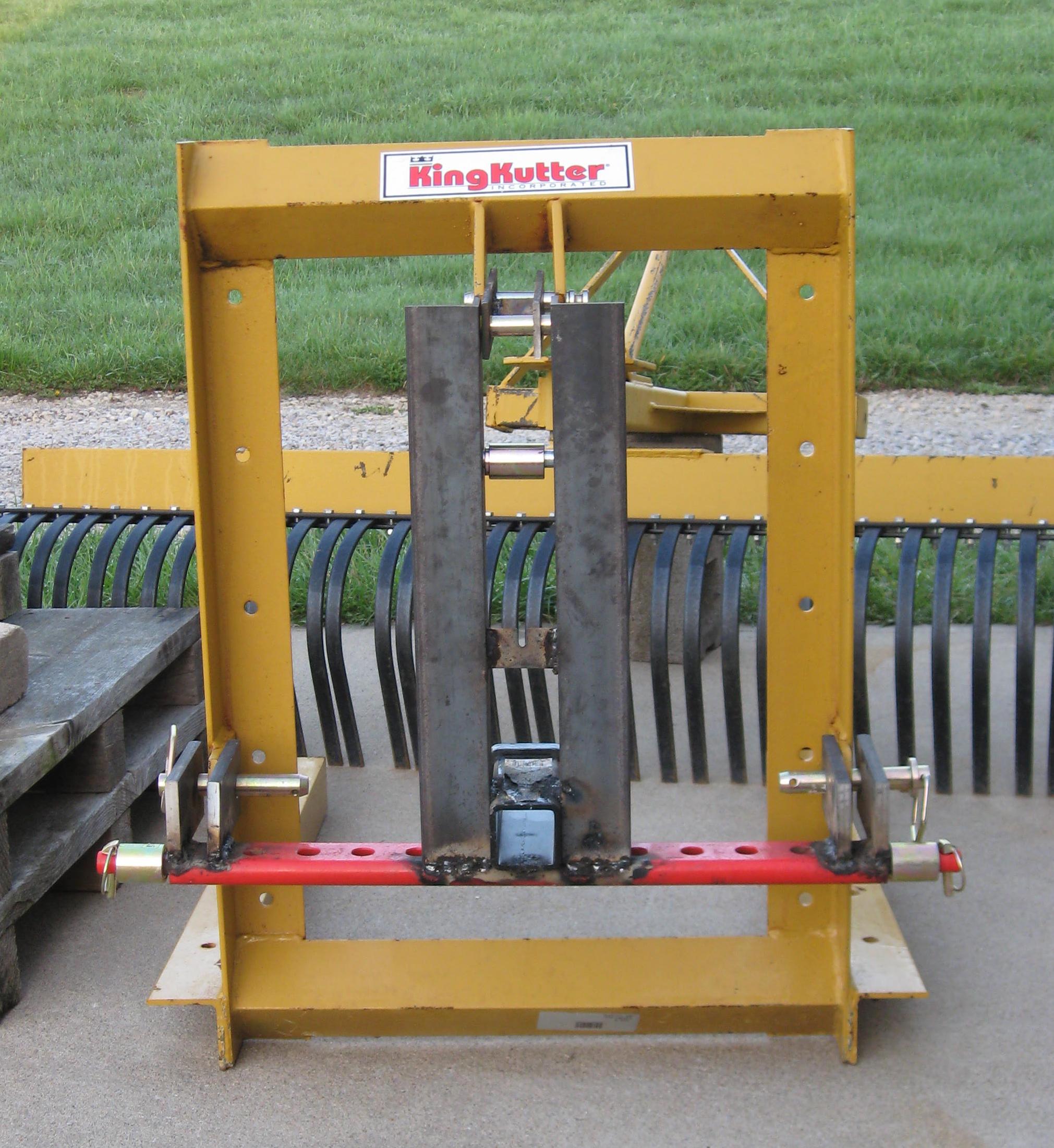

Runner said:
Maybe you have a different model than mine, but neither my KK 6 foot rake, nor my KK carryall worked with the iMatch. I had to make an adapter.
I called King Kutter about this issue after purchasing a rake (and returning it to TSC). They said their "Professional" line is ASAE Cat 1 Quick Hitch compatible. Looking at the Professional Rake it sure looks alot like the Woods/Frontier model so I believe them.
I can't however find any of their other products that are labeled as "Professional".
