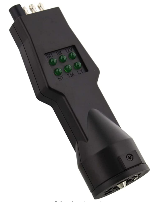

One of the best trailer tools I bought was a checker for the truck plugs, $12.89 on Amazon. It's Works for 7 and 4 pin sockets. Also my 2017 GMC
HD has a separate fuse for each trailer function.

Newer model trucks generally have separate fuses that operate trailer lights than the circuits that run truck lights. Also, trailer grounds are major problems. I also use a plug in analyzing tool when working on trailers. Major time saver.

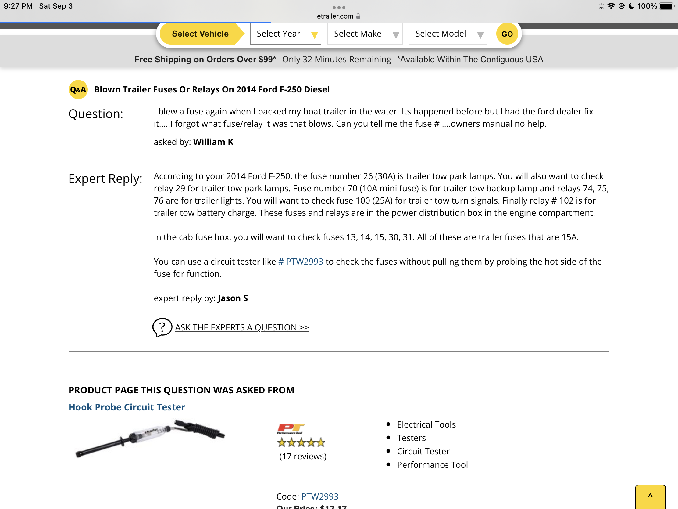

Should be a separate fuse panel for your towing circuits under the hood. Check fuses for rh stop/turn, and lh stop/turn first. Exact location and numbers of fuse cavity in owner's manual. That's where I would start

For those looking for a 7-way tester that includes trailer brake controller testing, this is the one I use. It is amazing how many friends I've made with this device at campgrounds.

His title is a little misleading compared to his description of the concern. He has running lights but no stop or turn lights with truck hooked to two different trailers. The lights don't come or go, they just don't work at all for stop and turn. My money is blown fuses for rh and lh turn trailer feed which are combined to make trailer brake circuit.
